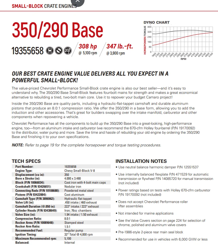

So, in the week I've had it I've noticed I am way down on power on the top end. I'm pretty sure I have 4.88 gearing, it was swapped by my father in law, but I feel I should be able to maintain speed on a hill at 45-50 MPH. There is no timing indicator on the engine atm. I marked where the shop had it and ran it up down the road listening for pinging and backfiring. In the end I ended up pretty much back where the shop set it. Moving on from there I set the plugs to .040, I'm running an HEI, and replaced them and the plug wires. I'm up at 7500ft and at idle I'm pulling 10-11in Hg. Advancing the timing I can get about a in or so but the I backfire on decel on the hills. The carb is an Edelbrock 1405, currently running 0.098" Main with a 1457 metering rod and 0.089" secondary. The plugs read tan, I swapped the jets because it was really struggling with the 0.095" / 1451 rod Main and 0.100" secondary. I'm going to buy an o2 sensor since I have the port from the removed Fi system to try and dial in my A/F ratios. It picked up some power but I stil feel like its lacking. Any input would be greatly appreciated. Am I just over thinking things?
