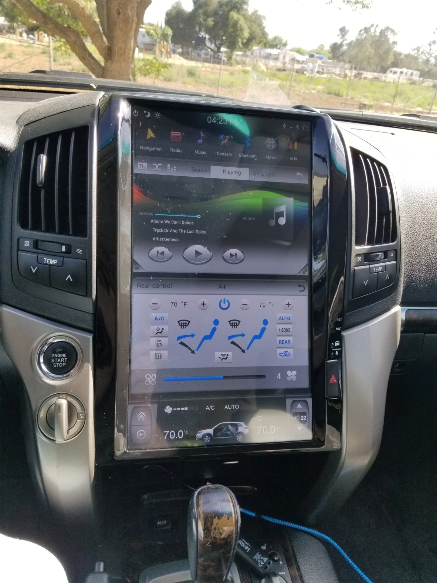

WORKS
all the climate controls work - front and back
the steering wheel controls work
the backup camera works - for early models it adds the lines so improvement, for the later models I see the options to support the 360 camera, so I am assuming that does work as well
the vehicle icon showing doors open works
the radar option on the older models works with the center dash display as it always has, the newer models it works on the screen as it does on the factory units

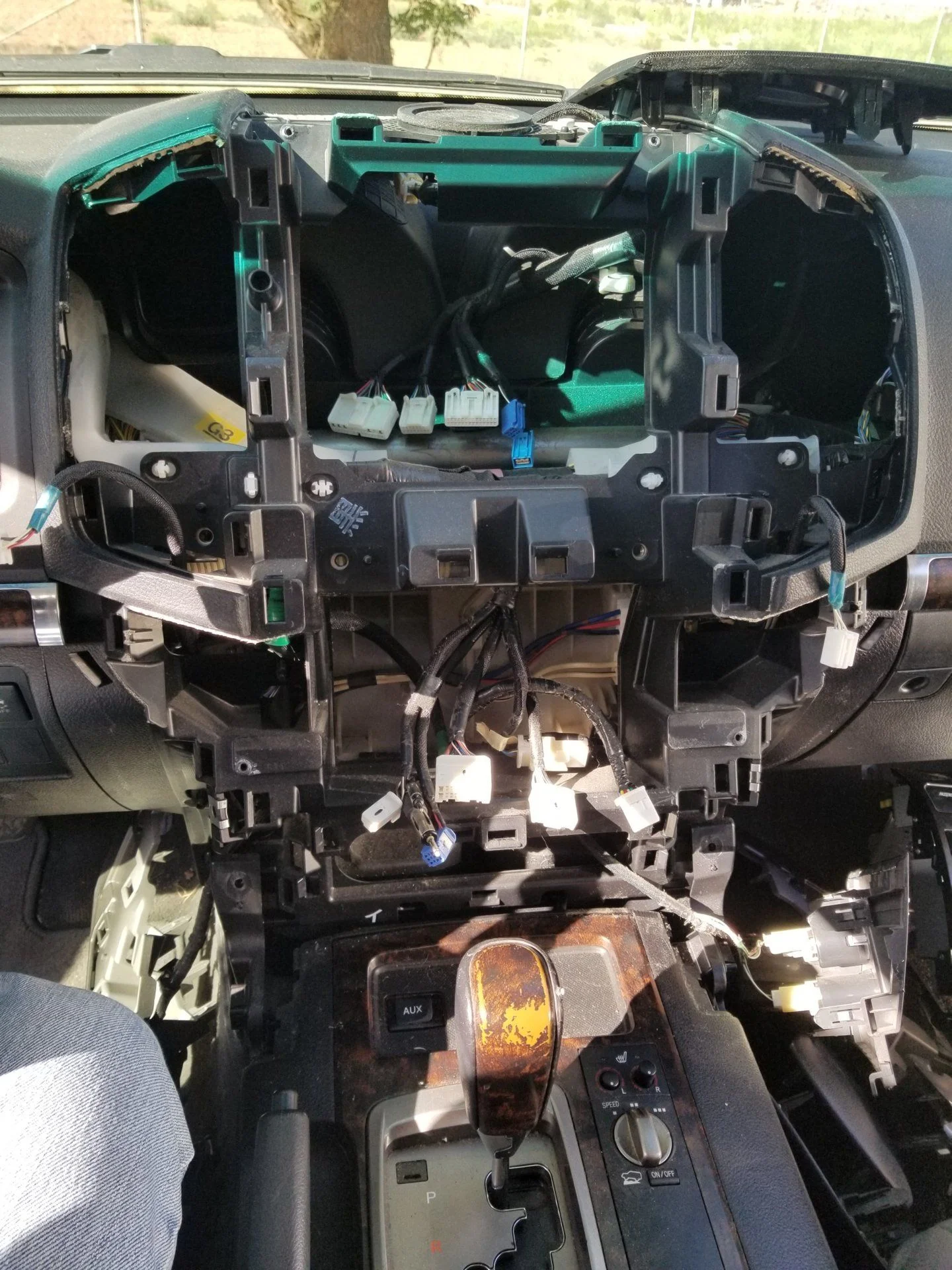

Can Bus - this unit does hook into the can bus (via factory harness - no need to plug into the ODBII port) and has all the information the original unit got form the bus.

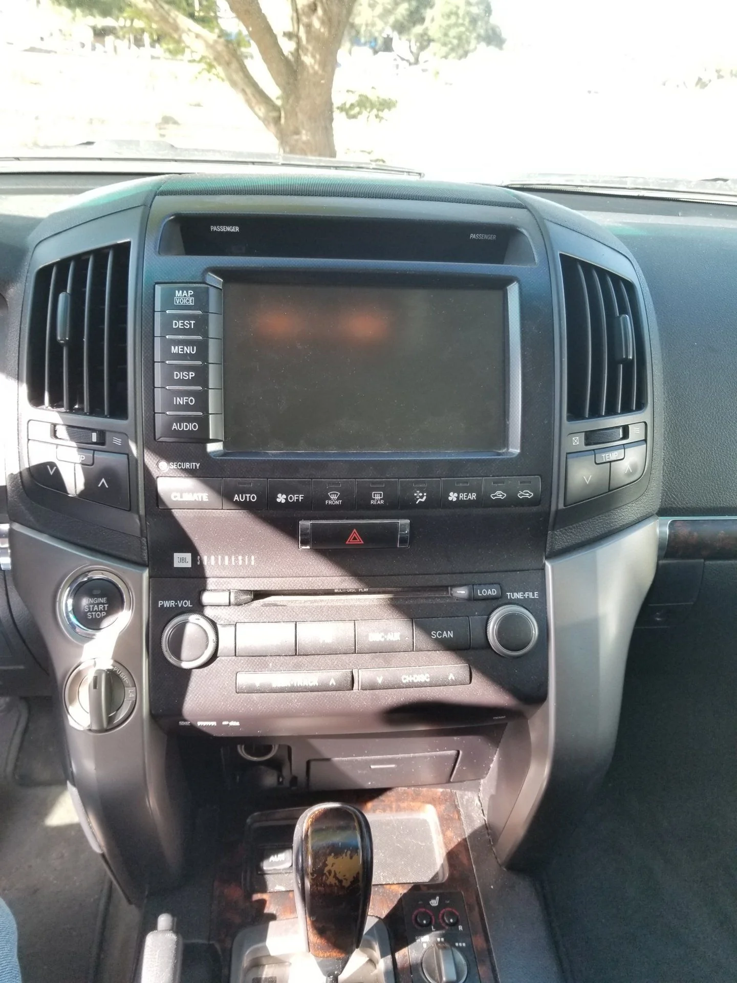

The latest model replaces that small digital display at the very top that showed climate temp, outside temp and the airbag status. That was incorporated into the main screen and a few hard lights on the right side. However I don't see the external temp anymore, and I don't believe there was a connector for the external temp sensor (although in the settings there is one for temp display) so it could be newer models posted on the bus and older model was hard wire not sure but I no longer have ext. temp right now on my 2008.

Hard temp controls under front vents - they are still there and hooked up, however the climate temp controls now work from the main display only
No more factory Nav - not that it worked well to begin with (better options see 2nd category)
No more maintenance tracking - did anyone even use that?
No more external temp - see comment above

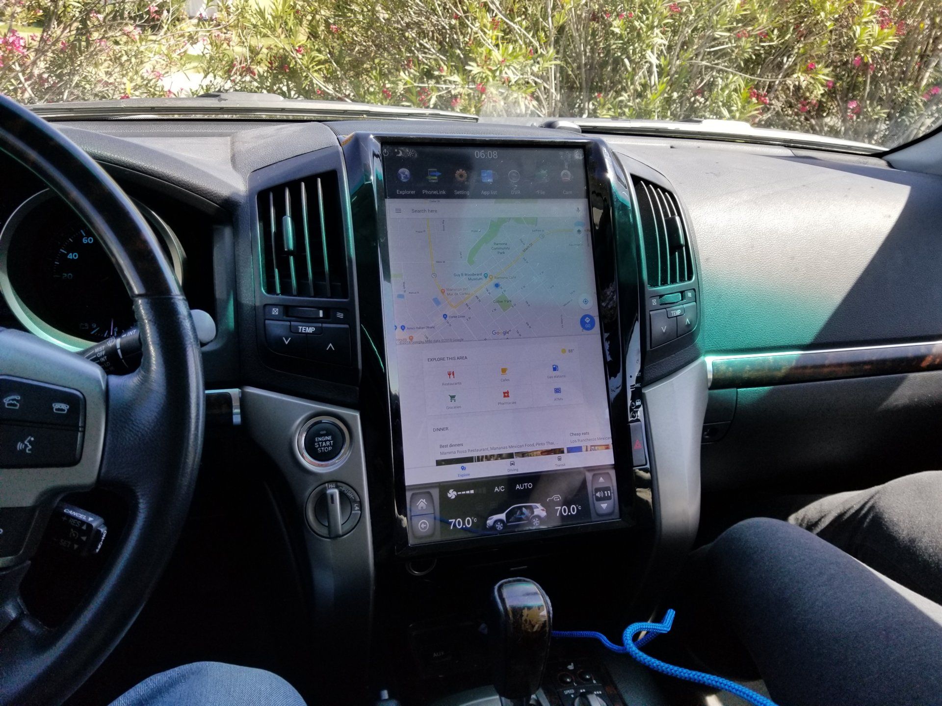

Cool 16" screen. the vertical screen that Tesla introduced is great because it breaks the screen up into quadrants of information or applications. on this one you have a header section - select options hard coded in the software (however it is android so open platform for you to mess with if you know what you are doing) and it has a footer section, this is for your back and home button and also have the information and launching of climate controls. The middle is broken up into 2 equal areas for apps so you can have radio on one and something on the other one, nave so far takes both sections (I am sure I can adjust it, just have not played with it enough) the climate and door alerts are pop ups over whatever else you have in the sections. There are other launch skins and apps you can load Phoenix has a drop box with a bunch of tools and other apps you can get, and also this is android so you can load some of your favorite apps if you like (and the work on that version and build)
This is Android 7.1 btw
you get google maps. Now google works best when it has internet connectivity (get into that later in this post) but you also can download maps and use it in offline mode and early test show it does work but not as good. However finding places and getting routed to them works just fine in offline mode once you have downloaded the maps.
There are also a few other nav map options, I have not played with them yet.
you get a radio app that work just as your regular AM/FM radio does, it has presets and can scan and tune and does support RDL. It does not have XM radio or HD radio
you get a "music" app that will play music from a usb stick or other method of media, that works pretty good.
you get a blue tooth app that is used for your phone connectivity for getting and making calls as well as BT streaming music from your phone. This all works pretty well, head unit has its own mic built in and using the vehicle speakers for the sound of course. people I have called say it works and sound great (of course not quite as good as my telsa) but as good as land cruiser factory BT phone stuff. Has phone book and recent calls, however no voice dialing (yet) still working on the voice activited controls with another android app
It does not have Apple play or Android Auto, it does have a generic version of these but it really does not work as smooth or seamless as those apps work.
you get a few apps to play video, but I don't do much of that so I have not played with it yet. I can tell you that it does conform to the parking brake on to play video.

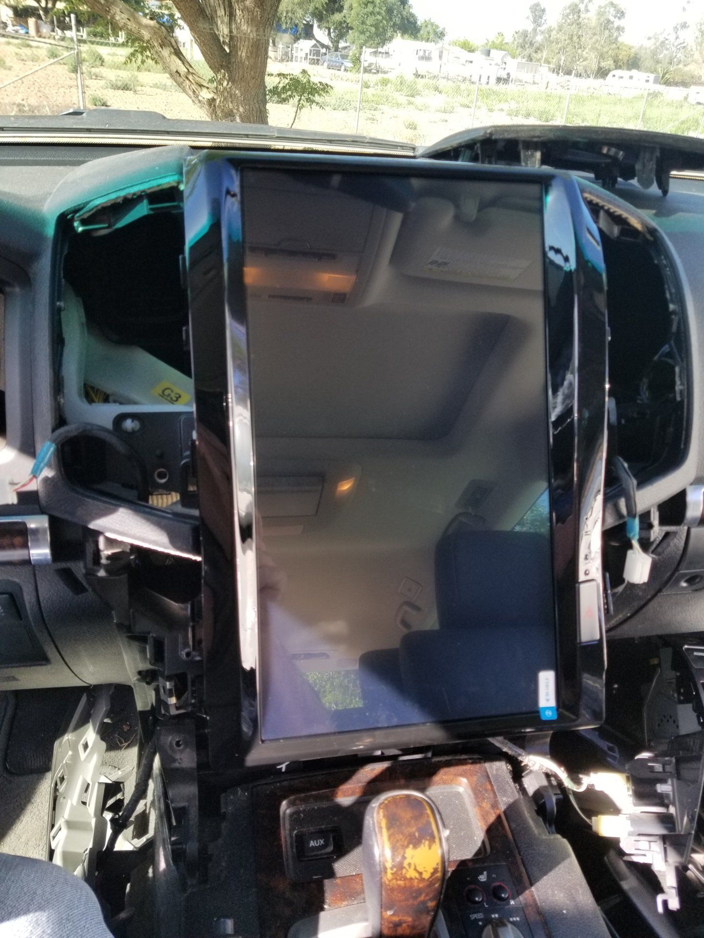

Install
The install is pretty easy, as long as you are good at figuring things out without instructions, if you are one of those that need a thick manual and must study if for hours and then do the job, this is not for you. You will get zero instruction manuals with this unit. However they do have a good knowledge base and support site. It is for the must part plug and play, once you figure out wich hardness to use (they included 3 different ones for me, I imagine it was for the different years) and how to hook up the can bus decoder, video decoder and other "box" that is included. Absolutely no dash modification is required. the fit and finish is very good on this latest unit. only thing that is left up to you is where do you want to route the USB ports (you get 2 of them)

Great, do you happen to have a picture of the back of the display before it was installed?
No, sorry, something in particular you are looking for? I can tell you that the body housing is parallel to screen against it not perpendicular like on the Tundra versions.

are you able to get a side profile of the face trim right above the start button, does the headunit follow the contour of the center stack well?
I have gotten in contact with Phoenix and waiting for them to get back to me. I am wondering if it will display the front camera with the 14 Landcruiser
I will take a shot of the side view it follows the lines pretty good. As far as the front camera it has inputs for 3 cameras, my 2008 only has the one from the factory but I can add 2 more so I believe it gets the mirror and front cameras on the newer models.
