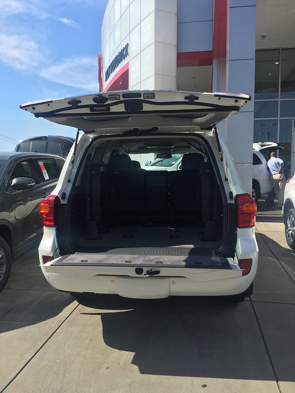

Here is how I got it, and will start posting progress as time allows.
"The day of...."

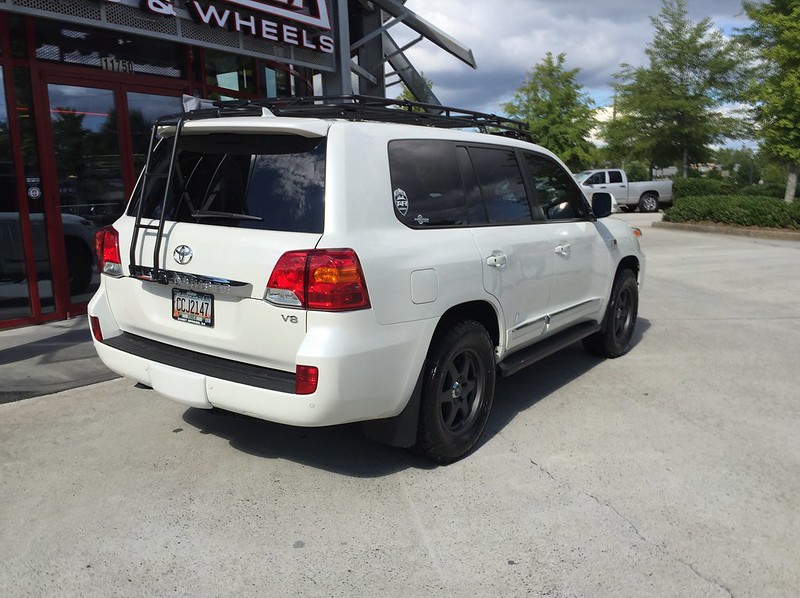

Oh that tailgate (finally)
Had to baptize her the first night I bought it.

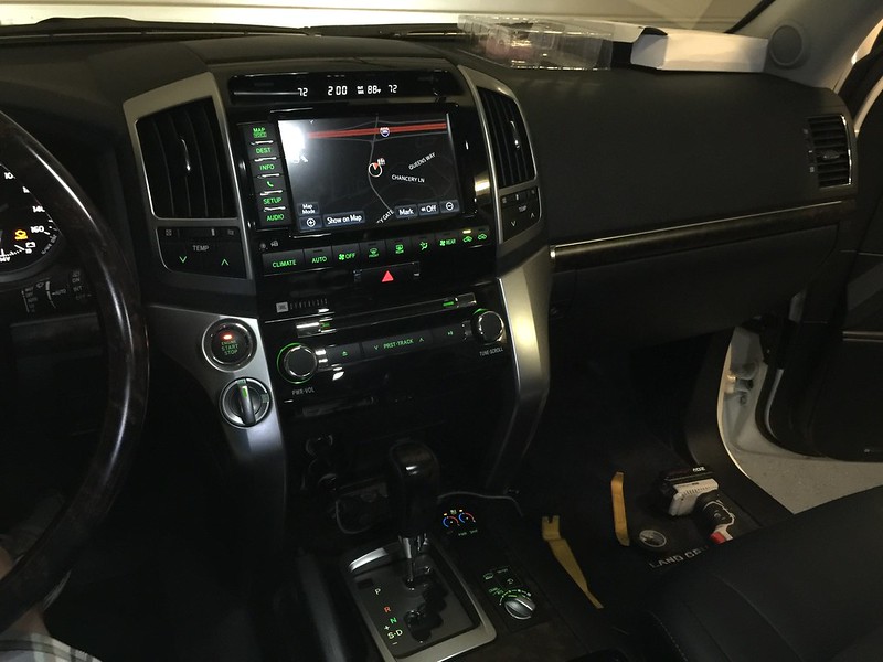

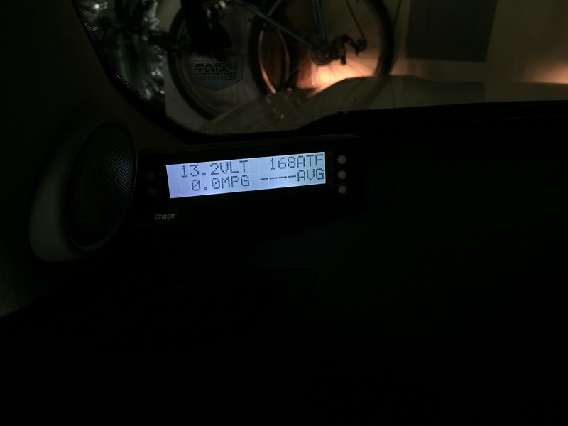

ScanGauge II...
Is it normal for the trans to hit 212f to 220f on these things? I remember as soon as my 4Runner started climbing to those numbers (mostly due to weight and slightly larger tires) I installed an aux trans cooler, temps lived in the 170's after that.

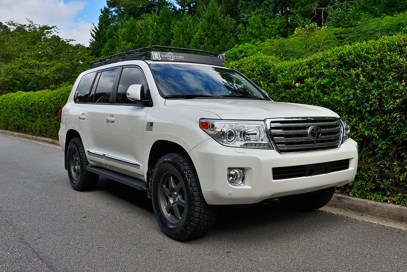

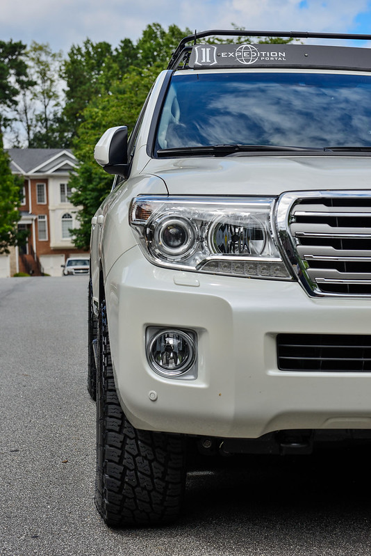

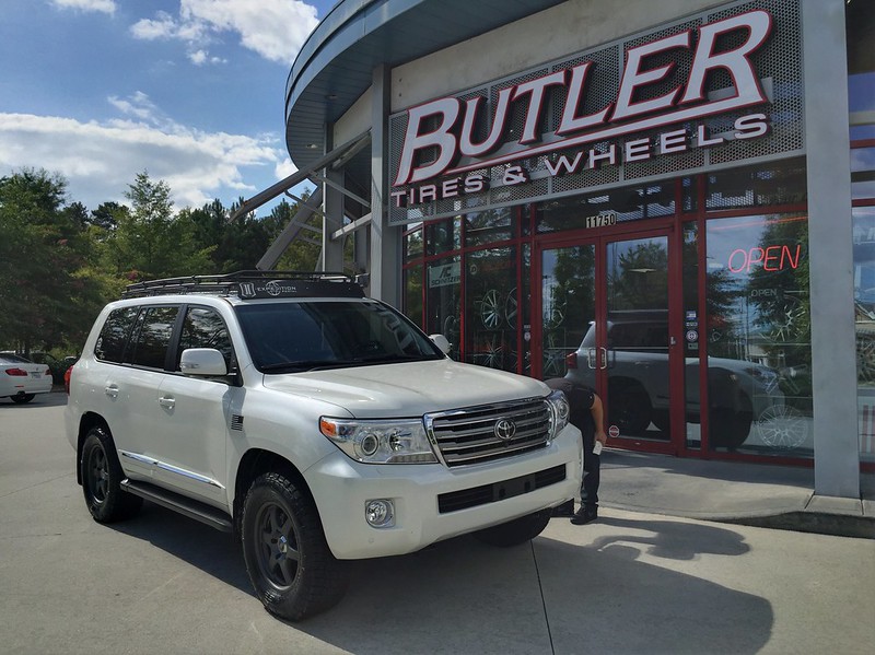

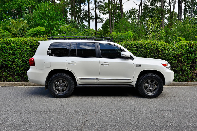

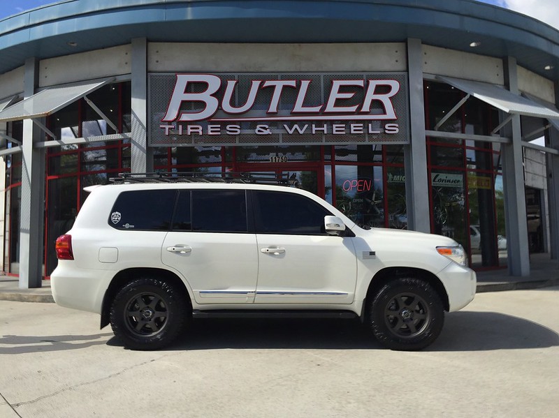

Time for Tires and Wheels, went with Enkey 18x8 (5x150) and Nitto Terra Grapplers G2...... 285/65 R18
Tried (actually ran them) the Cooper Discoverer AT3's and loved them except that the shop couldn't get them balanced right, so went to Nitto. (found out after a while their machines were out of wack)..... would have stayed with the coopers :( such a nicer ride, next time I guess.

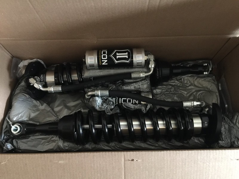

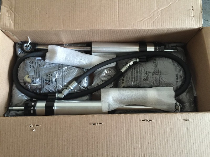

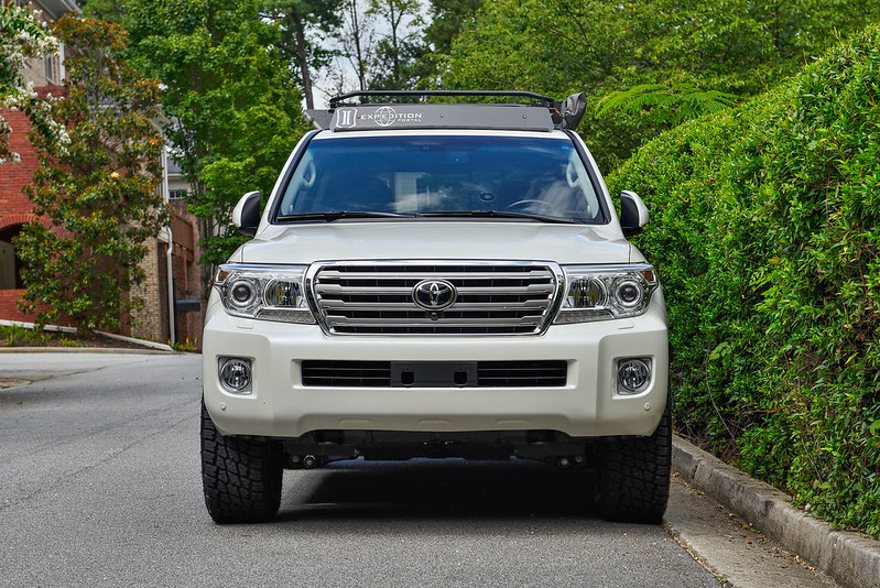

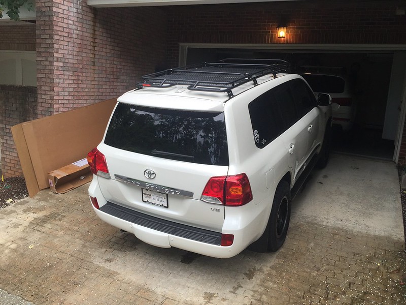

More toys ICON Stage II, OME 2720 ..... had gone OME 2722 originally on the rear but the LC was sitting too high for my taste and rode too stiff, also wouldn't go in the garage which is a no no for me.
Also, Total Chaos UCA's.

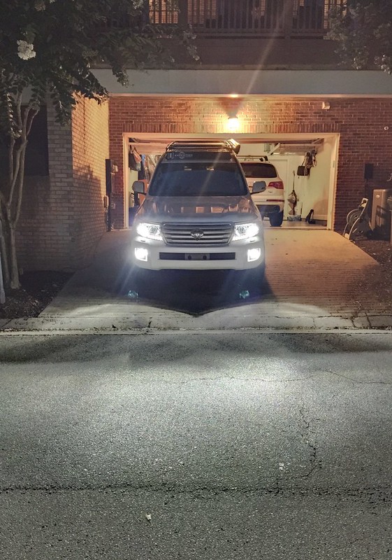

Used some trim packers on the rear to give it a nicer stance.

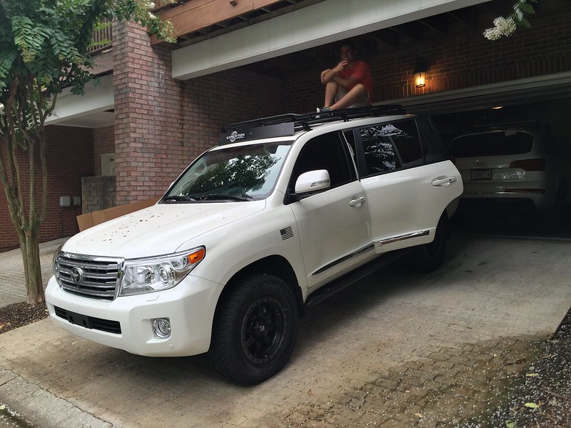

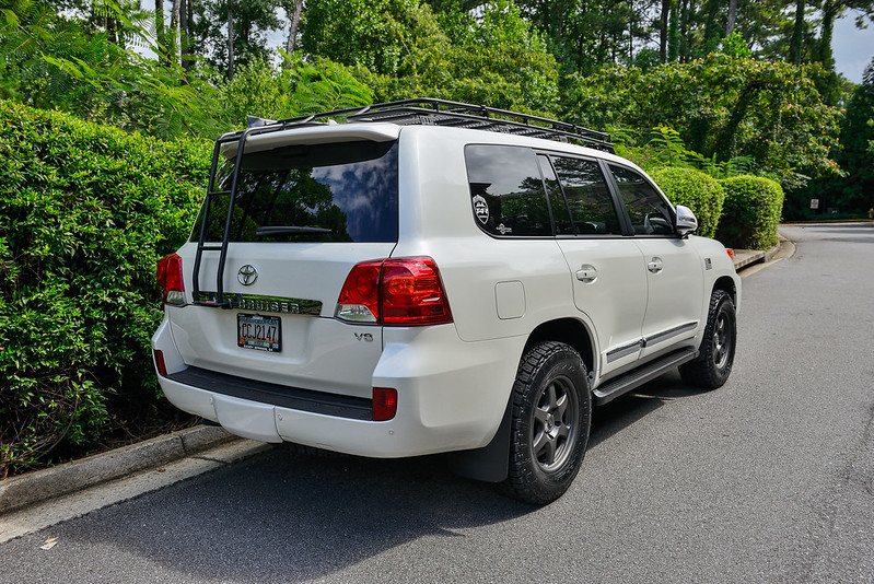

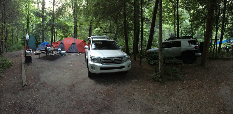

And here she is:
