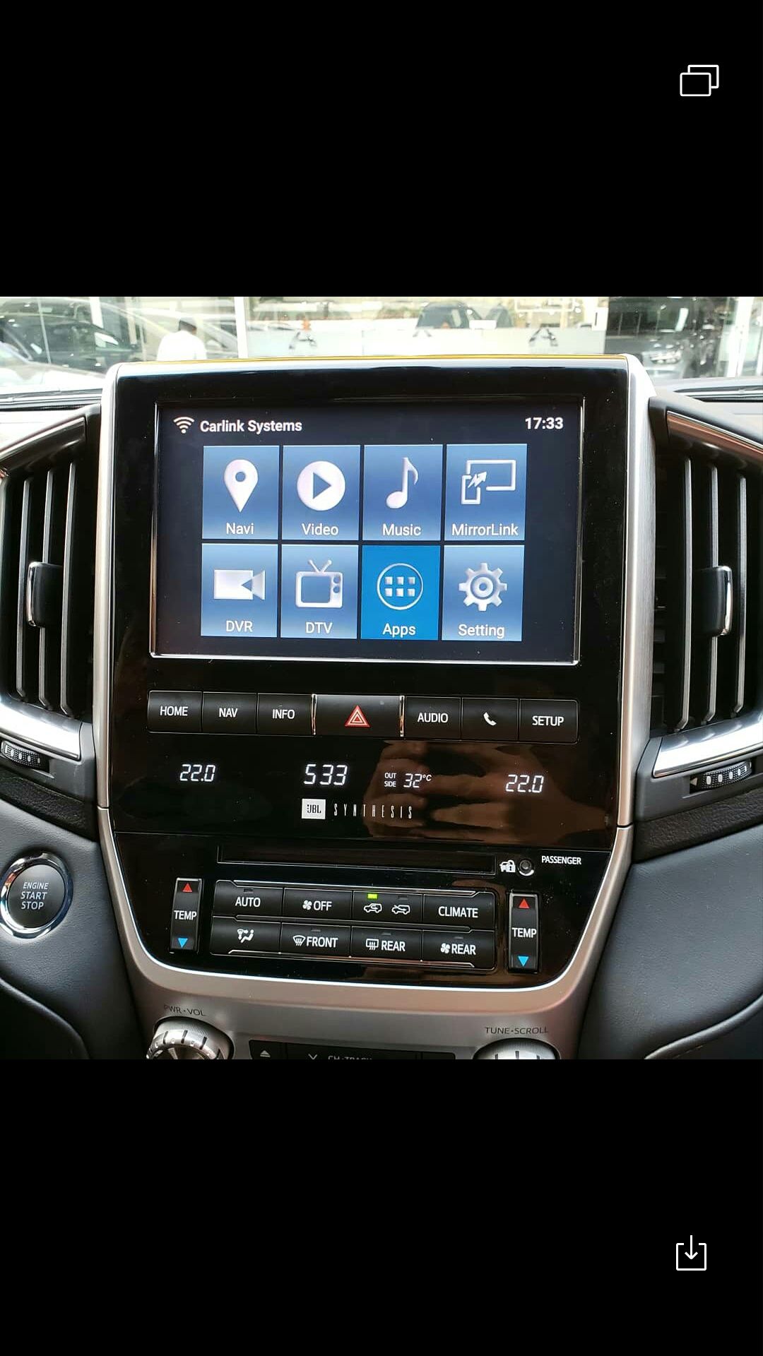

I am in discussion with a Chinese manufacturer of Android system that utilizes OEM screen but you have android box you can switch to. Per initial conversation it works with US JBL system for my LC16. Here it is a picture. I have sent few clarifying questions but may take a plunge to try it.

I am in discussion with a Chinese manufacturer of Android system that utilizes OEM screen but you have android box you can switch to. Per initial conversation it works with US JBL system for my LC16. Here it is a picture. I have sent few clarifying questions but may take a plunge to try it.View attachment 1909808

The Vline Grom works in the Land Cruiser (at least some model years). I see they are adding Android Auto support this month. Seems like they have improved a lot over the last year. This may be a better option as the rear dvd should still work (which may or may not work with Phoenix/Smartytrend/Rhino radios), as well as the wiper heater, which is not supported by any of the Tesla style radios.
What pricing are you getting from your China source? Will it support steering wheel controls/android auto/etc?

Pricing tbd but it offers steering control, DVR, 360 cameras, integration with car sound, etc.... They still run on android 6 but mention that will offer an upgrade to 8. Question, what did you mean by android Auto? That start in android screen automatically with car start without pressing a button?
No. Android Auto is a Google/Android Product that runs many apps off your phone on the cars touchscreen in a safer format: Android Auto
The 2020 Tacoma/4runner/etc. will have Android Auto built in (sounds like the 2020 LC may be left out). That way there is no need to tether or use bluetooth to get the system to work. Just plug your phone in and go. The lack of Android Auto and having to tether is what turned me off from this a year ago. Now that it has been upgraded to offer Android Auto, it may be a good solution.
