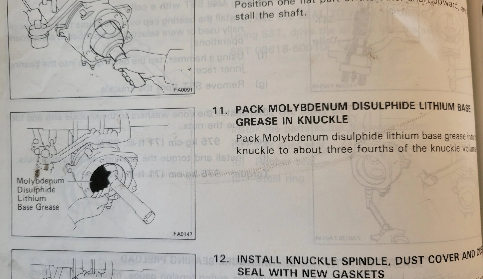

There were some wiper seal kits that had a split in the seal but I'm not seeing those anymore when I search around, I guess they didn't work too well so yeah, gotta take em apart. One more thing I'd like to add. In my 85 factory manual, Toyota says to only pack 3/4 of the knuckle volume with Moly grease so I would assume if you fill it all of the way, the extra grease will find its way out. maybe you just put too much in there in the first place. I'm going to assume it needs 1/4 of the volume to be air for displacement of grease during operation. To answer the original question, If you think adding more grease will hold you over until spring, I would continue to use a moly lithium grease which is what is recommended and usually of a thinner consistency.
