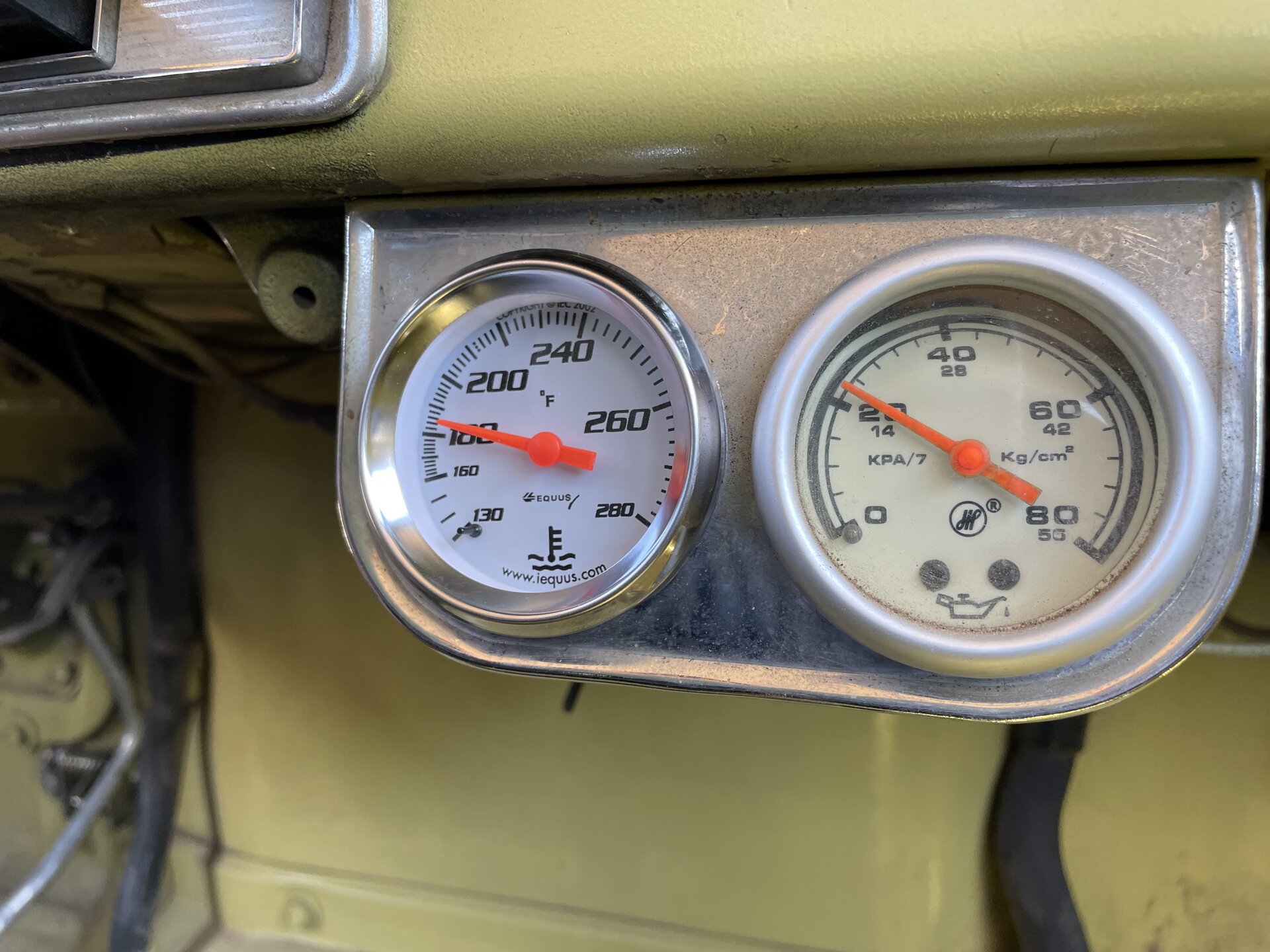

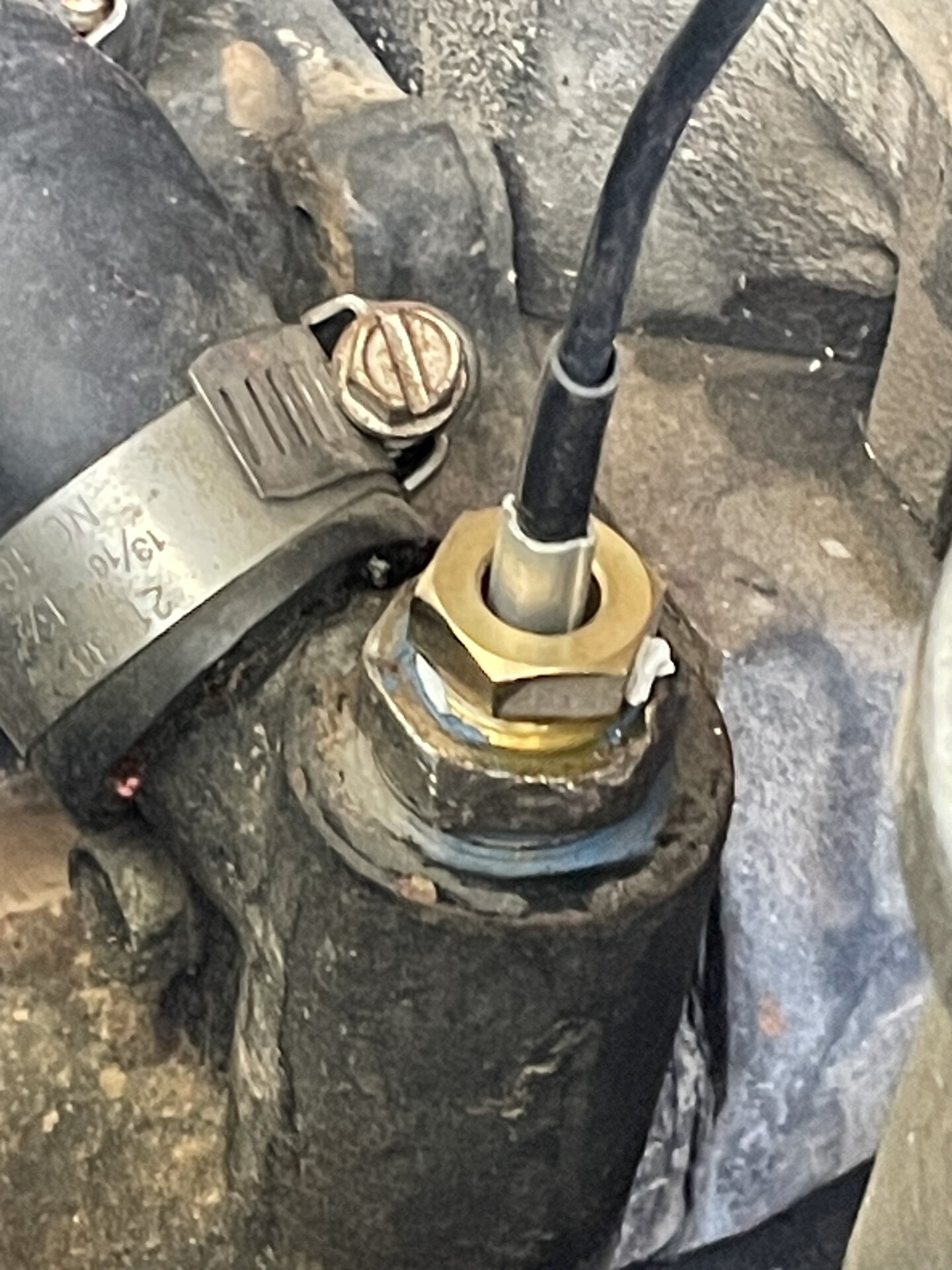

I ended up going with the brass mechanical bourbon sensor.
First P.O. thing that actually worked out. PO had added an aftermarket one previously, but it didn’t work. Replaced with all new gauge and sensor. Sensor screwed right in to POs adapter!
Works great and the ol’ gal cruises along right at 185 degrees
