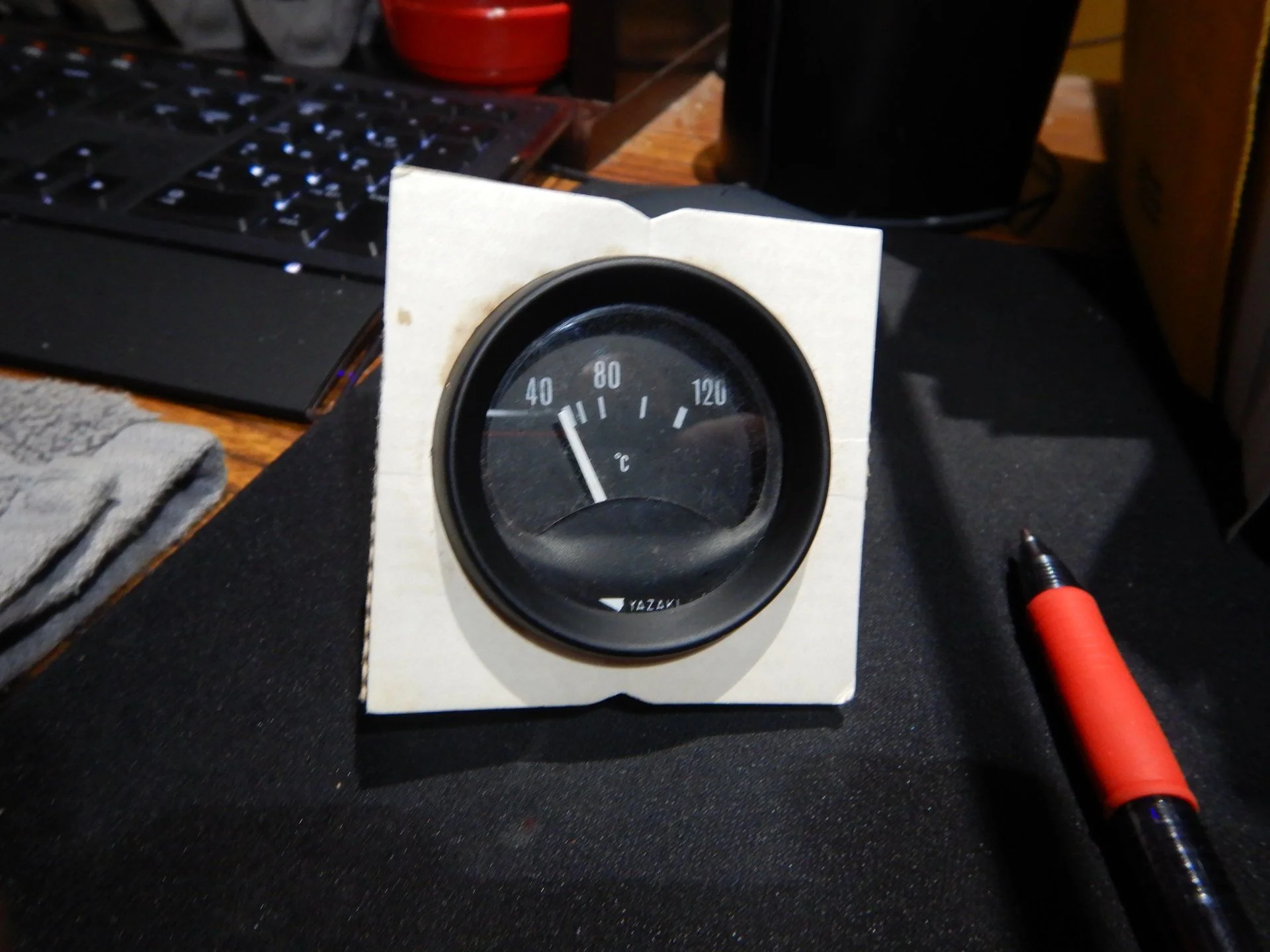

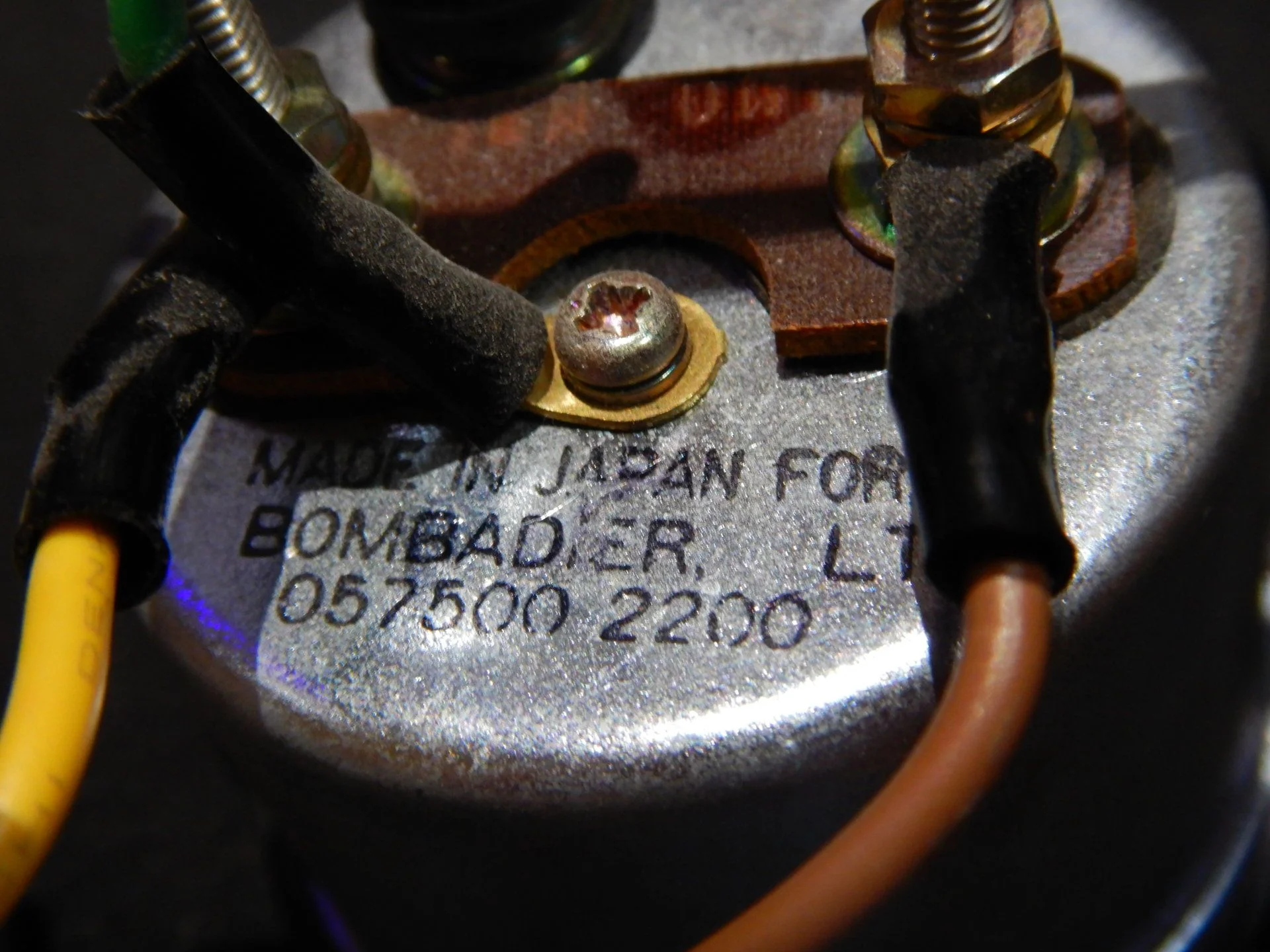

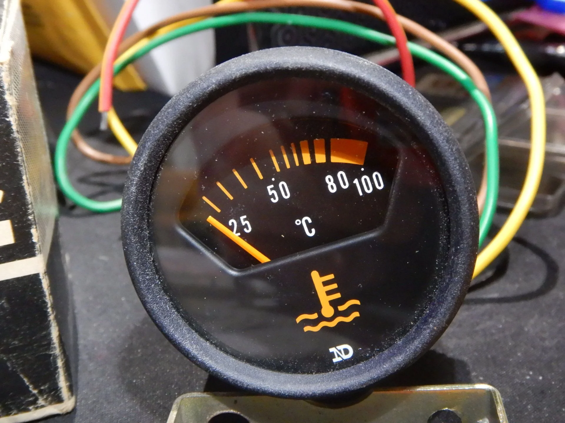

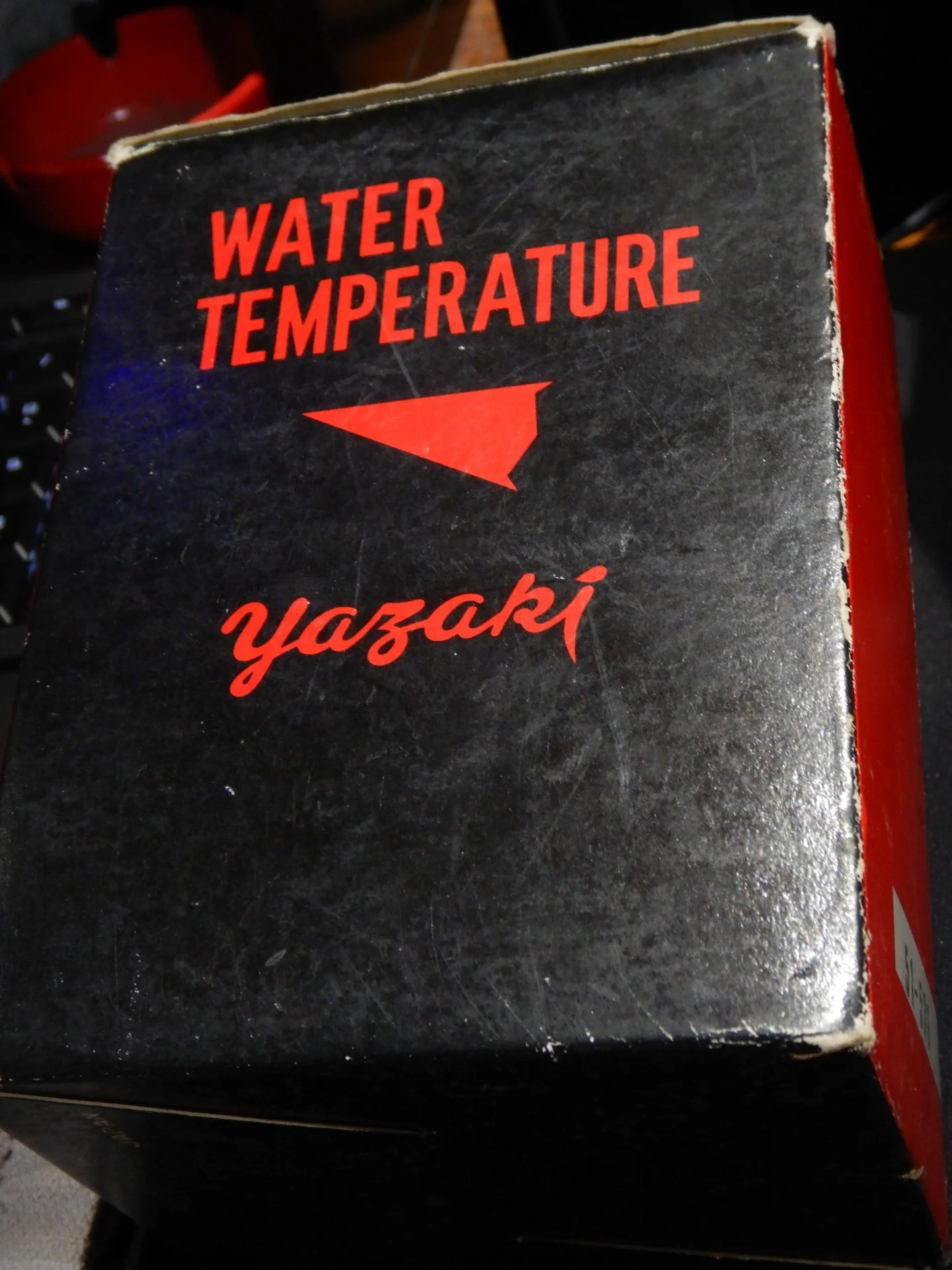

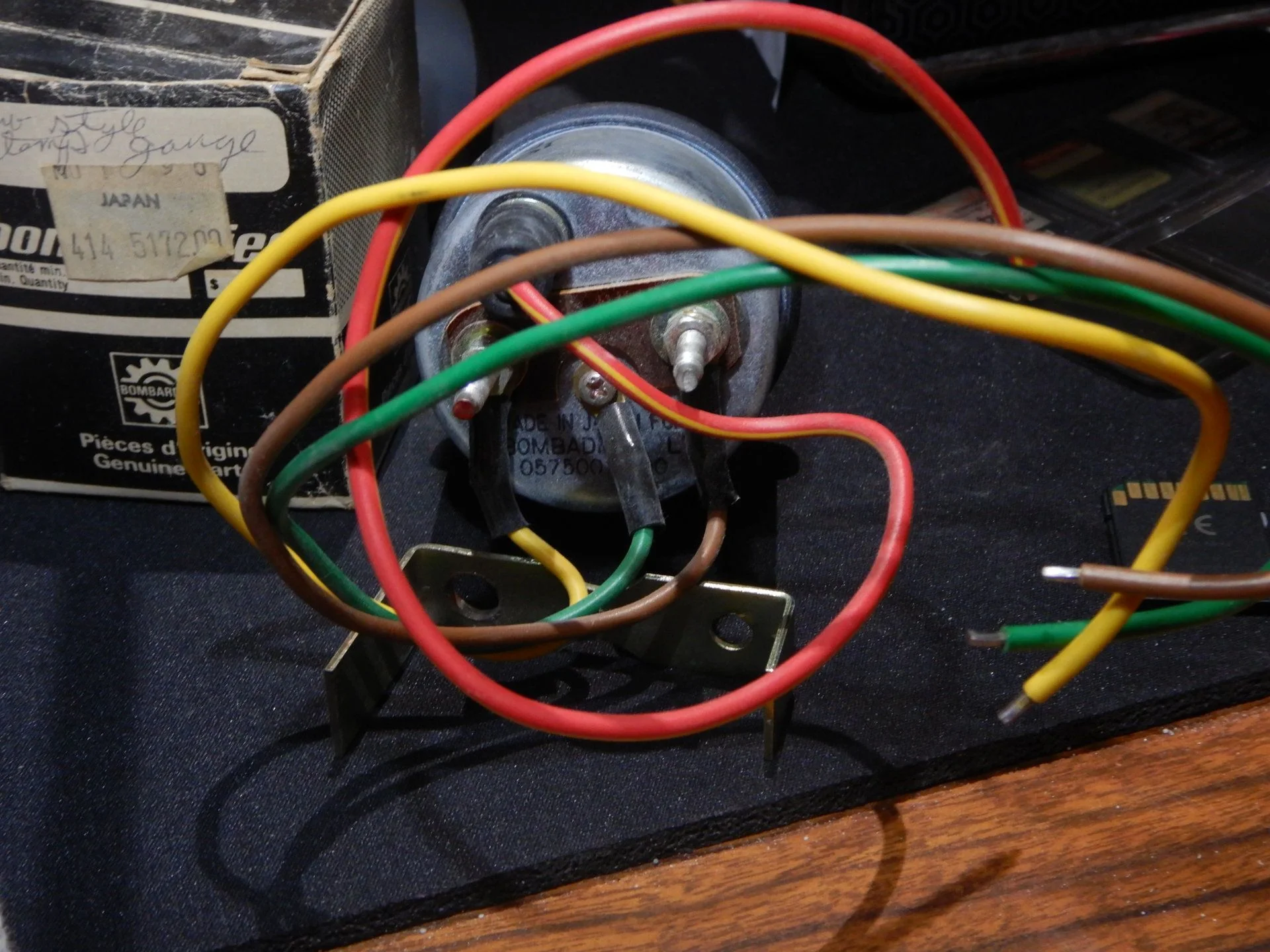

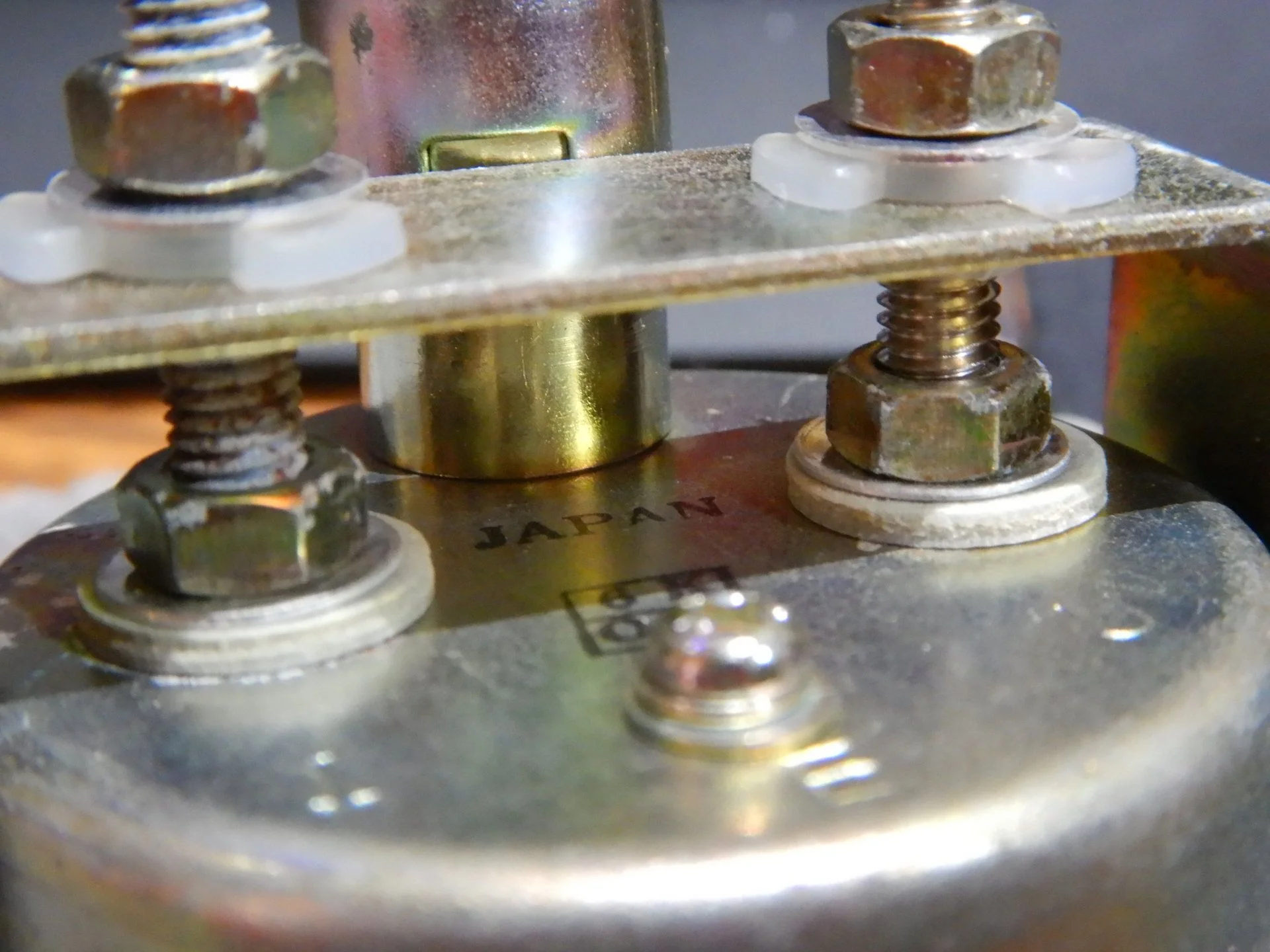

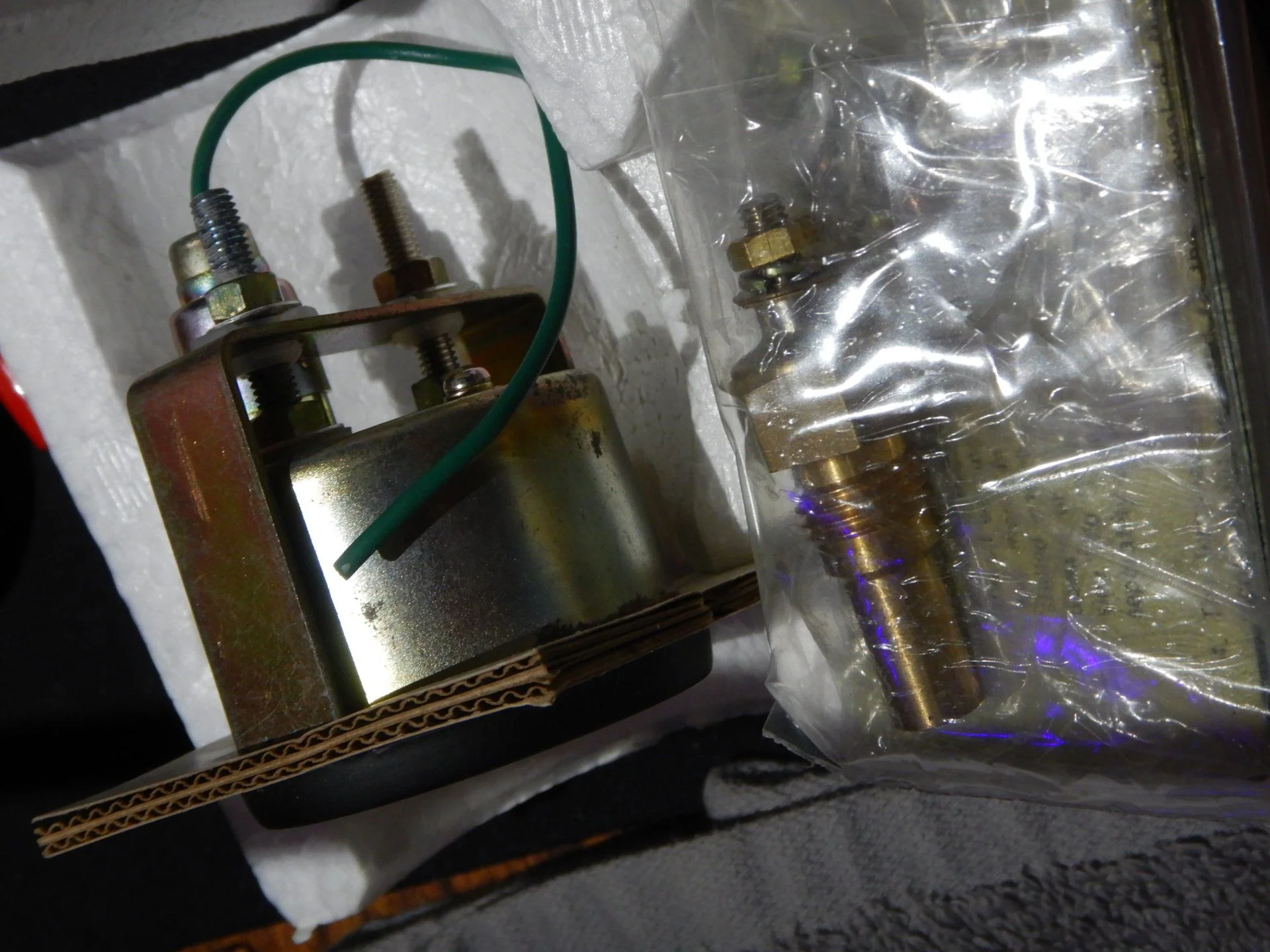

you have the option of a stand alone NOS OEM TOYOTA Parts maker NipponDenso or a YAZAKI 52mm
Cooling system Guages
the YAZAKI even comes with it's own stand alone Sending Unit , Leave it To YAZAKI to think of
everything once again 💥
i personally like the RETRO Flare of the ND NipponDenso persoanlly for a 60
either will fit into a standard Guage Pod you buy aftermarket online for the A pillar for example
Big Question is do you ADD a second independent stand alone sending unit , for the addional
Gauge and the Answer is Heck YES .

The Reason i showed you Examples of the YAZAKI and NipponDenso stand alone Gauges , is precisely
because there NOT made in China or any other South East Asia Country , but Rather MADE 100% in
JAPAN ............
IMO, Stay away from cheap China Gauges like mentioned , its some work to install them Right , and you
only want to Do it one time !
Also , your TOP consideration should be staying away from a CHINA type or USA Capillary Tube
type OIL pressure gauge
and Lean HARD on a Sending unit Sensor style OIL type JAPAN Gauge .

NOS temp gauge available, if you are looking for one.
