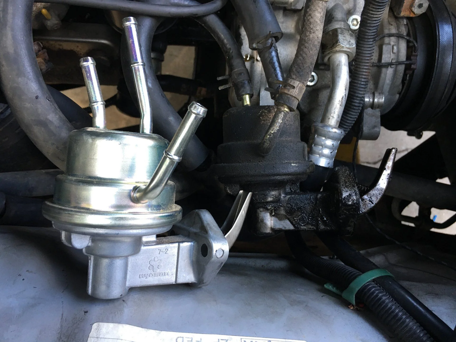

Replaced all the 5/16" fuel line and put a new Kyosan fuel pump in. I need to keep a fuel filter handy because they're getting dirty in a few thousand miles. I expect that the tank is covered in fine silt. I think the truck was experiencing ever so slight fuel pressure issues from the 288k original TEQ pump.
Feels smoother all around but I can't tell if it's psychological or not.

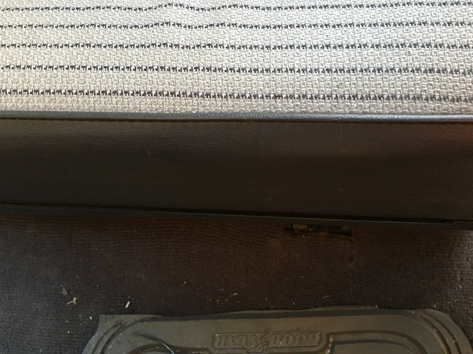

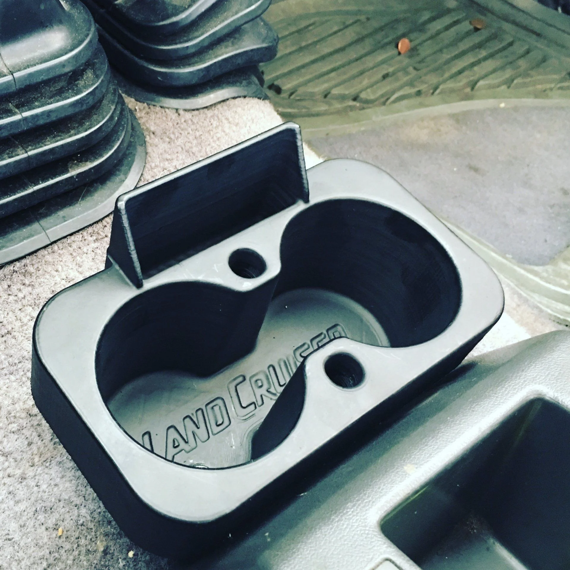

Also bought a cup holder for a 60 series from eBay and I find out the hardway that my late 87 build 60 is really more of a 62.
I have a 62 series console and a cup holder for a 60. So I screwed it to the floor in front of the console and went on. $45 that prevents me from buying a $300 conscole when I need other things more.

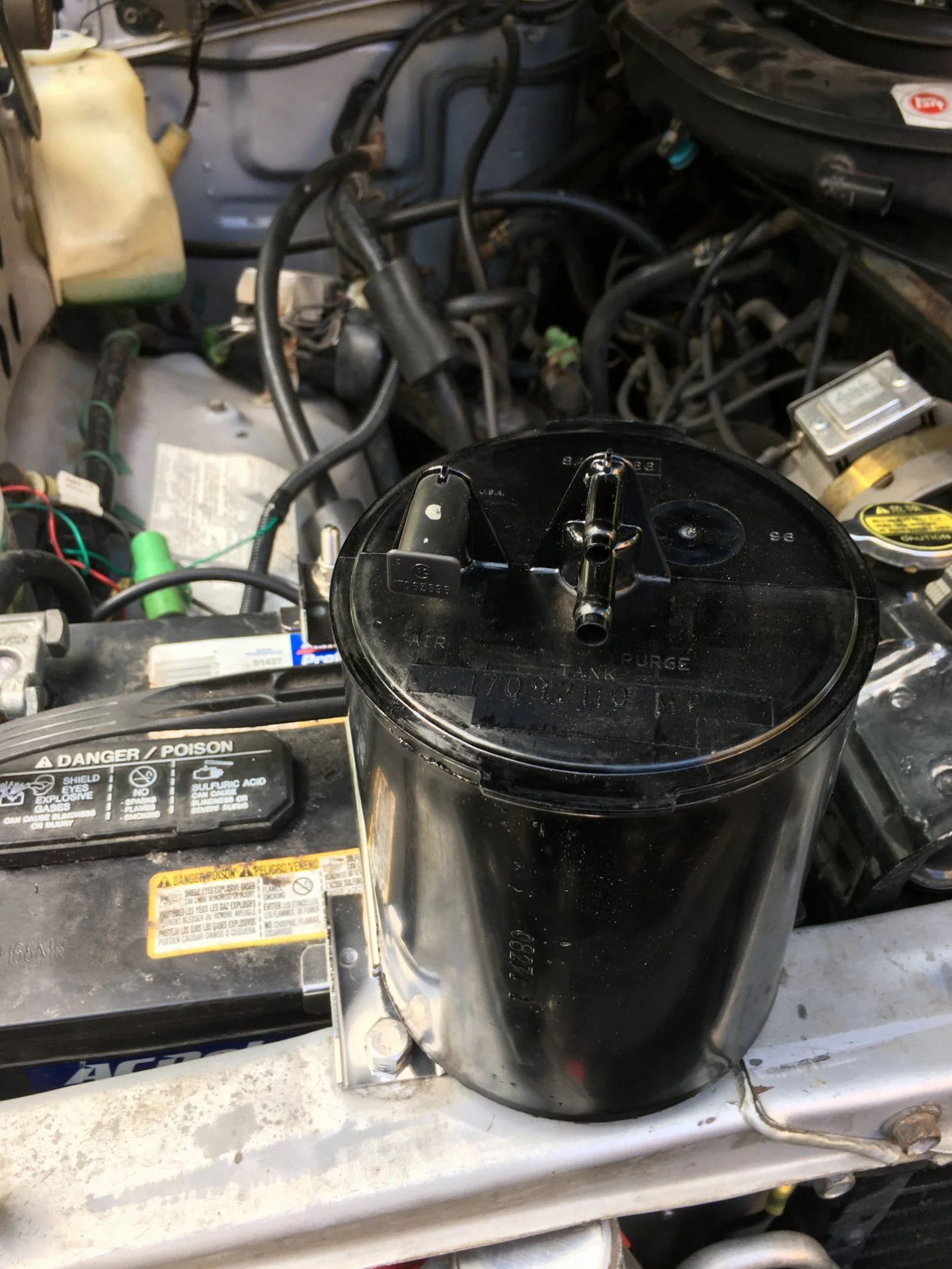

Tomorrow I'll finish my delco vapor canister and that should eliminate the last of my vapor issues with the tank and an ever so slight gas smell at times.

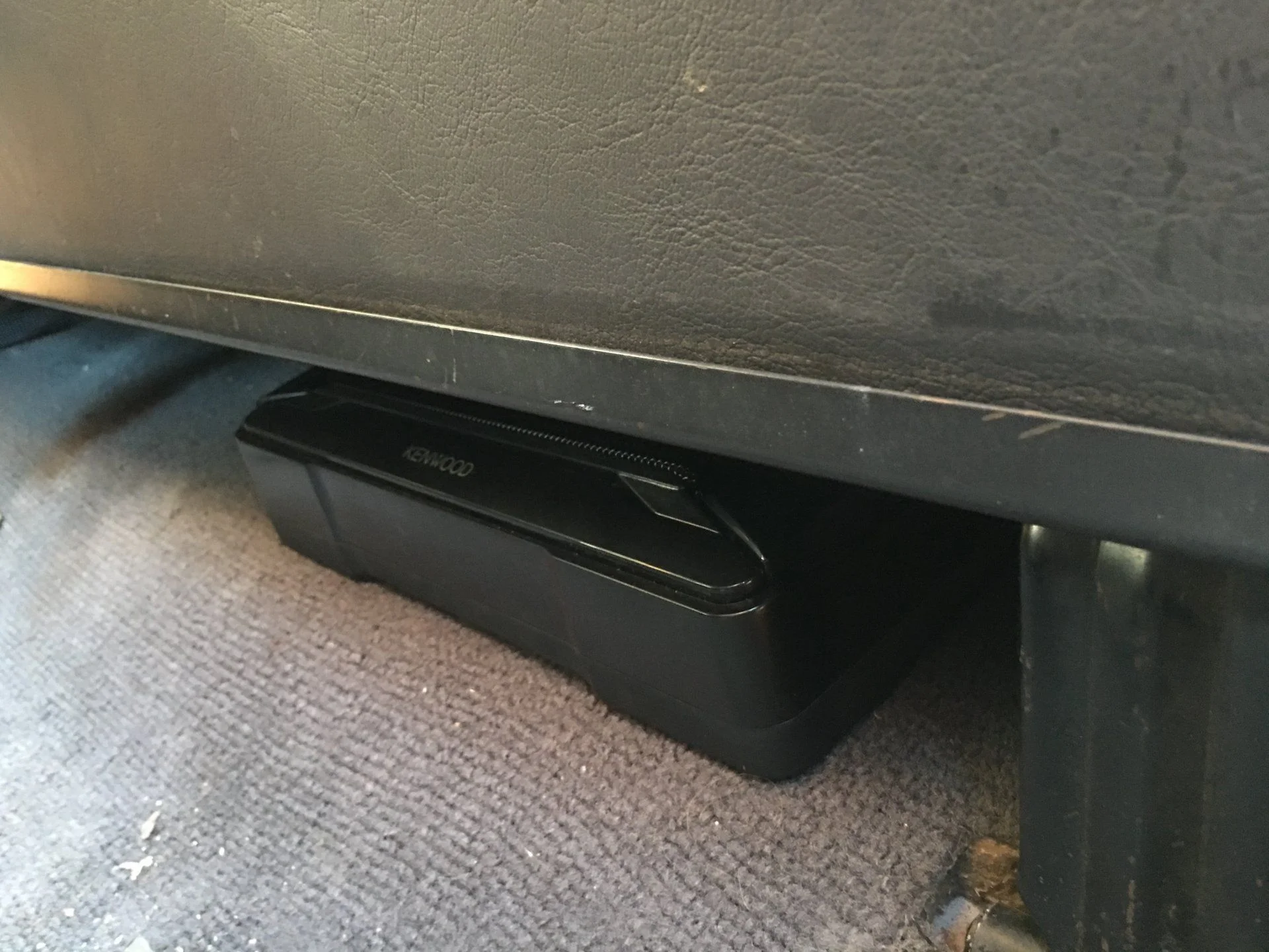

Kenwood underseat sub 75w rms. This fits with my theme of hidden audio. I've got an premium Kenwood KDC-998 headunit, a mini kenwood amp that fits under the dash behind the radio and a pair of Rockford 6.5" Prime door speakers.
It sounds good now that I added insulation to the doors, but the door speakers are not suited to producing any clean bass in the doors.
I decided to finish out the hidden system with a mini underseat powered sub by Kenwood for $133 from Amazon. It's the smallest one I could find and should be able to fit under the back seat since it's under 3" tall. It will have to be scooted a little forward but should be almost completely hidden once I throw jumper cables in front of it. I only expect it to complete the bass that a factory system would have and I want nothing more.
If I need to it can be easily removed if it interferes too much when the seat is down. I thought about hiding it in the rear quarters but it will most likely move under the passengers seat when the rear heater is deleted.

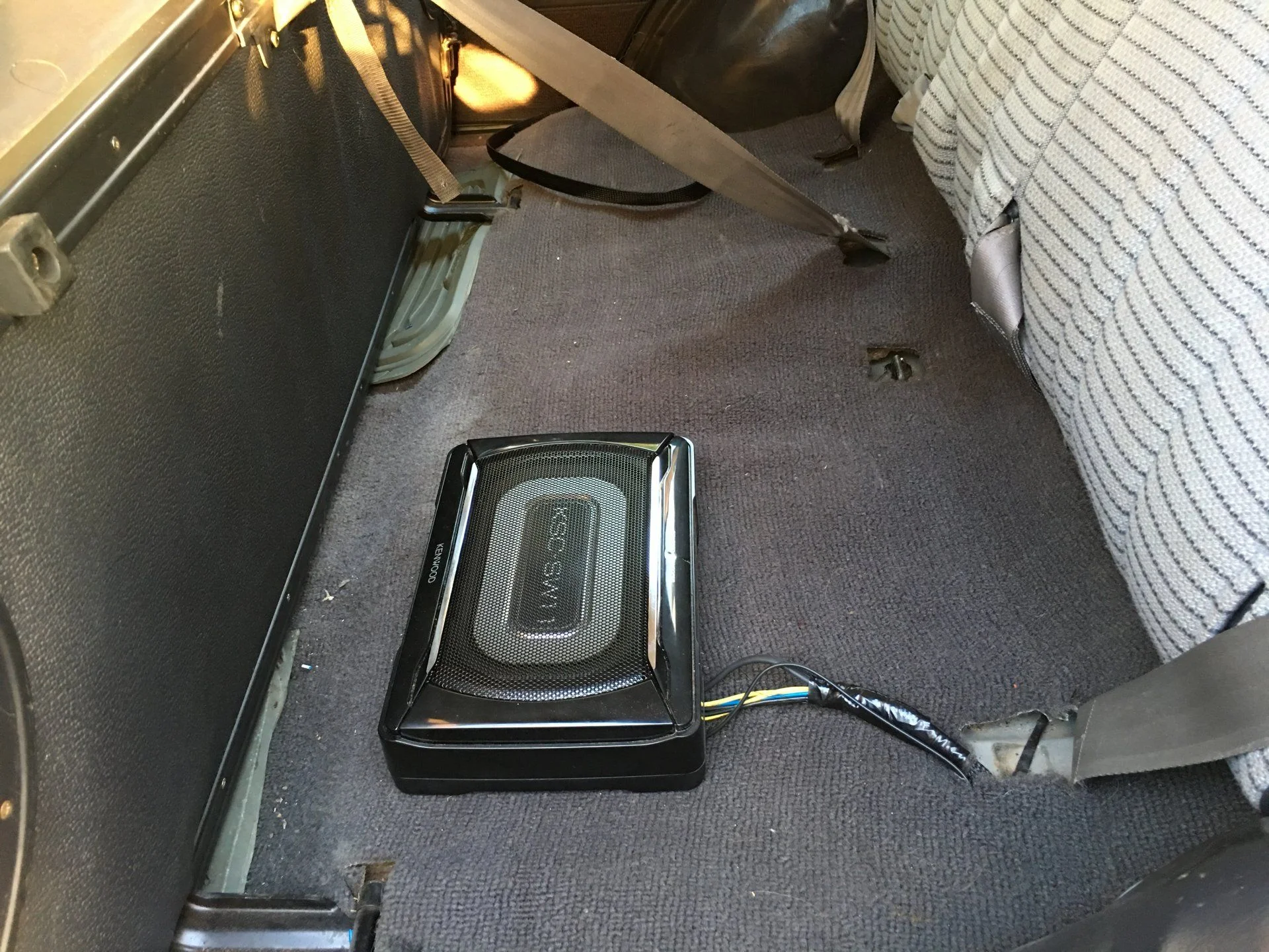

I added the small amp, and it sounds great. Not glass shaking but certainly feels more like a proper oem system with balanced levels. The doors no longer rattle since the 6.5" speakers aren't trying to produce bass like before.
Really simple install, completely removable if I need the space and a great addition to fill the void of all this space in the truck.

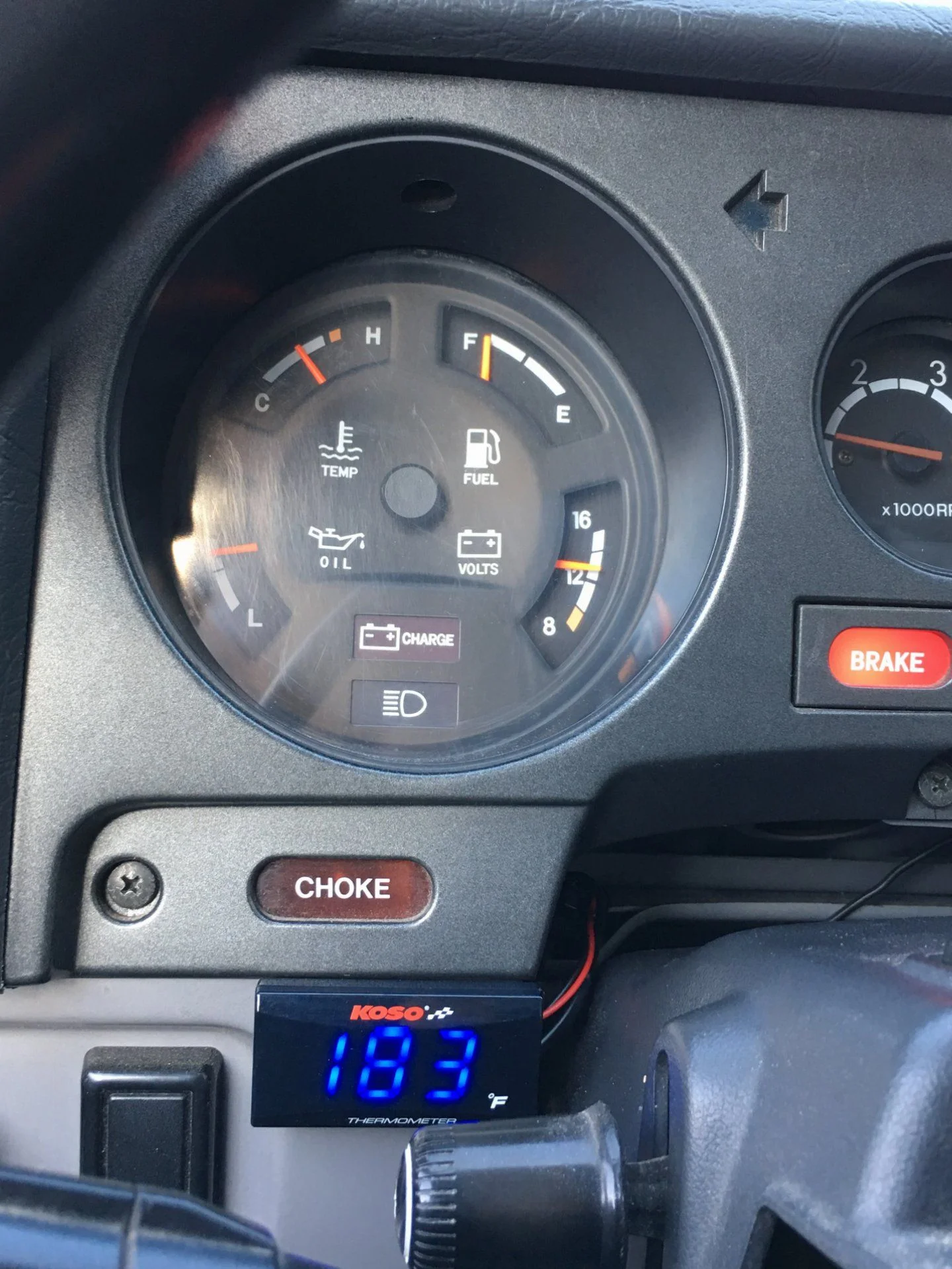

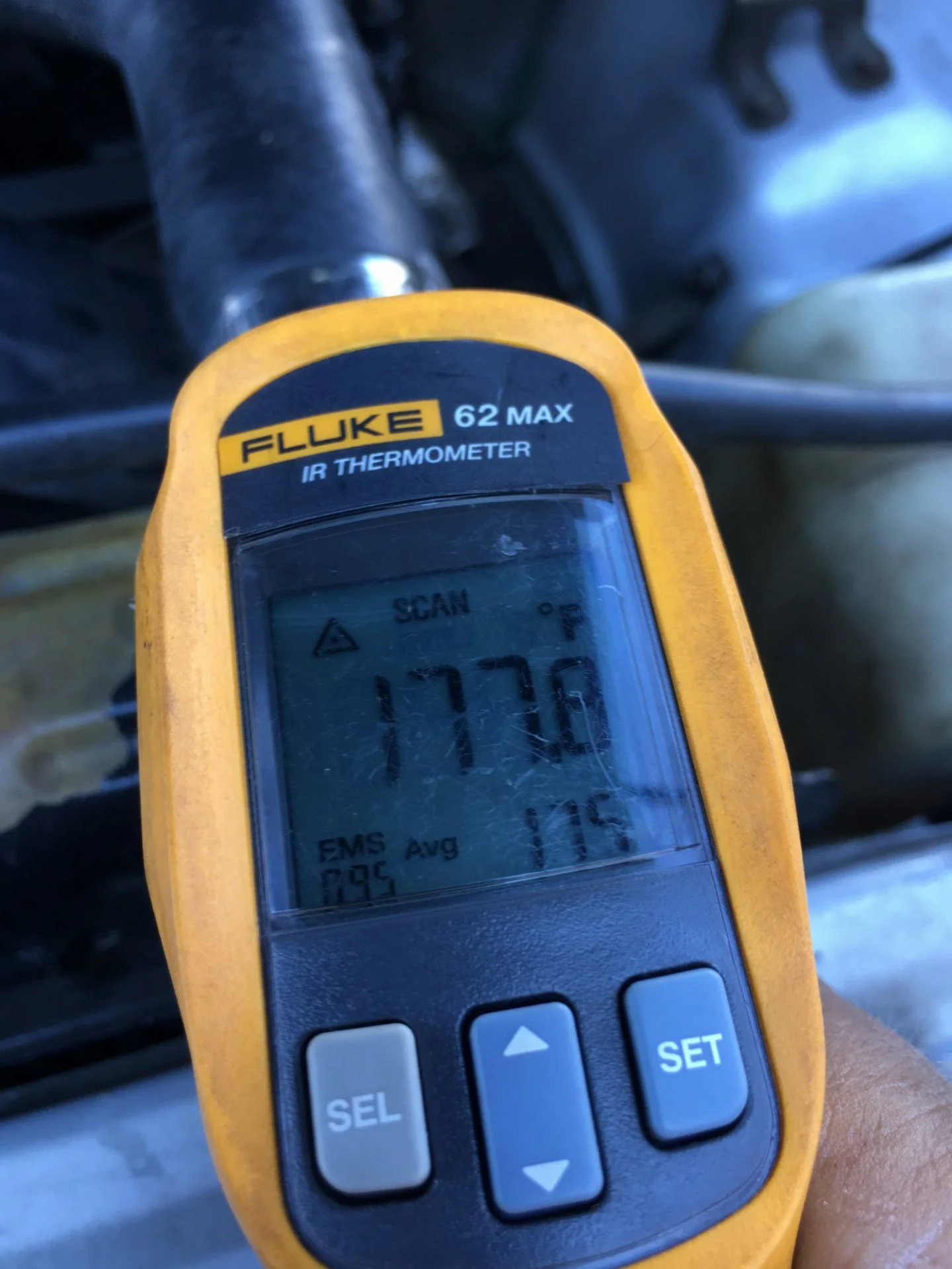

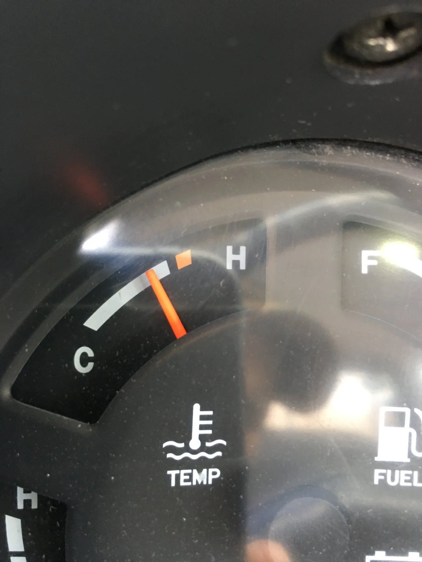

The picture of the temp gauge is where it would be after any time on the freeway. That's 190* on my IR gun. It never overheated but I had concerns that I was right on the edge.
Finally flushed the system and put some good Zerex coolant in. Also put in an oem thermostat. Currently bleeding the system little by little. I was getting a temp spike on the highway and I think it was the non-oem t stat. So far, much more consistent operation. Didn't really move from the middle all day and it's 97* today.

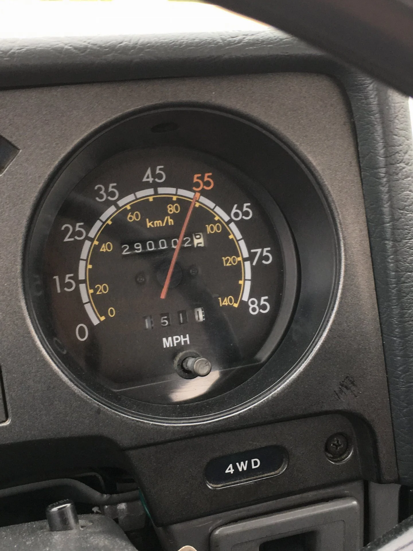

It just hit 289,300 miles.
Also went out and took some pictures to celebrate.

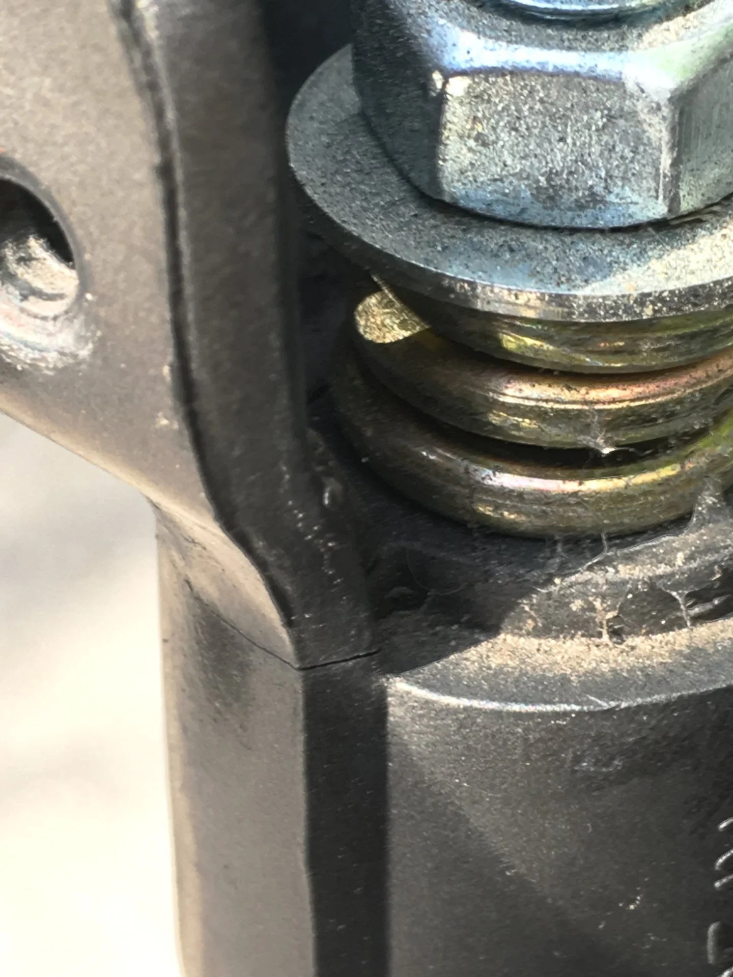

Now that the cooling system is working better, I find that all my hose clamps are requiring attention one by one.
Just a few turns stops the weeping. I chose to use oem style wire clamps and a year later I'm still working on the fine line between snug and broken to pieces.

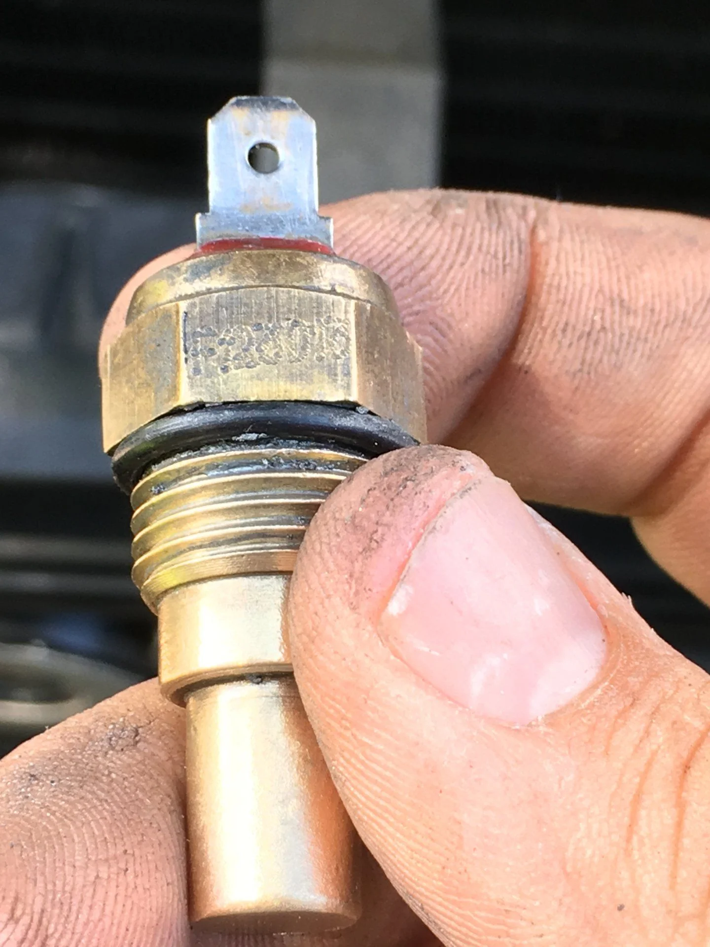

Finally got the leaks stopped and I bled the sending unit. Turns out the PO used a non oem sending unit.
Waiting on an oem replacement for it.

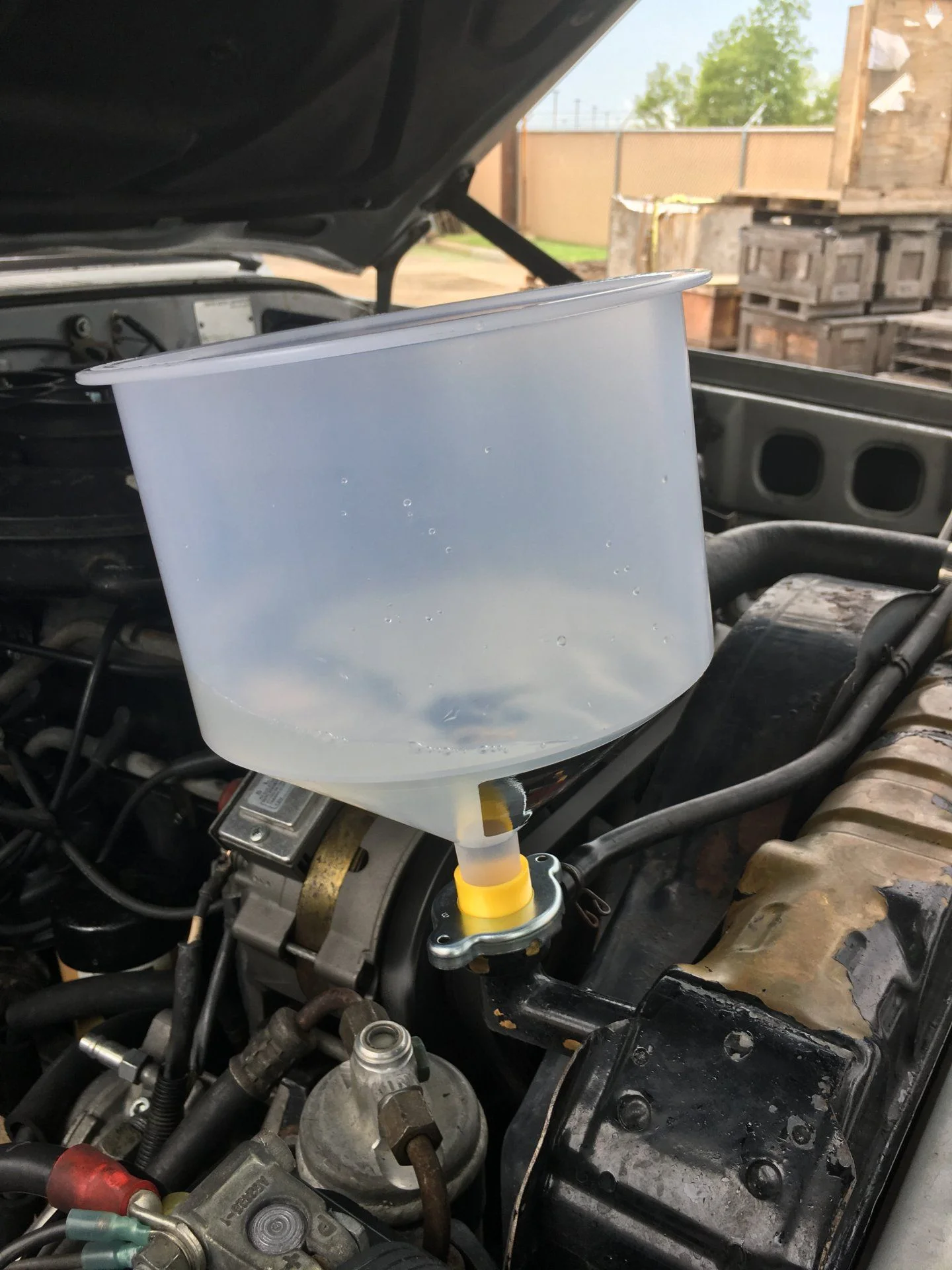

I also bought a proper fill tool. Way nicer than I'm used to.

I'll be swapping the coolant temp sensor yet again (was mistakenly sent a 55 series sensor) and bleeding the system for what I imagine is the last time, adding an inline resistor to calibrate the gauge and moving on from spending every other day getting coolant drips on my clothing.

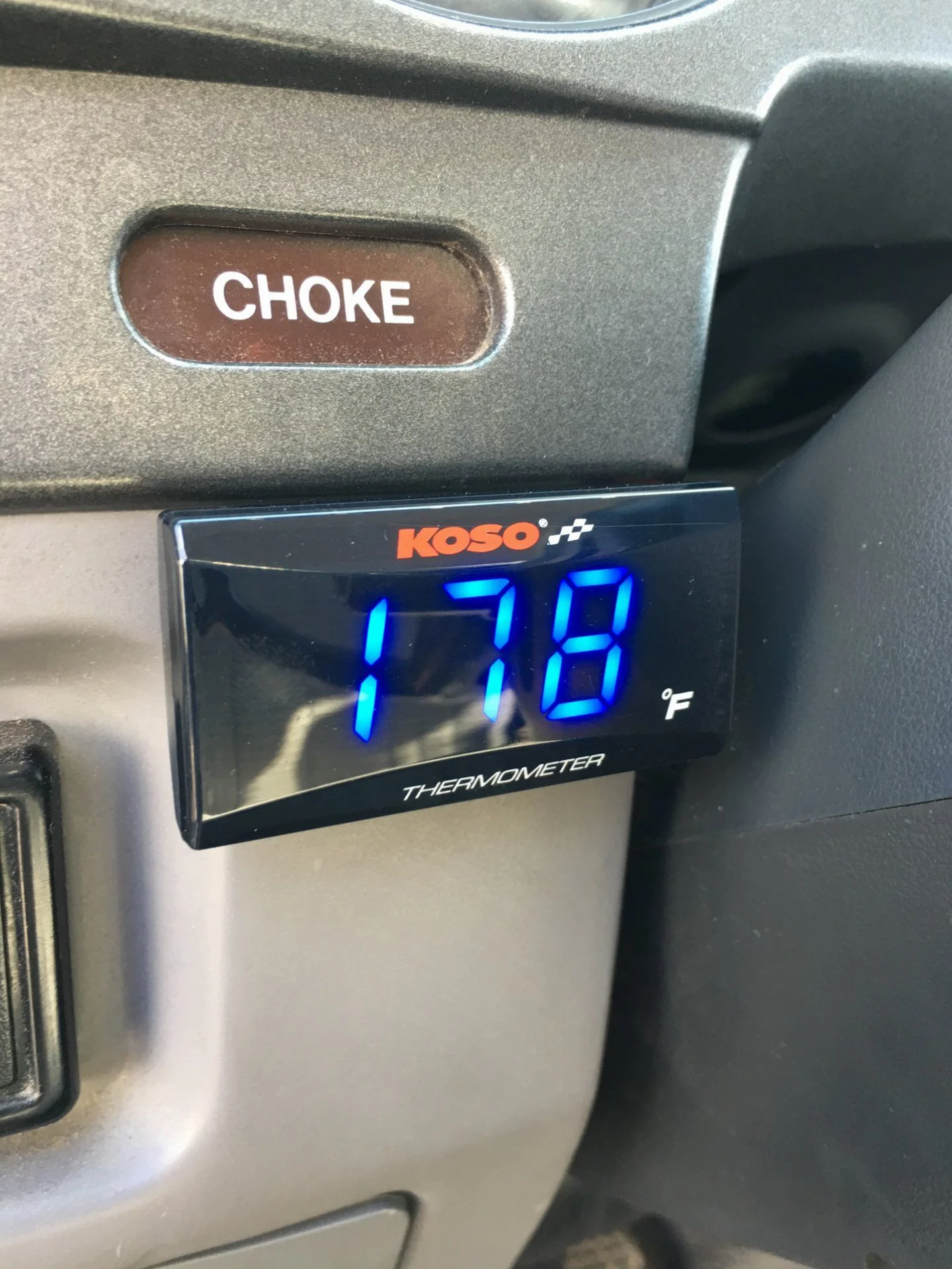

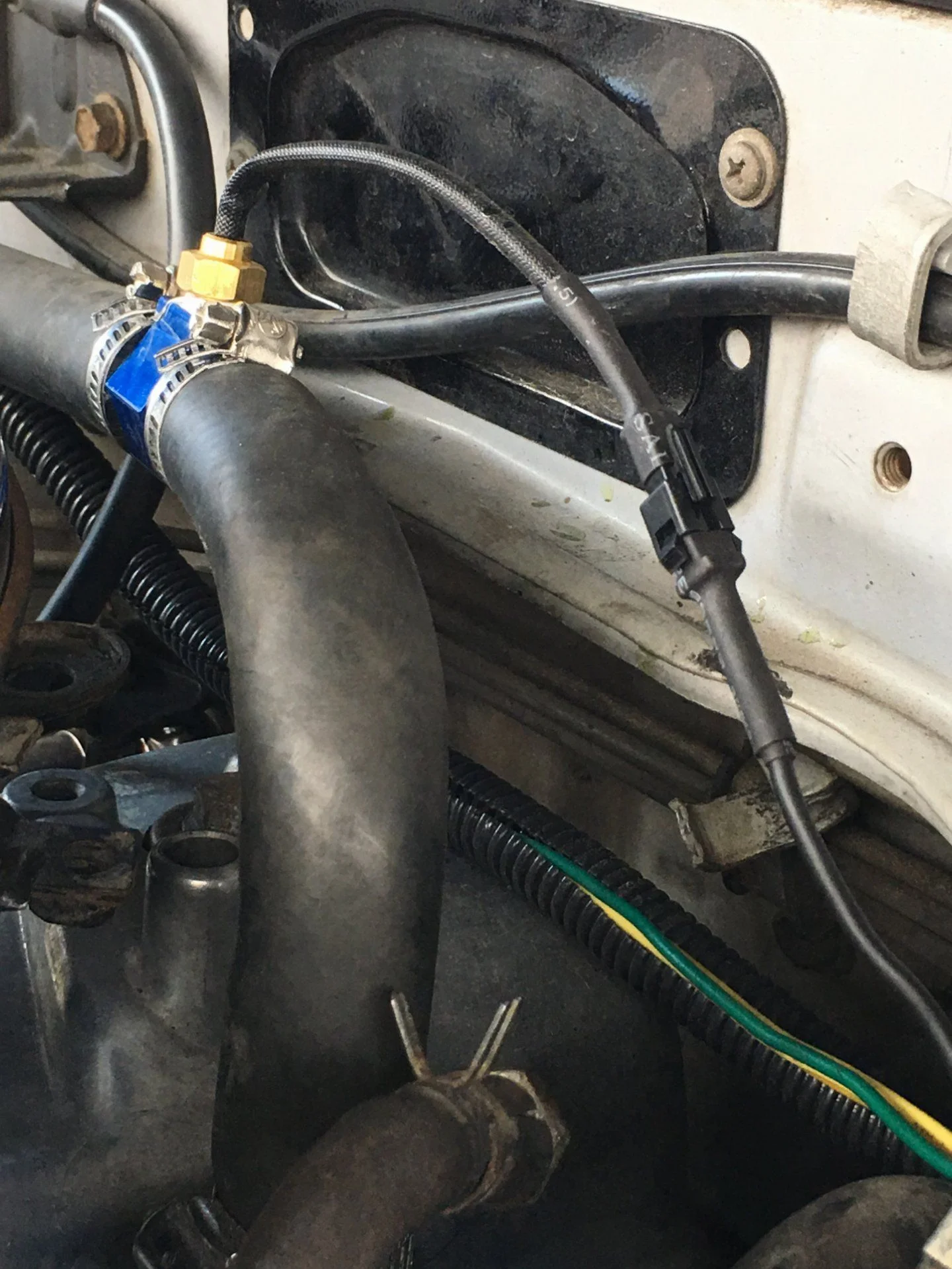

I finally believe the temp on my truck. As we all know the factory gauge is an uncertain suggestion. Replaced the whole coolant system and burped it countless times, added a new oem temperature sending unit with a 10 ohm resistor to bring it down into a middle range and I was still uncertain other than what the IR temp gun was telling me at idle while parked. Added this little nifty motorcycle temp gauge from koso, with their 16mm barb fitting adapter and added this inline gauge to my heater line right next to to oem temp sending unit. It all reads reasonably and honestly now with the numbers making sense now that I've got context.
The gauge is BA024211 and the 16mm hose adapter is BG016B00.

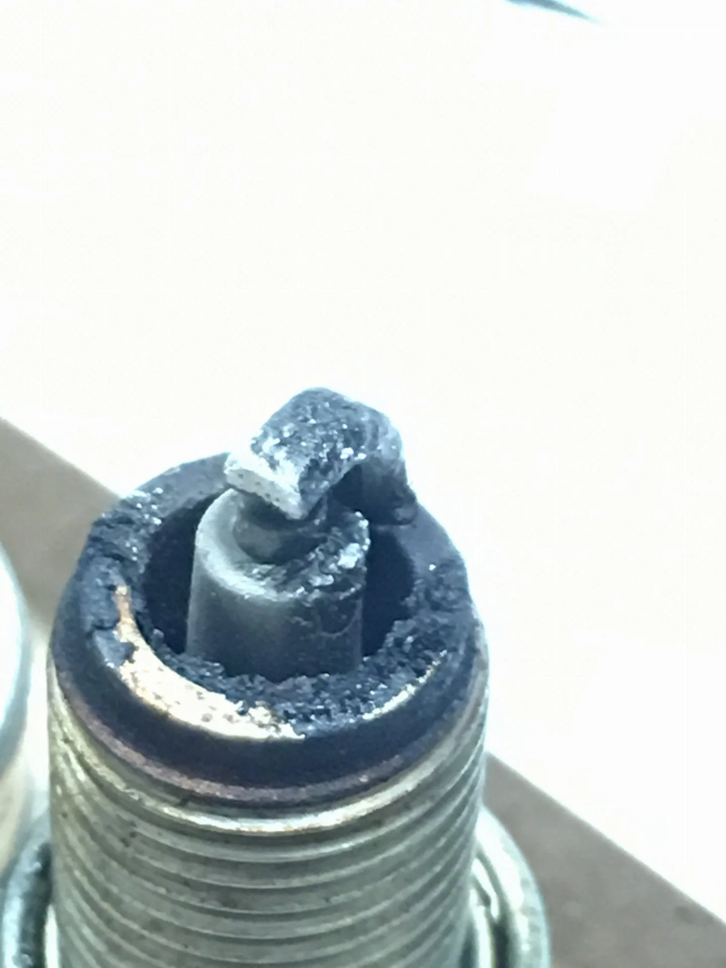

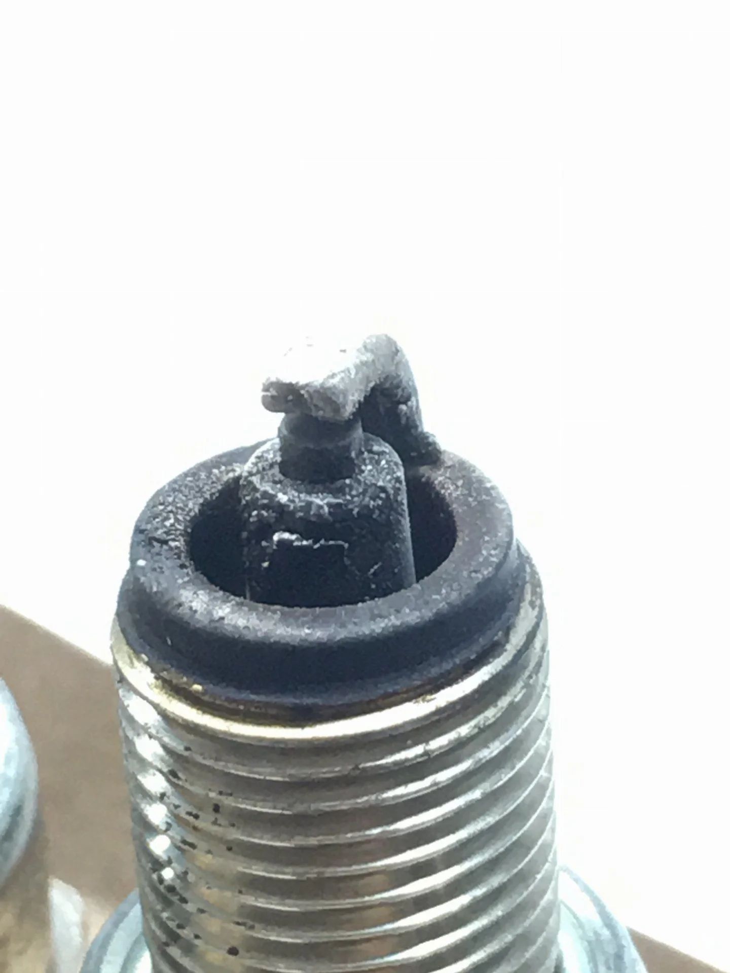

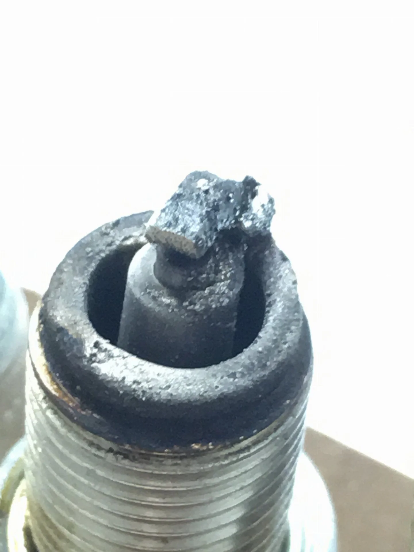

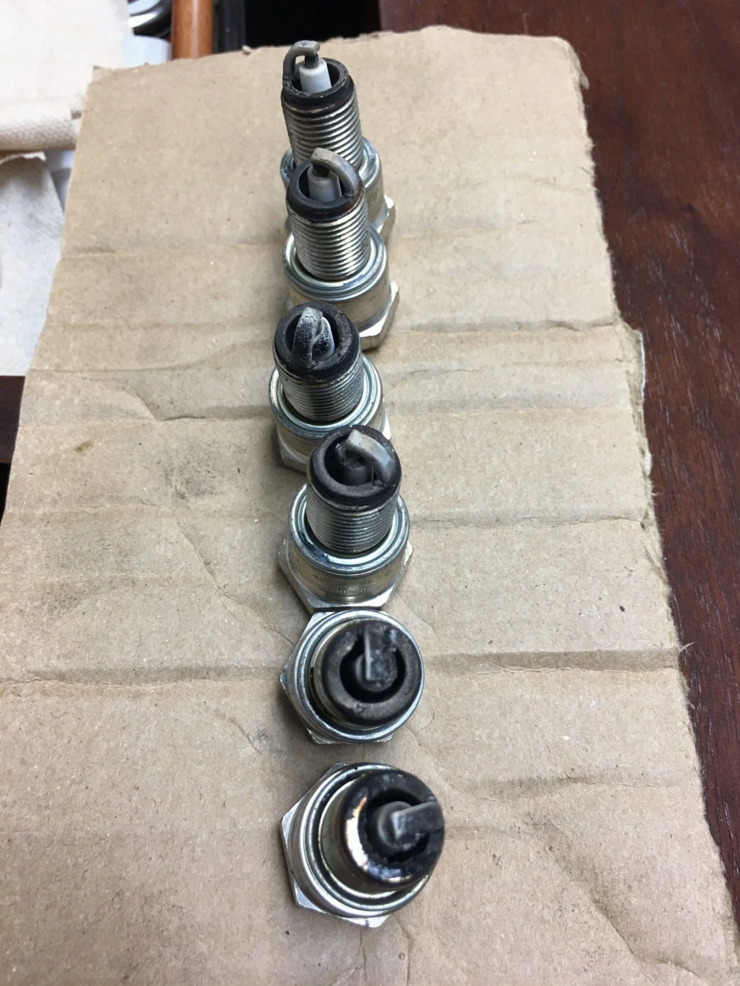

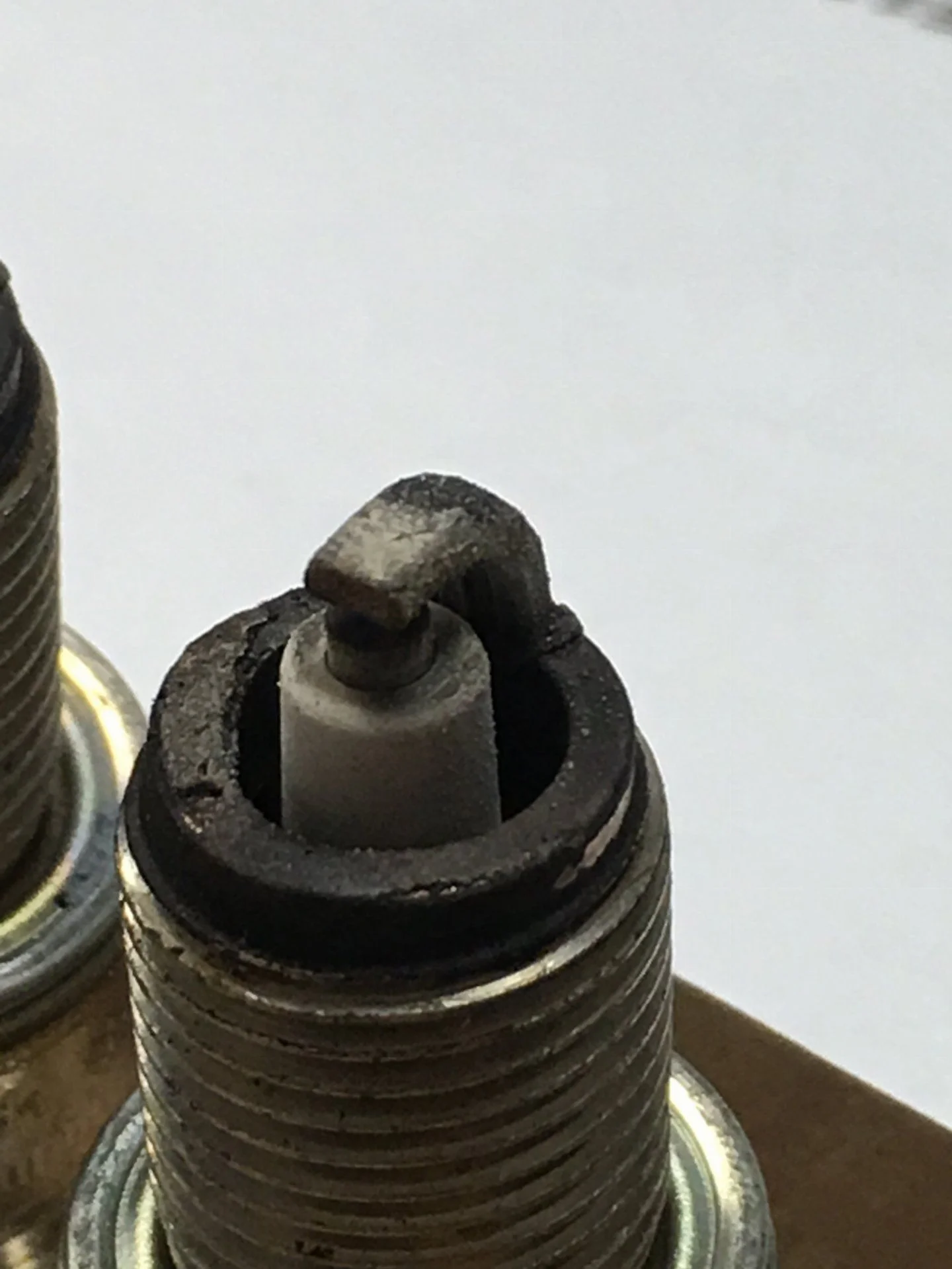

6000 miles on these denso plugs. A little oil on 3 straps but nothing serious. I try to run top tier fuel or NEG and always good oil and filters.
I'm not mad at how they look after 290,000 miles on the motor. I've got more oil leaking from the side cover than getting past the rings so that's a good thing.
Went with NGK copper this time around.

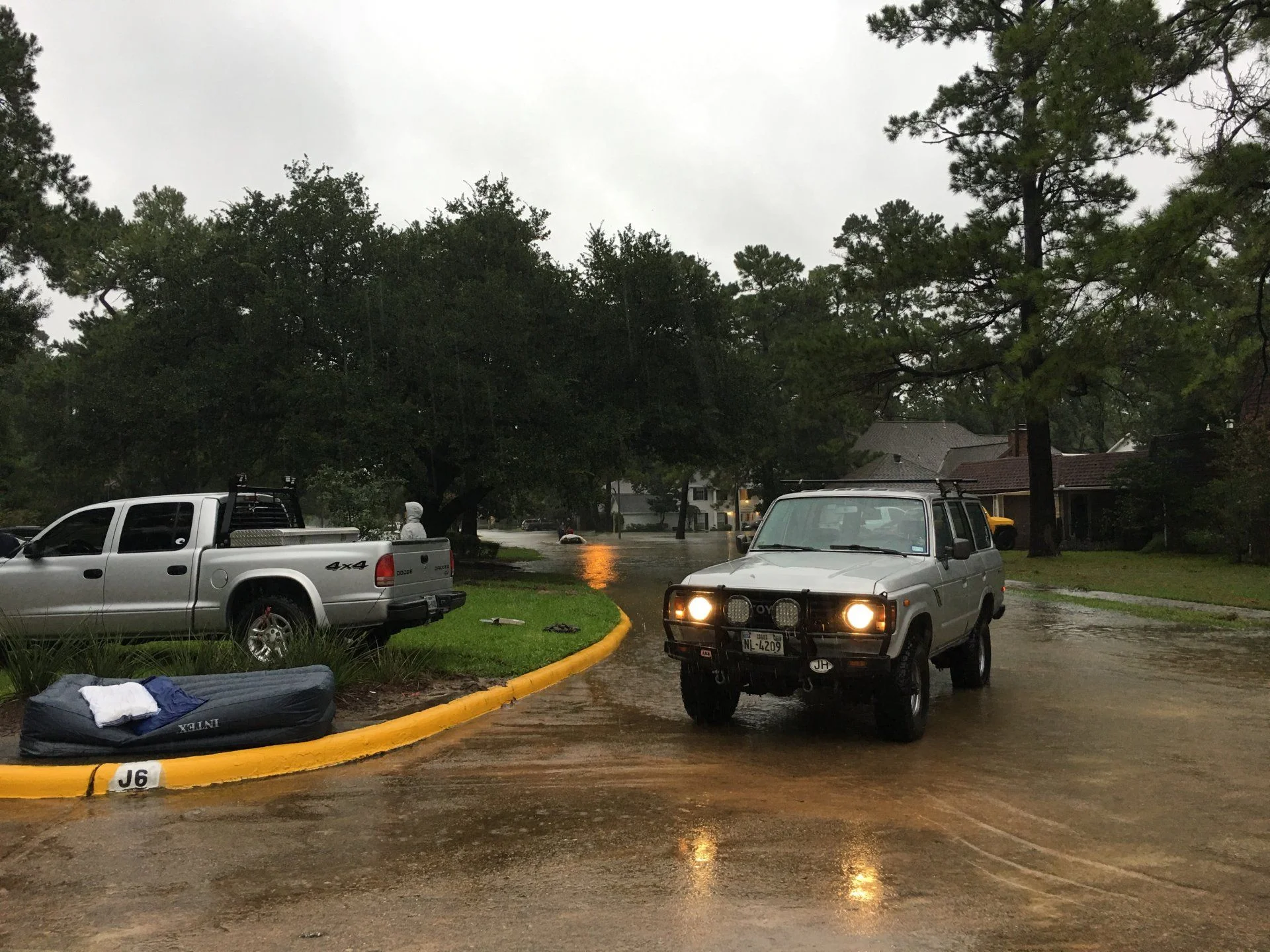

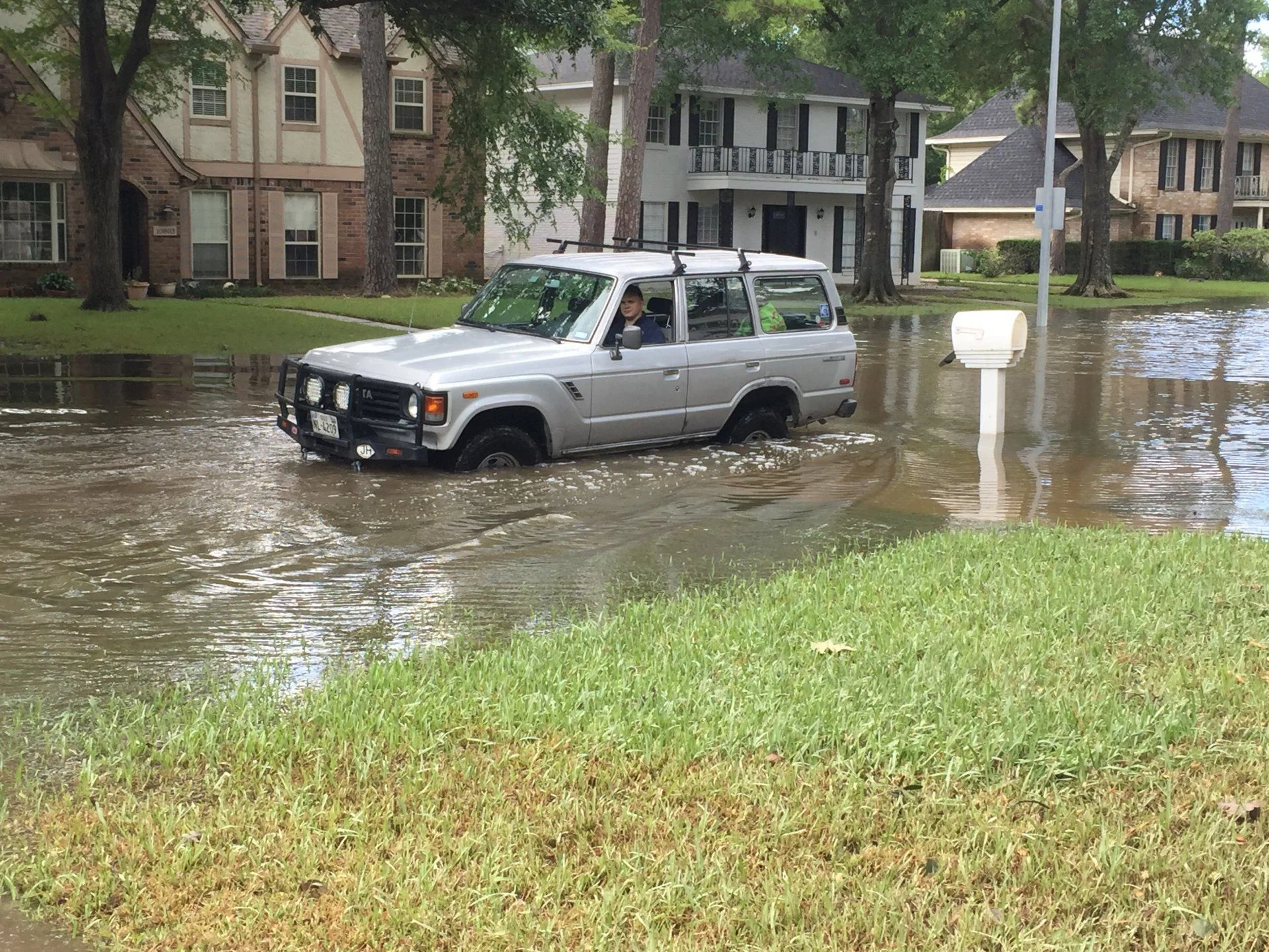

It flooded in Texas. My truck didn't care and I was able to help. I'm rewarding it for the awesomeness with an ARB breather kit and a knock off safari snorkel. I was able to go rescue a friend and his dogs and run supplies into bad areas with ease. It knocks out 3 feet of water with ease.
Still daily driving it and no intention to stop.
500 miles, a few tanks of gas and 13.8 mpg while holding 2500-2800 rpm. A good day and a super comfy truck, nobody complained

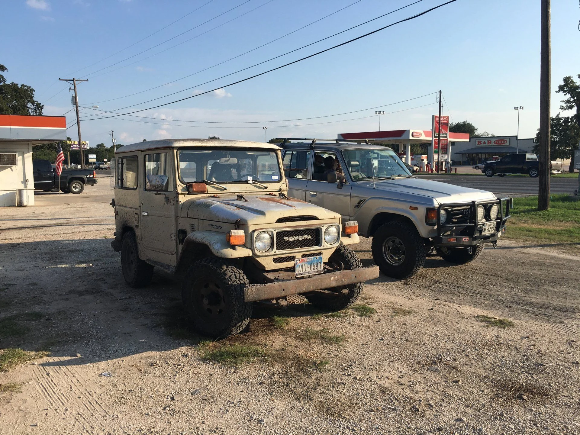

Also got to see @houstonfj40 and his PRISTINE 62.
This truck is begging for a 5th gear.
