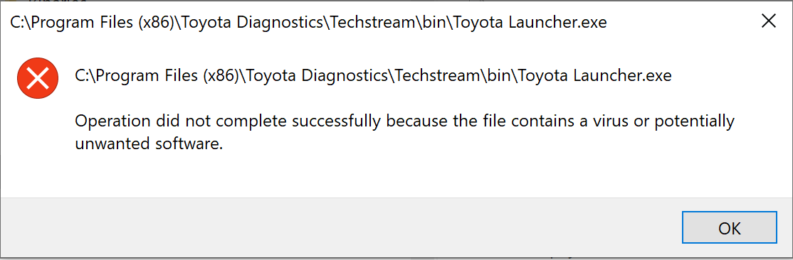

Anyone else getting the "Toyota Launcher" flagged by virus protection?
Open TechstreamPatch folder, copy and paste Toyota Launcher to C://Program Files/Toyota Diagnostics/Techstream/bin folder
Go to C://Program Files/Toyota Diagnostics/Techstream/bin, open Toyota Launcher
Windows says it has this virus: Win32/Ymacco.AA5C
VCX nano USB version, purchased from recommendation above. I can run Techstream, but it prompts for a key. If I try to use the patch launcher it quarantines it so it can't run.
Whenever you employ software that is "less than legitimate" you run the risk of Windows flagging it. I suspect that is the case here.
There are ways to move past this if you choose. Google is your friend...

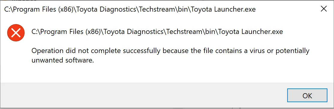

For win10 computer, turn off Windows security protection and delete antivirus.

Does anyone have a new version of the TechStream software? I have a patch from vxdiagshop and my computer is not liking it at all, it's saying without a doubt, the software has a virus/trojan.
It Trojans into the Techstream software. To be safe you could have a limited boot partition of windows that only has techstream on it. I have used it for 4 years on my laptop.
