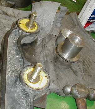

Side note: Drove the lifted 80 for a few days without correcting castor. The feel of the firmer new springs and shocks, and I never really noticed anthing wrong with the steering. Knowing that Christo Slee knows what he's talking about, I left work at noon Wednesday and went to my buddy Paul's to install Castor Correction Bushings...boy to they leave out MAJOR info on that install!!! And like Slee says, alot (most?) of people DON'T do it. He says that they usually are amazed at the way the rig drives once Slee installs the bushings for them...well, personally, I had my doubts about how much or what it would actually do. It took quite a while to do and luckily Paul has a 50-ton press. It took several tons of force to "pop" the old bushings out. We made a template for the orientation and bolts which basically simulated the mounting location on the truck itself by welding two bolts to the iron in the factory locations before removing the old bushings. Slee's similar setup:
Here you can see their jig with the two bolts, the bushings and the MARKS...the key is to get MAXIMUM drop. If you don't use such a rig, you will put them in slightly crooked or rotated, and NOT get max. drop AND put undue stress on them....thus the reason for the jig...anyway, I'm glad I drove it BEFORE and AFTER, to "See" and "feel" the difference the castor correction makes....it's HUGE. Like I said, it drove great (or so I THOUGHT) before...BUT---As soon as I drove off from Paul's house, and made my first turns, I noticed that the wheel turned more easily and returned to center on its own....I hadn't really noticed that it wasn't doing that before---mostly because I was so pleased with the quality and feel of the firmer OME ride. Anyway, thought I'd share....I'll add a pic later of the passenger side STOCK configuration AFTER the driver's side was corrected. The difference/angle is huge and alot more than I expected. I'm very happy with this OME J lift, and Highly recommend it.
