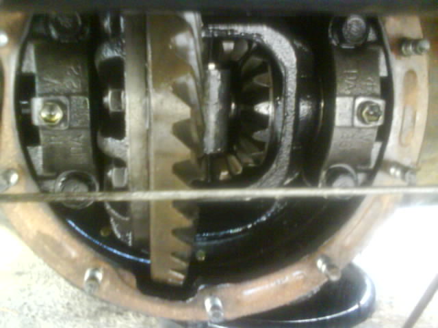

How hard is it to change a rear axle seal on a FJ40? Is it the same as the Tacoma? Do i need to press the bearing off to put the seal on?:wrench:Or can i just pull axle out and change the seal out? 1974 Fj40...
Piece of cake, not like the Tacoma though. Pop the rear diff cover, take out the center carrier pin to drop the c clip holding the axle in place then pull the axle and the seal is right there to pop out and pop in. Might wanna get some rear brake shoes if the seals were leaking you can bet the shoes are covered in oil and there is no cleaning them that oil soaks into the shoes. The good thing is you seal up the rear diff cover, change the leaking axle seals and get new rear brakes you won't have to go back in there for a long time :)
