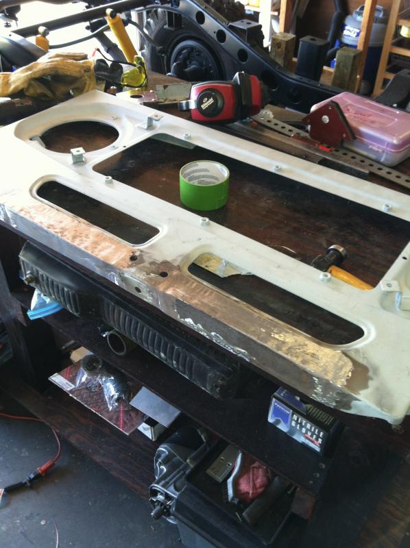

Halfway on the welds
Slowly getting it patched.
Welded and grinded
Now if can just coax these patches into a somewhat flat and smooth orientation I'll be happy.
Already looks better than my end result. :clap:

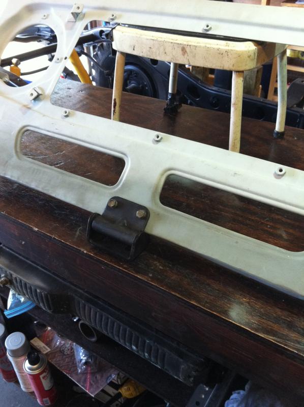

As well as patching my rust holes I welded the entire seam on the back and added extra captive-nuts for extra screws to hold the lower edge of my mesh:
:beer:
When I repaired mine [in 2000] I used a piece of 3mm angle. I saw the truck about six months ago, still driving, still rust free.
Captive nuts installed
I fabed a piece of metal to weld the captive nuts to. It aint pretty, but I'll never see it after it's back together. The next guy to tear it apart might scratch his head a bit though.
Windshield frame needs repair
These Windshield frames are not easy to come by, at least good used ones. I know Pachol (I think out of Georgia) makes aftermarket ones which S.O.R. sells for $750. So, I'm going to attempt a repair on this one. It's actually only rusted through on the bottom flange area. Everywhere else is perfect. I know the body shop guys can fix it, but that's almost as expensive as the aftermarket one, I'm guessing.
I agree
Your right Henry, and i think that's one reason those areas are so prone to rust out. The original configuration has those 2 layers of metal in that area. I was thinking that I needed to add back some metal for strength and to attach the captive nuts. All of that metal was rusted through, so I had to remove it. But when I look at the design, it's a perfect storm for moisture to collect. What do you suggest? It's not too late to go a different route.
Lostmarbles welded his seam there
Looking back at lostmarbles post. He appears to have welded the entire seam in question. Maybe that's the perfect fix? That's a lot of welding on thin metal; not my strong suit as yet.
The issue connects to the original Toyota design. Spot welding 2 sheets of metal together will always mean that the site of the weld, as welding will burn off any primer that was present, are sites where rust will begin. There's no way around that with spot welding.
I would seriously consider making a second sheet of metal as reinforcing, epoxy priming it completely and then attaching it to the back of the bib using automotive structural adhesive.

Weld-thru primer
I did use weld-thru primer extensively in that area, but I have to say now that using that particular design of metal may have been a mistake. It's something I had laying around, and meant I didn't have to cut a piece out of the 16 guage sheet. At this point I guess I could pump some epoxy in those holes to seal out moisture, or go the adhesive route which would probably work better.

I must say I prefer to have the inside of the bib "clean" so that no moisture can hang-up anywhere on it.
I'm not sure about Chris's adhesive idea. I know some are really strong. But they haven't been tested for 30+ years yet.
Before the addition of that piece of angle, your welding skills looked better than mine.
And overlap welding (like I did on my seams) is easier than the butt-welding you did but you still need to use the same technique (of doing spots spaced-out along the length and then gradually filling in the gaps while keeping the panel cool).
Epoxy
I may use an epoxy in that area to seal out the moisture. I'll wait until the final body work is done incase the metal has to move a bit. As far as the garage issue goes, I'd like to keep it in the garage, but it probably will live outside most of the time.
