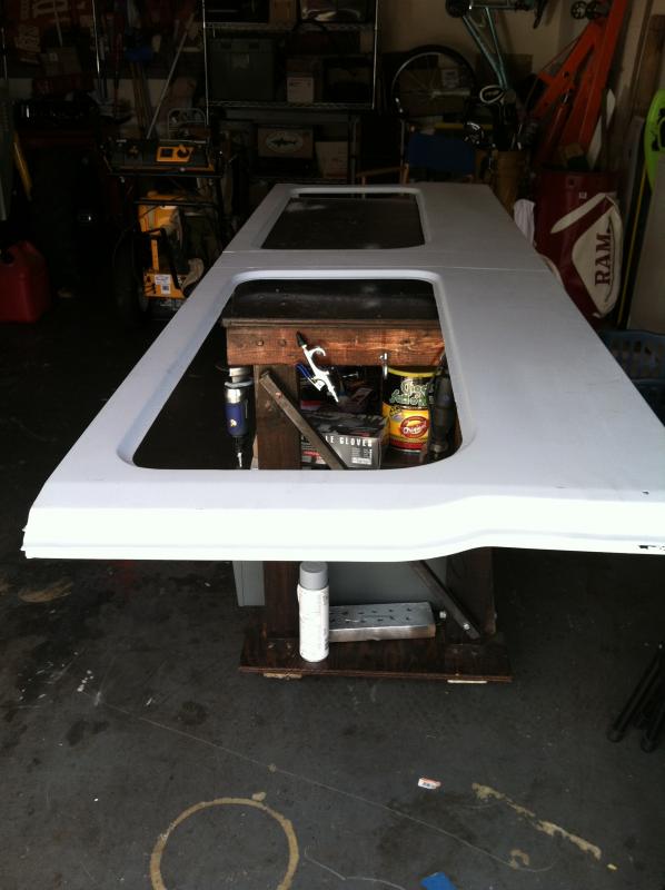

Will the fun never end? I brought the side sections home from the storage unit. If you haven't read previously,
I had these parts sandblasted and primered earlier. Now is time to fix the rust and prepeare for final paint.
These sections are 90% good and unfortunately 10% very bad.
Now I have to fix this bad metal. I'm not the expert on these complex types of repairs so hopefully people here on MUD will chime in with sugestions!!
What I found most ideal for patching areas like that was to locate a donor panel (in bad shape on other portions than you will be repairing on your good one) and section out the piece you need from the donor. For the rotted locator pin support area in your third pic, for example, that section of panel is pretty much the same regardless of which length 40 series you look at. If you can't obtain something like that, then patching in piecemeal is the other option of course. For the locator pin, if you cut it out make sure the replacement goes in the exact same spot. You can perhaps fit the panel to the truck's tub after a tack weld or two in that area and tweak the fit before proceeding to weld further.
Started on the rust again
I put out a call to the only local shop that restores Cruisers here on the Treasure Coast (FL). A place called Stoneys Extreme 4x4. I asked about some repair pieces that they may have laying around. No call back, so either they don't have any or they're busy. Either way, I started removing the bad metal on the first of the upper side sections. This area obviously is where the post connects the body to the upper half. The post had 2 rust holes, but otherwise it was OK. I grinded away the rust on the post and welded up the holes. Then I cut away the sheet metal that was rusty. Next I'll try to fab up the repair pieces. Only the outside part is cosmetically important, so that's where I'll try to be careful.

First post patch attempt
I took my time and decided to replace the entire post section. I was thinking of keeping my post to assure it was positioned right, and just replacing the sheet metal around it. But it looks like the replacement including the post will be able to go in the same spot. As long as got my measurement right.
Midway
This pic is out of order, but I wanted to show that it took a while checking for fit before I cut the body panel. Then it took a bit of grinding to get it to the point where I'd tack weld it up. Then I'll massage it into something my body guys can make look right. Hopefully!

Welded in the first post
Nice modification on the windows Troopy HJ45.
I got the first of many repairs done on this side of the hard top. Not the best welds but they should hold. Maybe a little more grinding or a little bit of filler will do the trick.
