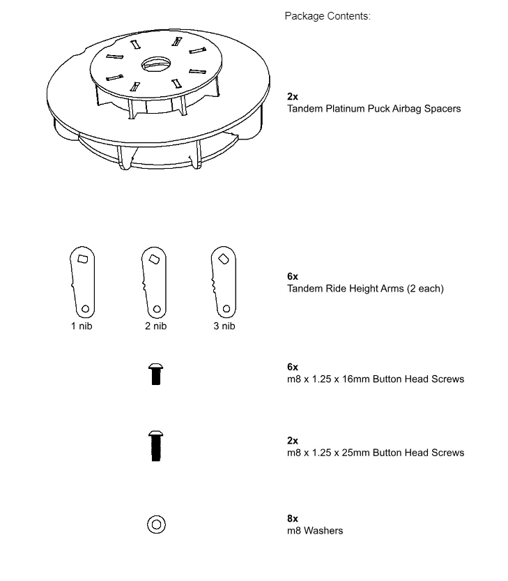

Contents:
We are currently only including 1 nig and 2 nib arms with the installation since we found the 3 nib arms to be excessive.

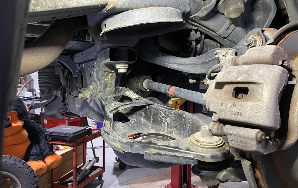

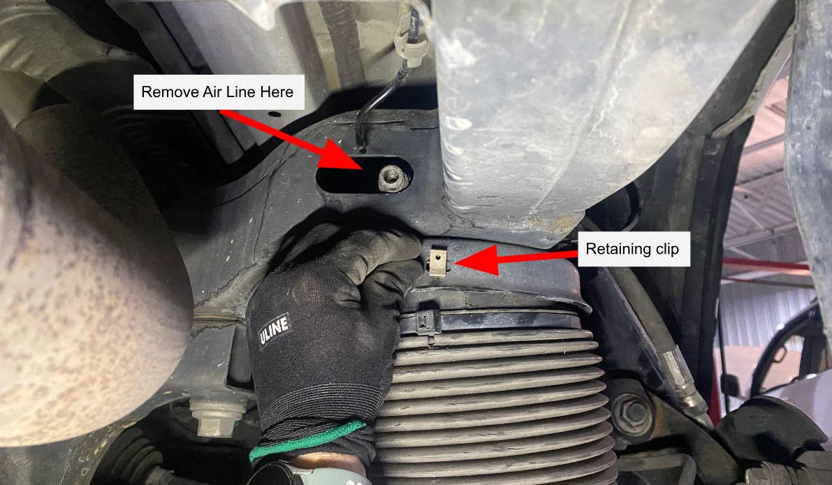

Step 1A. Remove the Airbags
-With the vehicle on a lift, remove both rear wheels.
-Disconnect air lines going to rear airbags.
-Lift airbags from bottom to deflate and compress them.
Note: You might want to mark the position of the airbag at the top with a paint pen to help with re-assembly.
-Remove the retaining clip at the top of the airbag keeping it from rotating.
-Rotate airbags to remove them from top mount on chassis.
-Lower airbag and remove it from the vehicle.

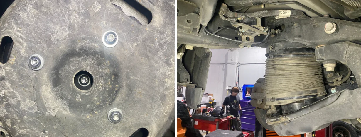

Step 1B. Install Platinum Puck Lift system Pucks.
-Drop the puck into the airbag pocket in the lower control arm.
-Rotate the puck until the three holes in the puck align with the three holes in the lower control arm.
-Install three m8 x 1.25 x 16mm button head screws (The shorter of the screws provided). The screws are installed from the bottom side of the lower control arm and thread into the puck. These secure the puck into the control arm.
Step 1C. Reinstall the factory airbag.
-Take your compressed airbag and lift it into the top airbag pocket in reverse of the removal process.
-Rotate the airbag to engage the retaining tabs on the top. The correct position will be when the fitting the airline connects to is pointing to the rear of the vehicle and is accessible. Note that it is possible to engage only one of the two retaining tabs which is incorrect. Be sure they are both engaged.
-Reinstall the clip at the top of the airbag.

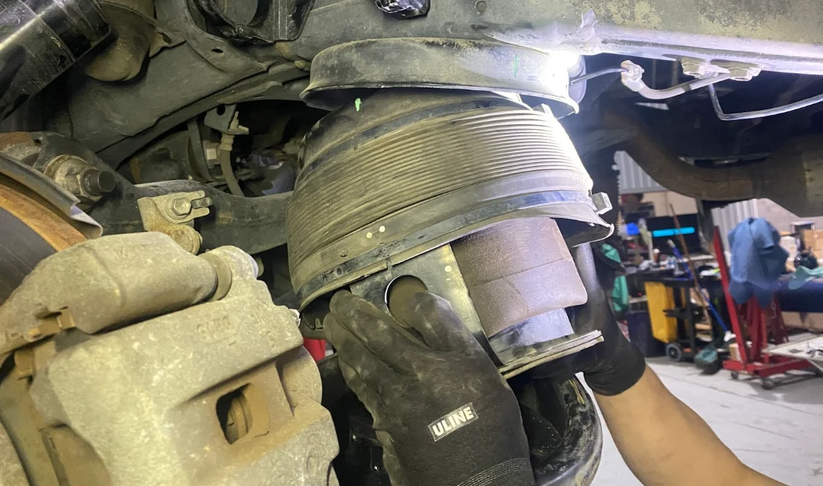

Step 1D. Connect the airbag to the platinum puck
-Pull down on the bottom of the airbag slowly to extend it down. The bottom of the airbag has a disc with a large hole in. That hole slides over the top feature on the puck and the disc should sit onto the matching disc on the puck. Sometimes this is a snug fit so make sure the bag is fully seated onto the puck.
-Now install the longer m8x1.25 button head screw in the center of the lower control arm. This connects the puck to the airbag.
-Reconnect the airline to the airbag.
-Repeat for the other side.

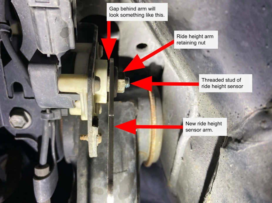

Step 2D. Install the Tandem ride height arm to the ride height sensor.
-Drop the Tandem ride height arm onto the stud on the ride height sensor. Make sure to properly engage the indexing shoulder between arm and sensor stud.
-Now you can re-install the nut onto the stud retaining the arm. The challenge here is holding the arm so that it engages with the indexing shoulder while you tighten the nut.
Make sure after them Tandem ride height arm is installed on the sensor that the arm is fully seated onto the indexing shoulder. There will be a small gap between the arm itself and the ride height sensor. If the gap is thicker than the thickness of the arm it may not be seated correctly. The gap should be similar to the image shown.

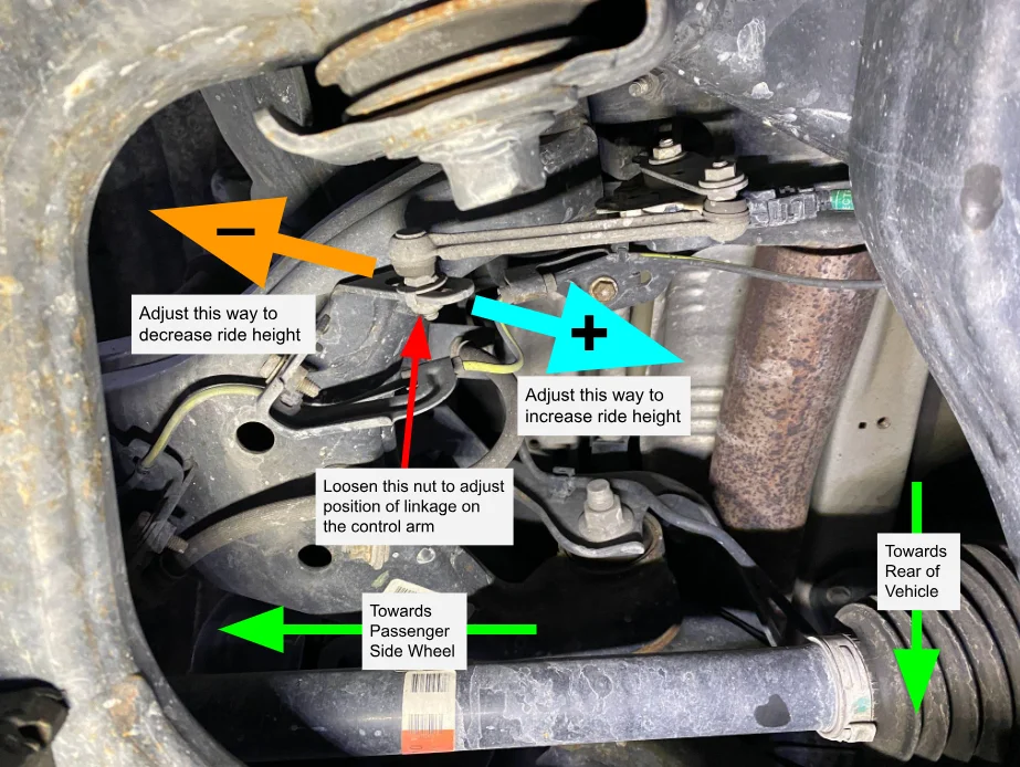

Step 3B. Adjust the ride height.
-Fine tuning the ride height is accomplished by adjusting the position of the ride height linkage on the upper control arm. The linkage connects to a slotted bracket on the upper control arm. Adjusting towards the center of the vehicle (away from the wheel) will raise the ride height.
-Try to get both sides into a similar position.
-If you cannot get the rear high enough or low enough you will need to switch to a different set of ride height arms.
