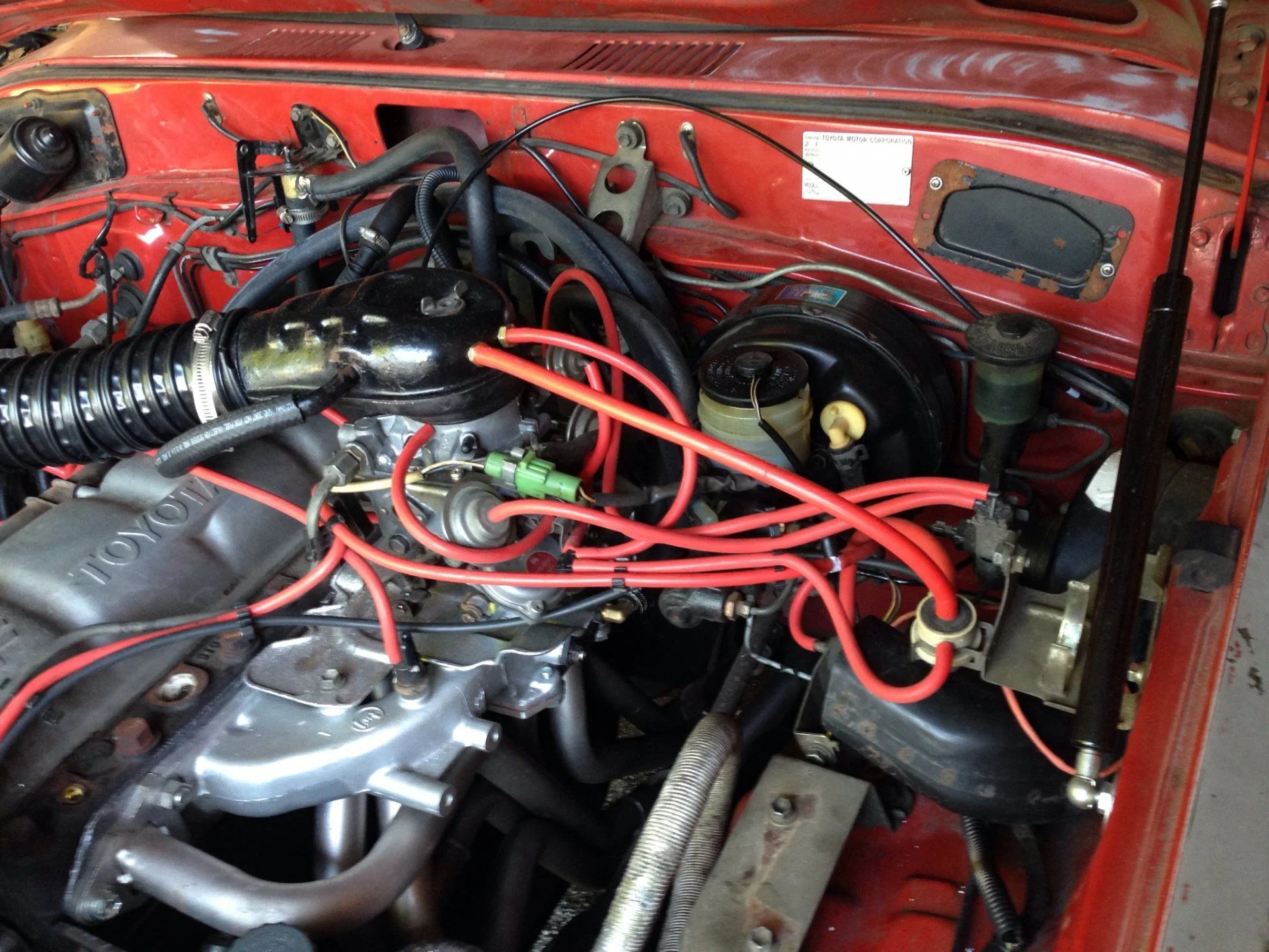

What route did you take? Different carb and headers? Trollhole carb? Other solution?
Rebuilt Stock Carb by Mark's Off Road, Dizzy recurve by Jim C, Tri-Y headers, 2.5 in exhaust with cat delete.
When I pulled off my air rail there were multiple pin holes in it which after removing had me wondering if there would have been any way to get it to run well. I also had a crack in my intake manifold, when I looked into separating them and having it welded, replace all the horn rings and having the surfaces machined flat the cost came out to be close with buying headers and having the mild performance gains so I went that direction.
There are a few photos in my media which might give you an idea.
Yeah, I have a hard time spending good money on this anymore. I've put $3k in it and it still doesn't run right. Mines got a rough body, so the way I try to see it is anything I do mechanically to this one is actually an investment in my next one. I'd like to maintain this one until my kids are gone and done wrecking my car's. Then (or sometime between now and then when the money is good) get one with a better body and use this one for parts.
It looks great!
Edit: I really like the orange vacuum line. It makes it easy to see what your working with and it pops in the pictures. Almost like you did it on purpose just to help people like me. Thanks!
I'm guessing that whole thing came in around $3k?
