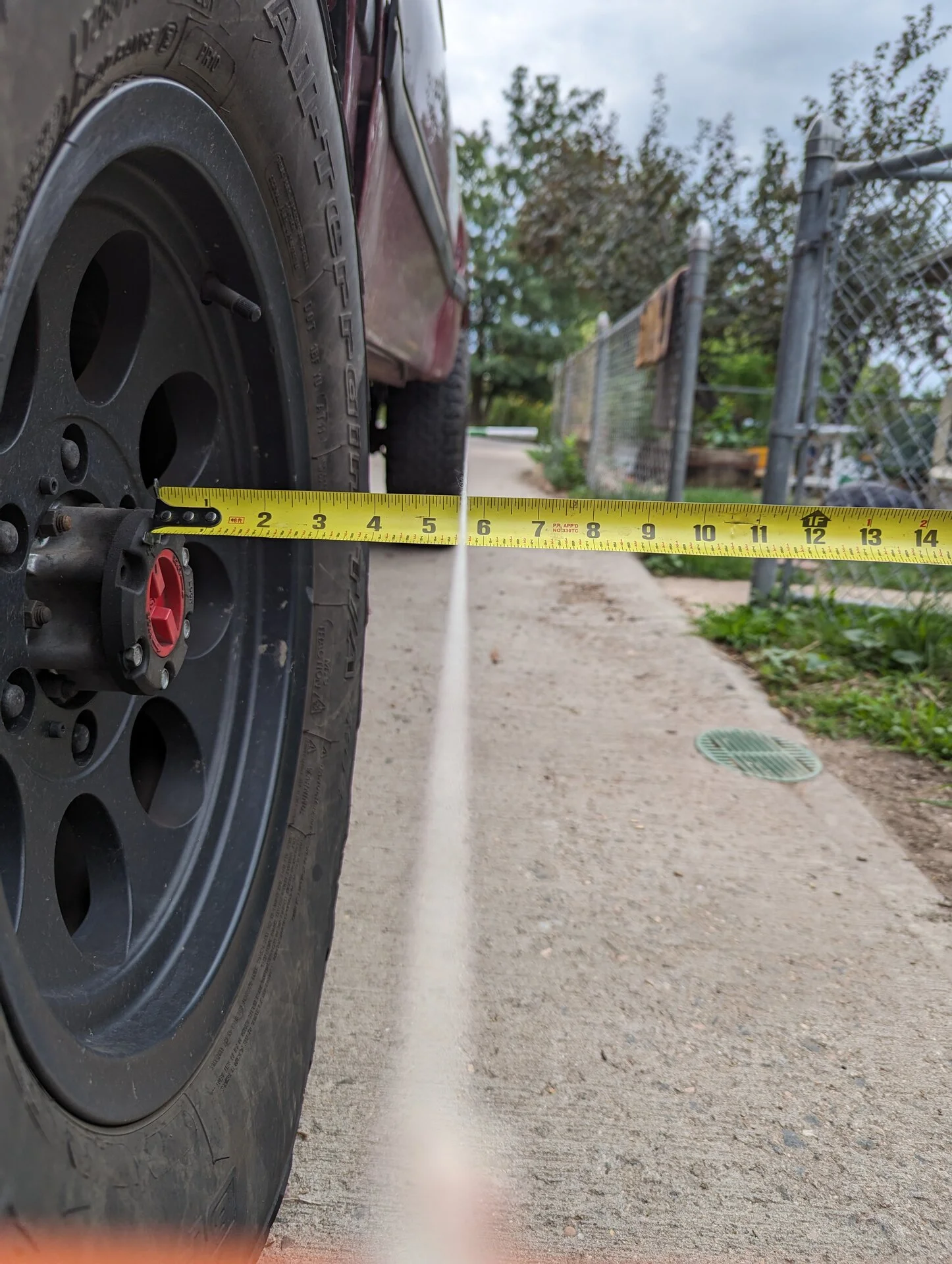

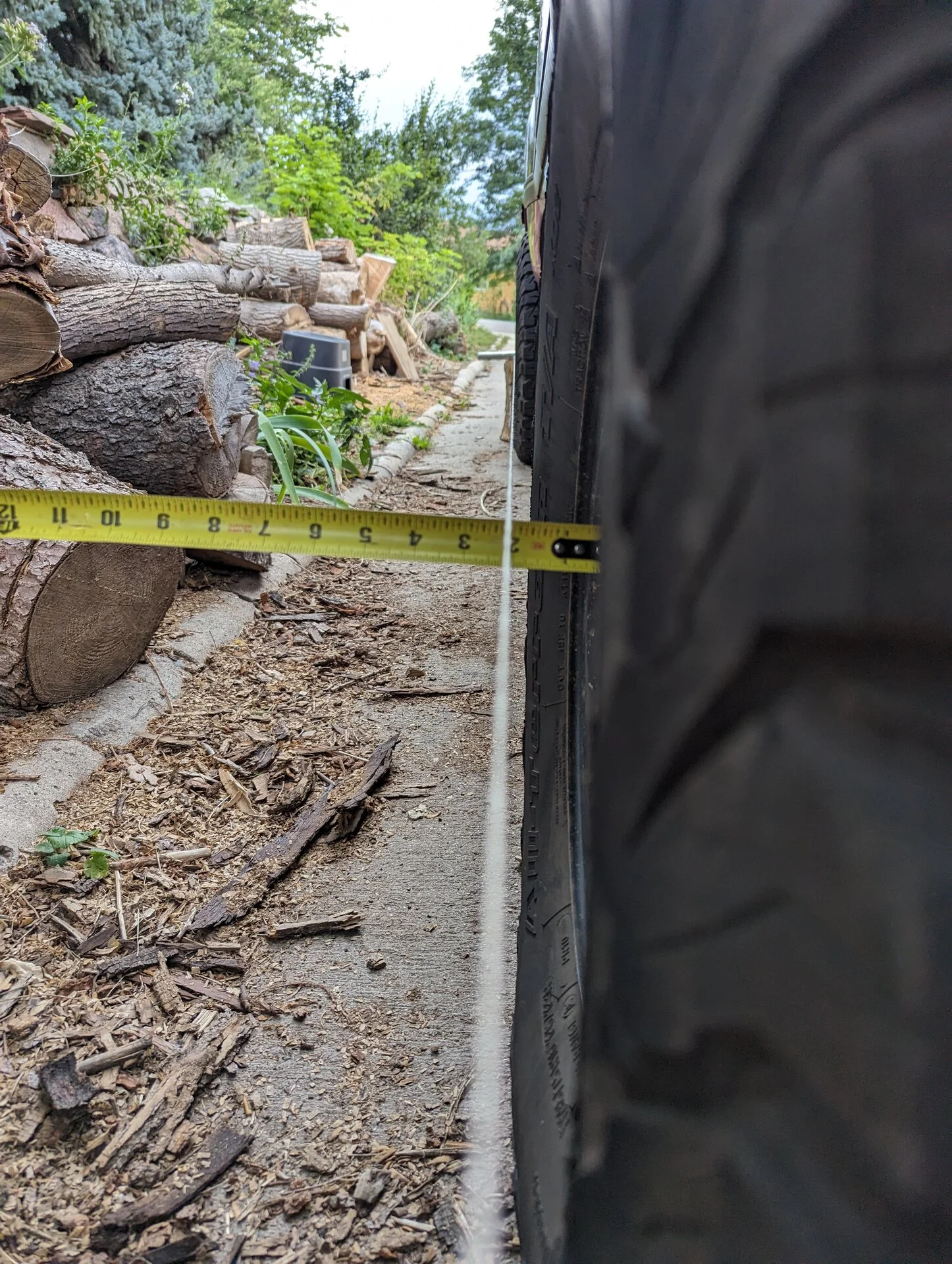

Hey guys,
I was just looking at my alignment and I pulled the ol' string method to see what the tow and camber looked like. It appears that the frame is bent, but before I get bent out of shape I wanted to see if anyone has some useful input for me. I've had this thing aligned several times over the years and no one has ever mentioned anything about it being so far off. I'm hoping I'm wrong.
The strings in the picture are leveled on the rear wheel.
I had planned on performing a solid axle swap with an 80 series front axle, but now I'm not sure I if it's worth the effort.
Take the current truck with the stock suspension to a reputable frame shop and have them pull the frame back into spec if your concerned… before you try to link the front or leaf spring it..
I had a T-100 for almost 12 years and always wanted to put an 80 series front axle under the front..do it!
The only true way to measure a frame is off the factory holes in the side of the frame with the frame machine bars up on the frame rack while measuring the cross points on the frame. If that don’t make sense take it to a reputable shop.. your rear leaf spring mounts and crap bushings could be throwing you string line off for instance…
this.
I don't think a string touching the tires tells you anything about the frame.
Before I did my SAS I tried the same thing and ran into similar results. I thought no way, I hadn't wrecked the vehicle and had no issues with it for 15k+ miles before that. Like a couple of the other folks suggested, it's very hard to measure without proper reference points and near perfect levelness.
I did my SAS anyway, utilized simple triangulation when doing it, and my truck runs very straight.
