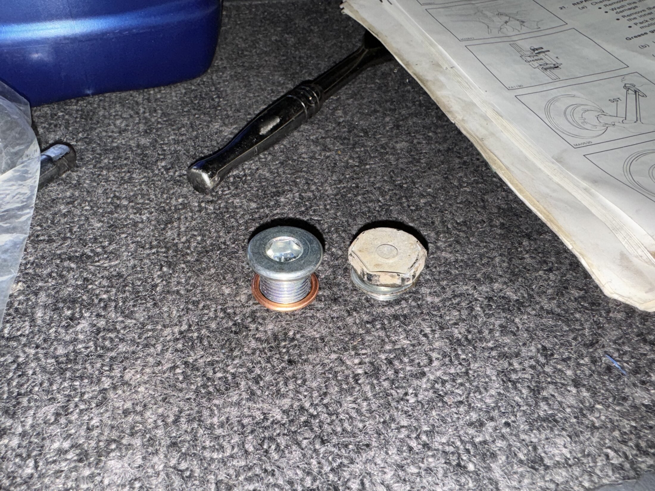

I'm about to weld a nut to my transfer case drain plug on my 91. Will need a new one after. Had this happen with the front diff a little while back and mechanics replaced the plug but even that new one seems stuck now too. In a thread about getting these bolts unstuck, someone recommended getting a hex style replacement bolt with a special washer. Is this a Toyota bolt that I can get at the dealer, and if so, what's the part #? If not, where do I get it? And what is the special washer? I'm looking for 3 of them, one for both diffs and one for the transfer case. I don't want to deal with these weird skinny flat drain bolts anymore.
Get a new one in the 10mm hex style, and a new special crush washer.
Disregard. Looks like it's 90341-18021 for the plug. Still working on "special" crush washer
I used 1215710010. Not sure it's special, but from memory it is what was used in what ever vehicle the hex style drain plugs were used in.
90431-18021 is great. Worked on t case and diff. Went to the dealership to get them (mistake) and they gave me the washers used on the t case and diff (they are, in fact, different.) I have the part #s for them if someone needs but I don't know which is which.

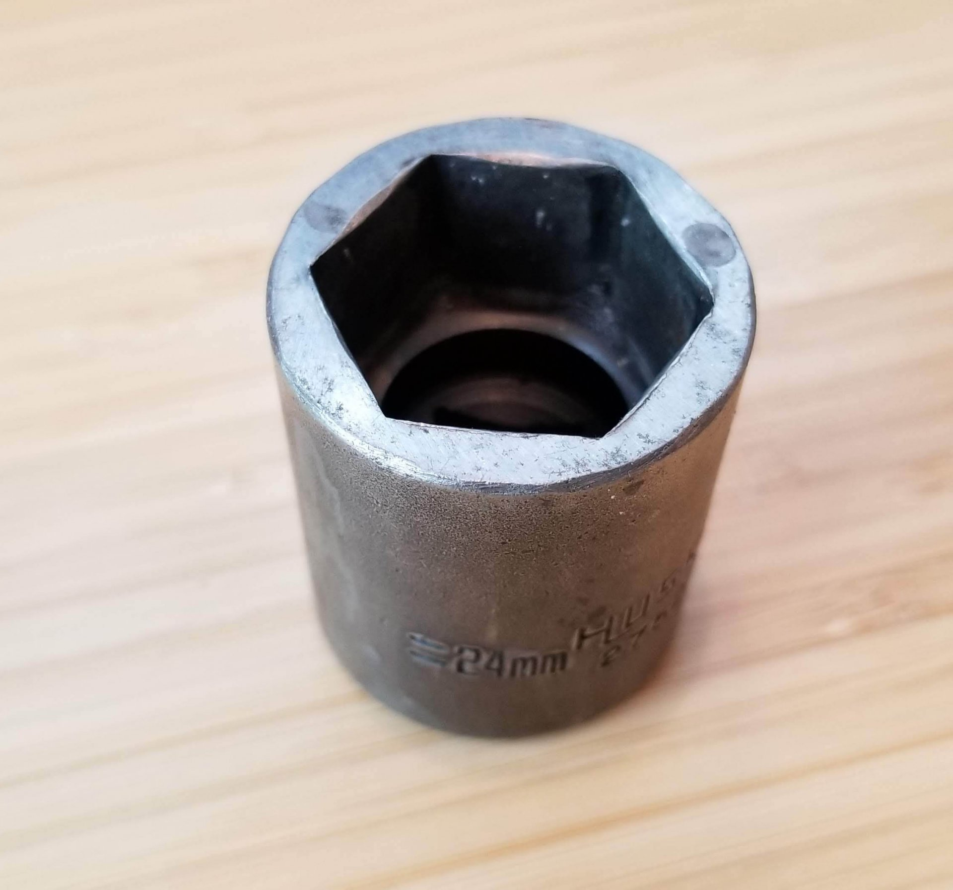

If you grind down the chamfer on a 24mm socket, it works really well for the fill plugs on the diffs and drain/fill on the transfer case.
I have the 10mm allen head drain plugs on both diffs.
The transfer case gets washers 90430-18008
The diffs get 12157-10010

All my 24mm sockets look like this
