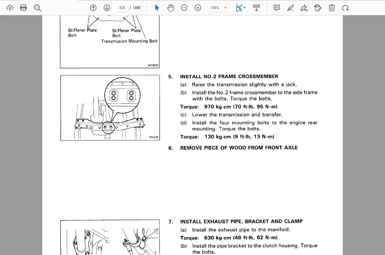

Snipped from my '88 FSM:
Yeah, that addresses those doesn't it?
The circled blowup refers to the smaller 9 pounders.
You'd think they could do a better job with some of these diagrams.
Hell, take actual pics of the real stuff...I think my dog could do a better job drawing some of these.
Thanks for all the positive input folks. The Marlin shoutout page was full of Ugga Duggas types LOL. But ya'all deserve a beer for sure. Tracked it down to a M12 1.25 pitch 50mm long bolt . Got spares for the trail (for me or others that may need it) 70 ft pounds of torque was the winner.
