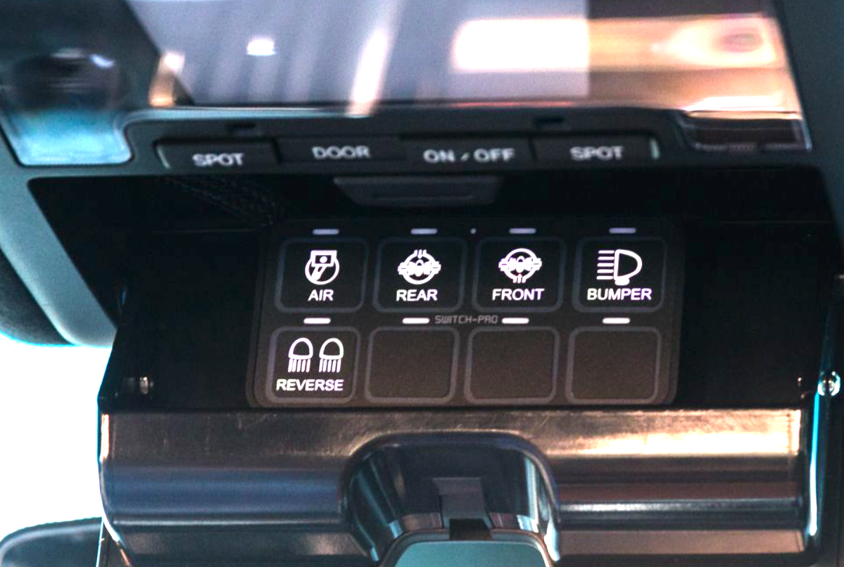

If you have a switch panel installed, where did you put it? I like to keep the stock interior look. Any ideas where to hide a switch panel if I had one that used a remote or app controlled?
It's stealthy but not line of sight from the driving seat.

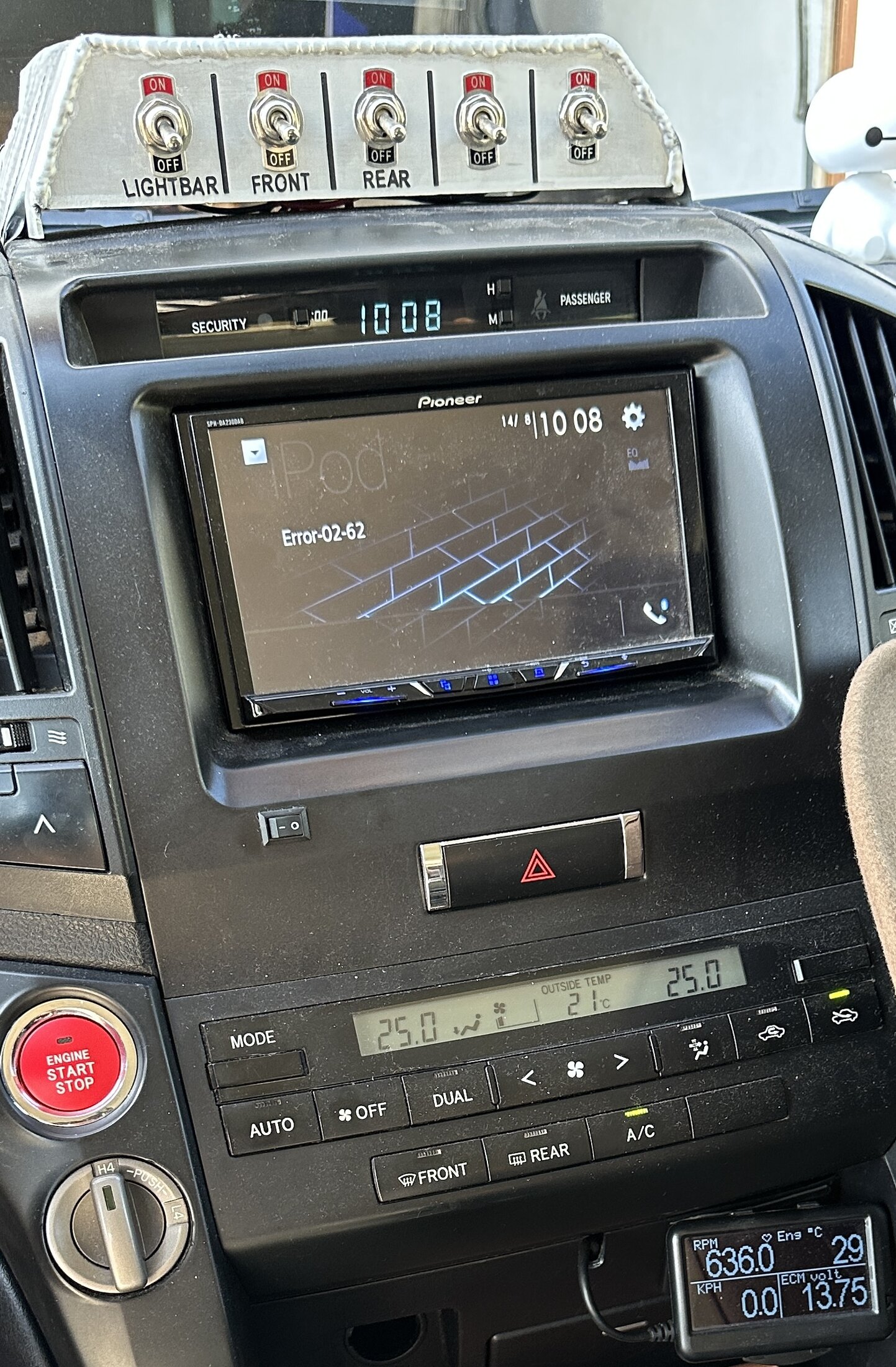

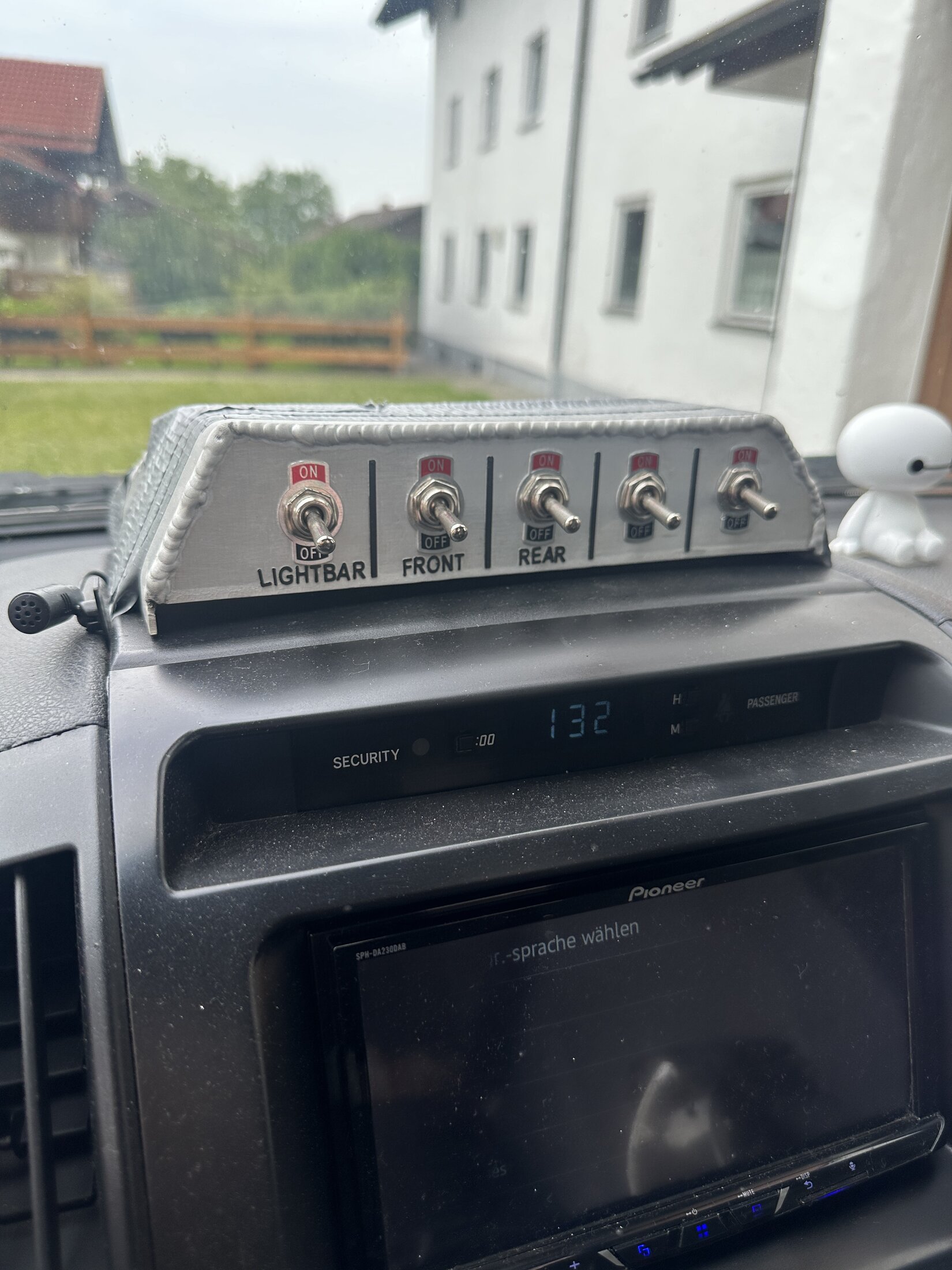

I just welded some aluminum, put some heavy switches into it and then taped it on top of my head unit because I was too lazy to cut it out nicely (maybe something for winter, I don’t know….)
Works like a charm and I like those heavy switches
This is super cool. Btw how did you change the head unit with the ac controls?

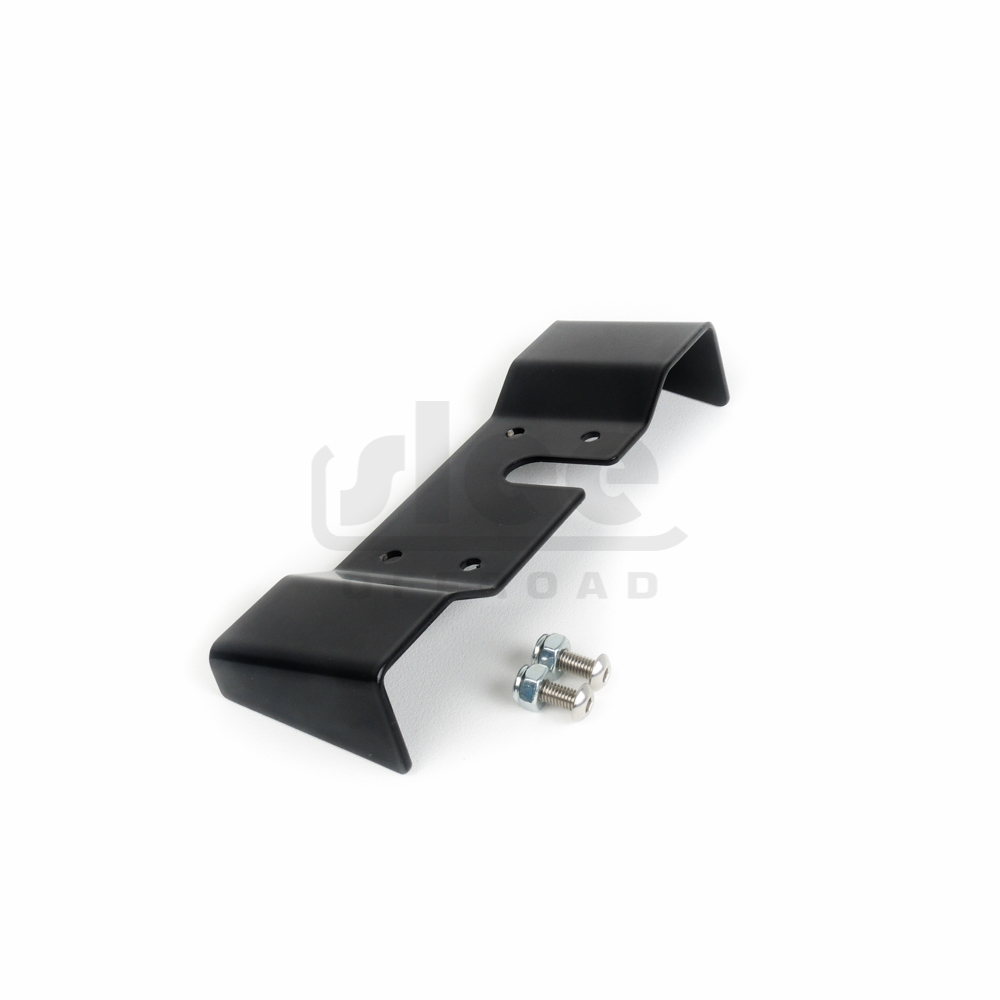

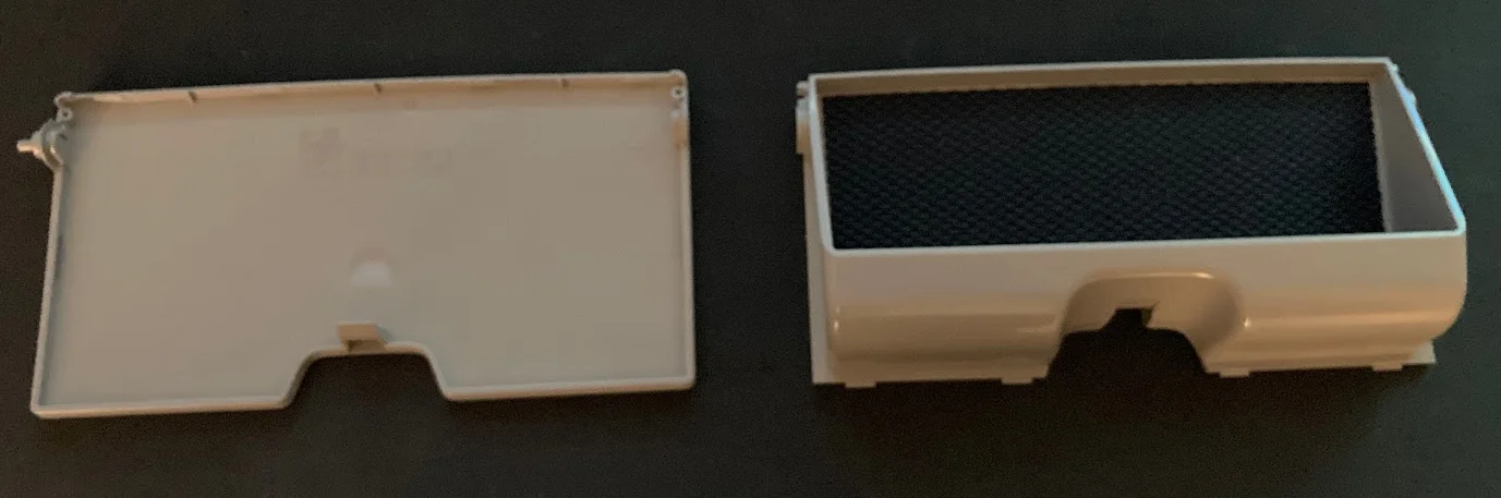

I made this awhile back for the auxbeam panel if you're interested...
My 200 is a GX trim and only had a radio/cd deck with a one row display (like the 70 series at that time) so no head unit with ac controls. Has a own ac panel.
I think the AC unit and the head unit merged together with the facelift right?
So I can put in whatever 2-din radio I want and only needed a trim panel with a slightly bigger cutout you can get from ebay for arounf $30. (the small switch is ma rear view camera….)
How about this?
As someone who wears glasses (both sun and regular) I personally don't that location for a switch holder. There isn't much storage room in the LC as it is and now you take away the only spot dedicated for sunglasses. Plus it is a two step process to switch it on and is still out of line of sight.
Ah that is nice. The first gen 200 US spec ones have it integrated into the screen, like the 100 series as well. I think the facelift have it all separated.
Oh Idk why I was confused. I thought someone made this for the GX not the 200, this is really cool.
Yup. I keep a pair of sunglasses in mine too. But the OP asked for something that keeps the original stock look. The glasses holder seems to be the best place to meet that requirement.
