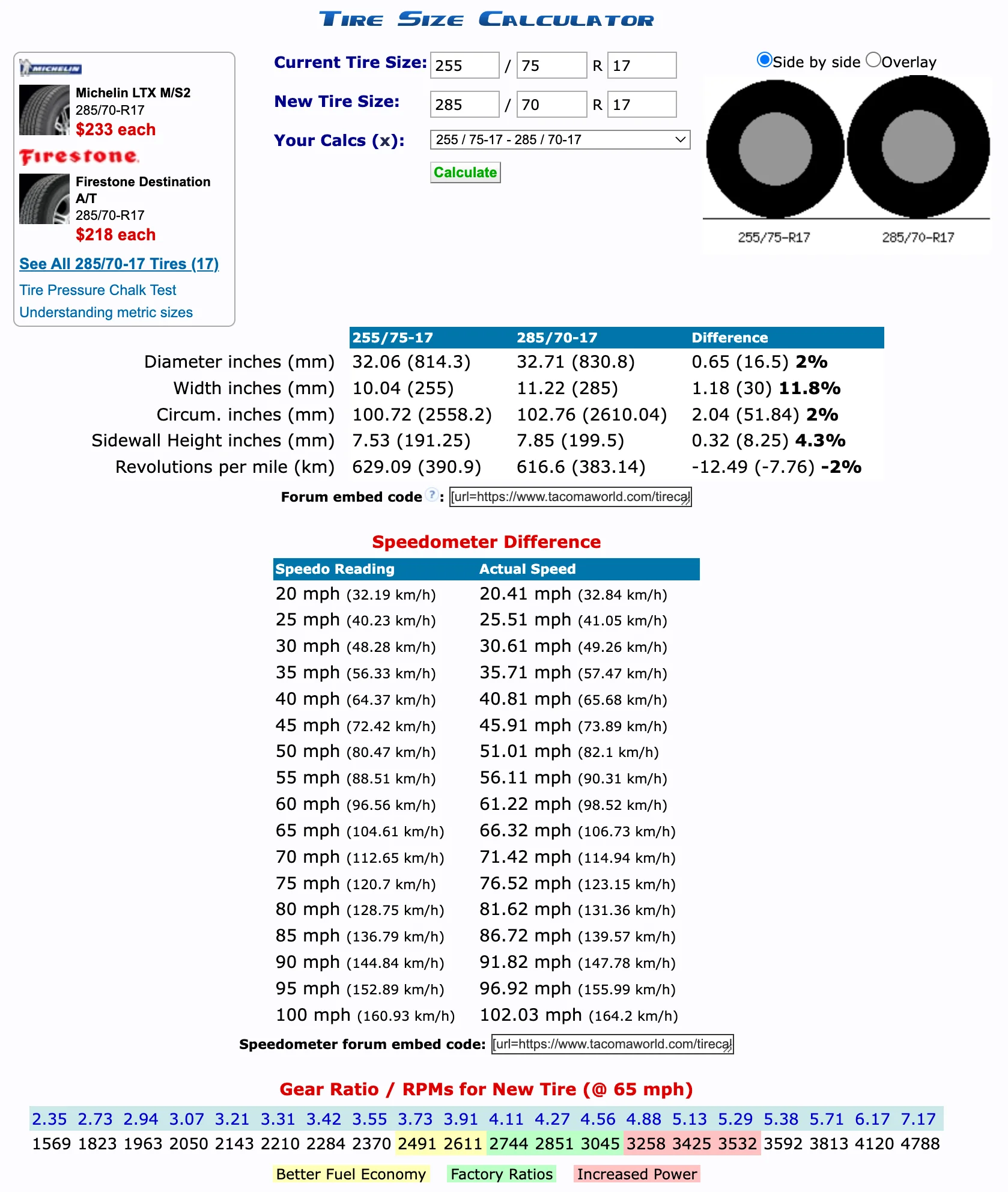

Should work in theory. Certain 32s have been stuffed up there. Getting a cheap "just get it home" 255/70R18 wouldn't really be out of the question if you wanted to mount it to a factory rim either. People get KDSS spacers to also help with spare fitment.
maybe I should have a used KO2 test fitted up there... cheap insurance compared to my unusable OEM spare for sure.
thoughts? 2% ain't bad.
.65 / 2 =.33 or roughly 10/32"
That's like the difference of a worn tire and a new tire on the same axle. For something just as a spare that's more than usable.

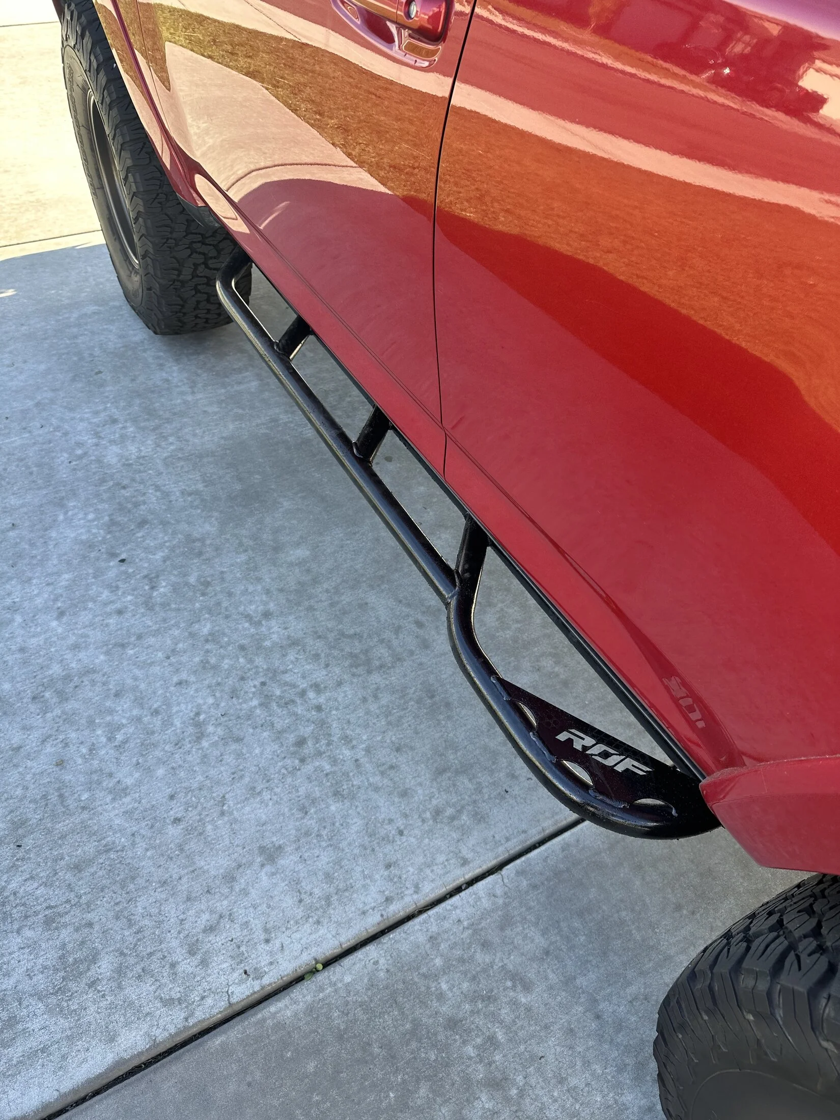

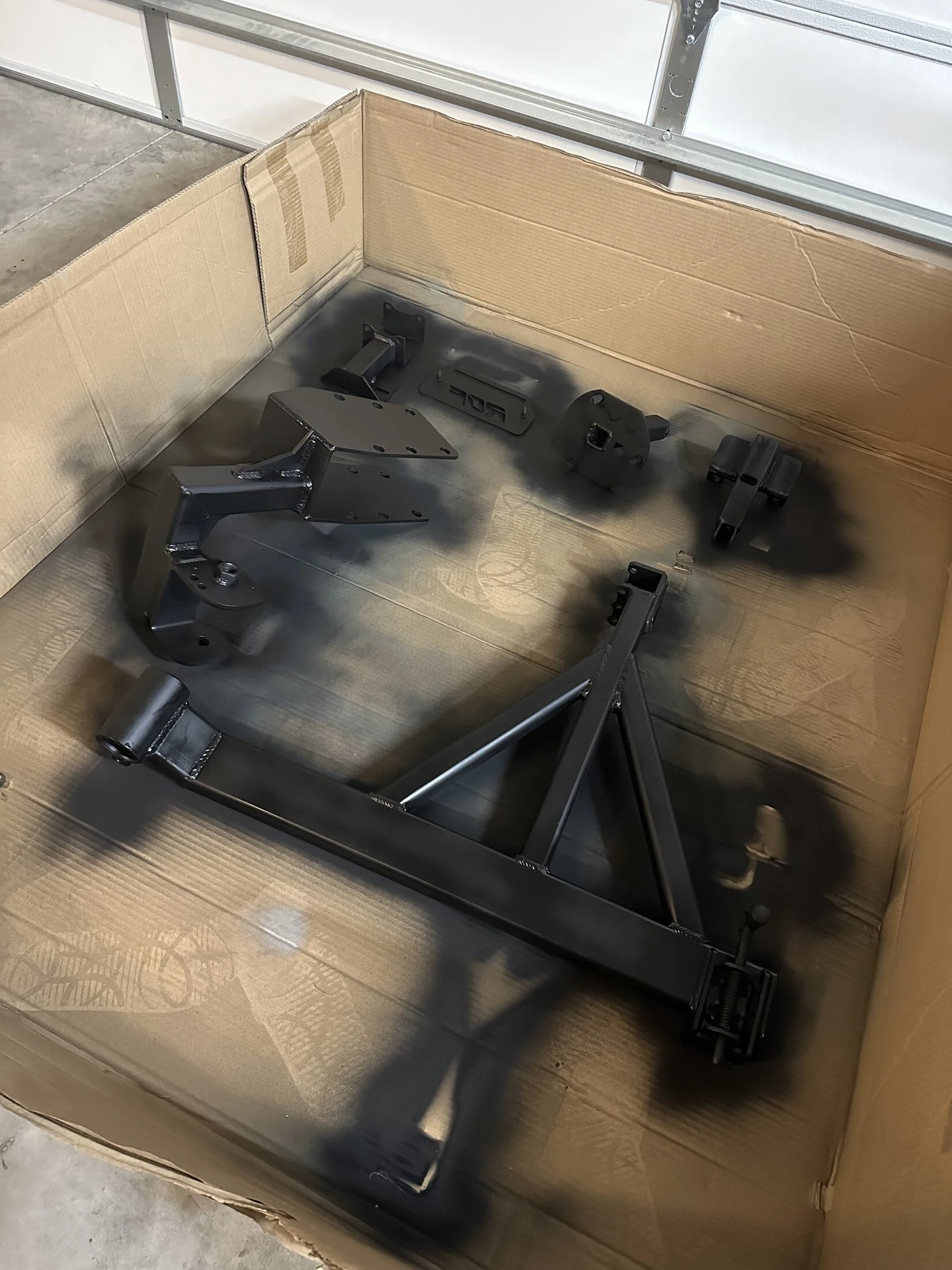

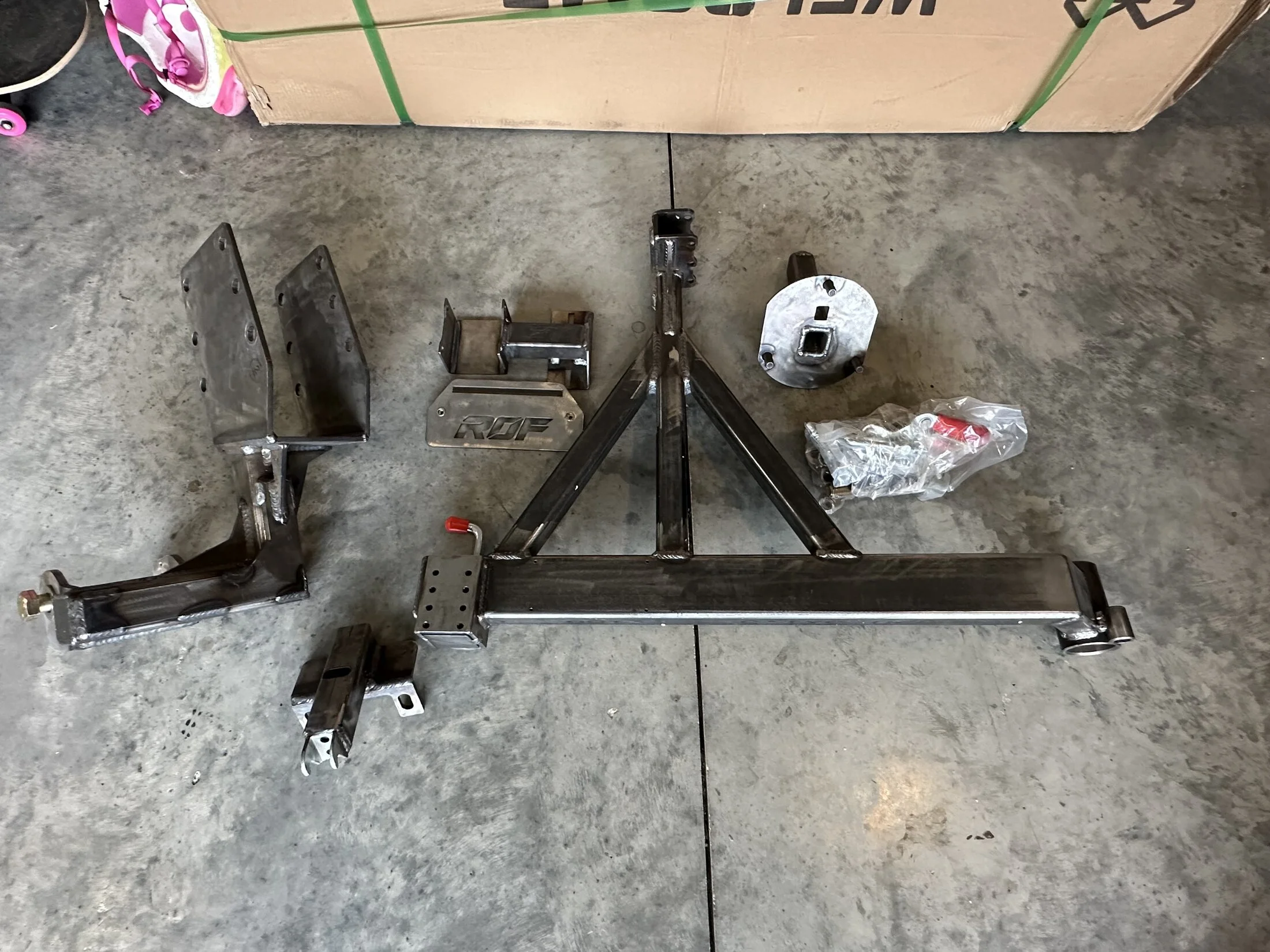

Sliders got painted and installed this weekend. I’m going to prep and try painting the tire carrier during the week but won’t be able to install it since we’re gone next weekend.
Also, aren't you getting some weather up there right about now? Kills trying to paint in cold weather.

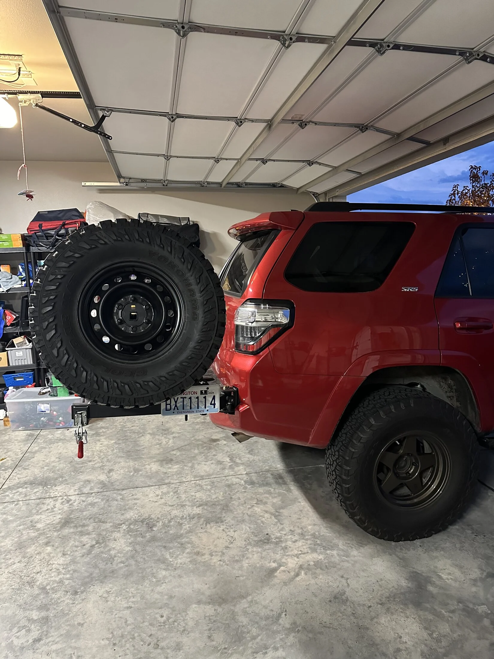

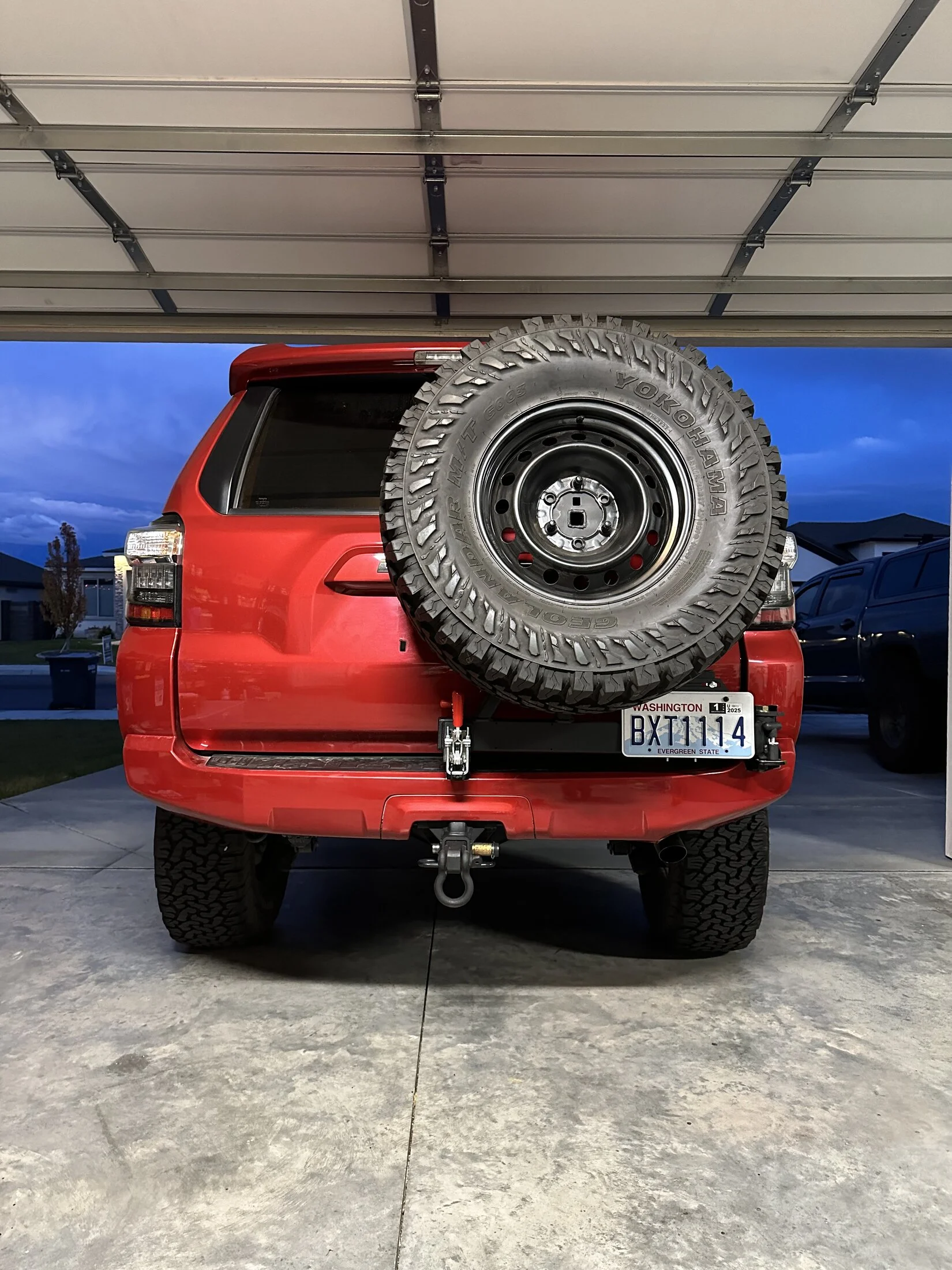

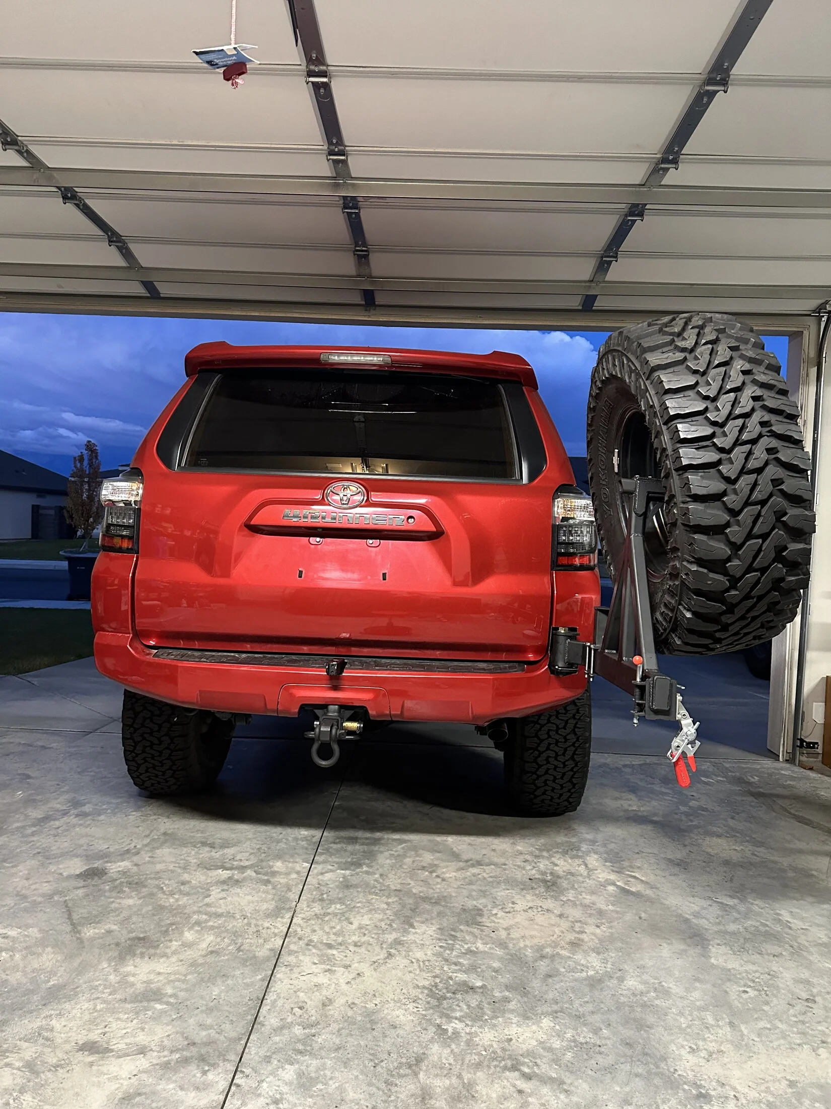

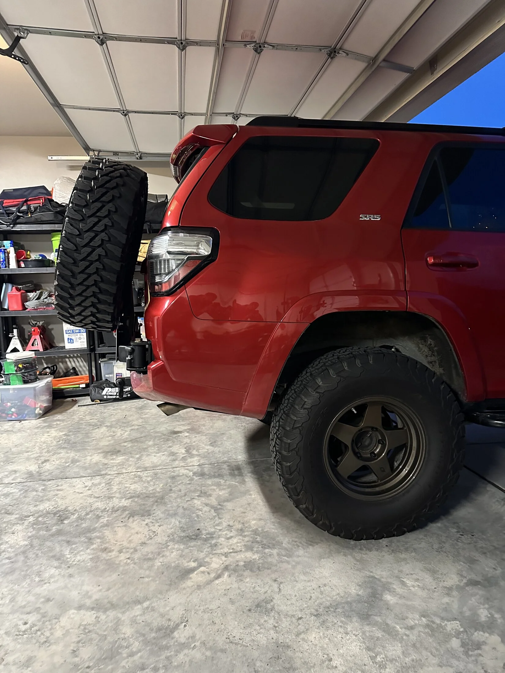

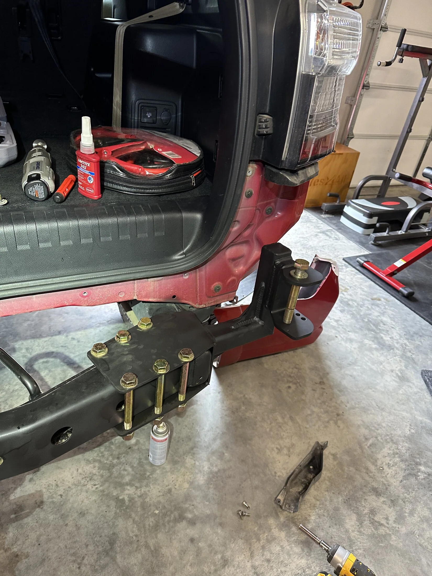

Installed yesterday. Cutting the bumper was sketchy 🤣. Overall it was a simple install and looks clean. I messed up at first by pressing the bearing seal too far in. I reached out to ROF and they responded right away and told me how to fix my small mistake. Highly recommend them.
