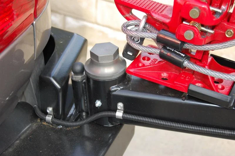

I have the Slee bumper with both swing outs. And it does add a couple of steps in order to get to your rear cargo area. However it does move your spare from underneath to a safer location, as well as giving your Hi Lift storage and a ladder so your kids can put the surfboards on top!
It also comes with a two position locking pin. One position locks the arm in the closed position in case you forget the latches, and the other locks in the open position. In the photo the black ball to the left of the spindle is the locking pin.

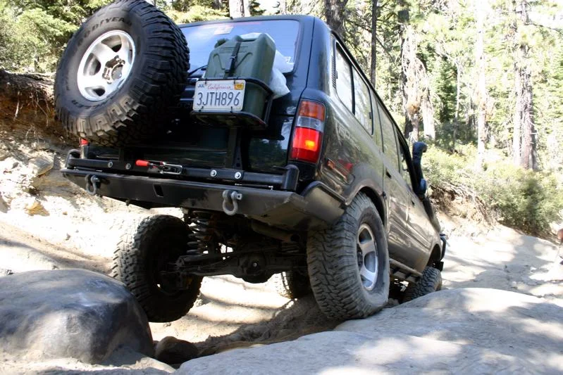

Hate to ask, but do you happen to have a picture? I saw it in a picture but it was from a distance and couldn't really see it that well.
thanks

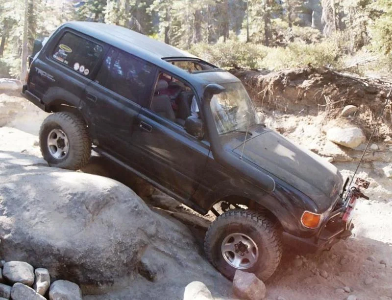

Here are a couple pics of my 80, but Luke's 100 bumper is very similar. Both require cutting off the rear crossmember and about 4" of the frame rails. Which, for a wheeler, is a good thing IMHO. Helps improve one of the major shortcomings of the LC wagons: fat rear ends.
