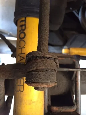

Hi all,
Project in the next few months is to replace the bushings and links on front sway bar. See attached photos.
It's an '87. OME lift (thanks, Mudrak!).
For parts, thinking of using $OR, with the extended links.
Page 102 Land Cruiser 60, 62, 70 & 75 Series Suspension
I have read a few other posts on replacement, seems relatively straight forward. It looks like I may have to cut the link in order to get the upper off given the rust.
Any other thoughts/suggestions for making this a relatively pain-free job?
Thanks!!

What I did may not be the ideal way of doing it but it has worked for me. Cut off that old bolt and scrap those bushings, get some universal bushings at any auto parts store, class 8 bolt from a hardware store and cut a steel sleeve to fit around the bolt for the length you want. I had a hard time finding links that were the right length, everyone wanted to tell me the ones I had on my rig were the wrong size and their computers were right (don't you hate that?
Anyways, just my 2 cents. Makes for a really cheap and simple replacement. Personally can't see any adverse effects.
