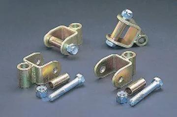

Aside from running all OME parts for example (coils, shocks, TBs) I want to know if this arrangement would work on my rig:
- stock shocks in all 4 corners (non-AHC)
- shock spacers for AHC mounted to them to “extend” them
- OME TBs
- new rear coils (Eibach, Ironman etc.)
- diff drop bracket
- stock UCAs
Would this combination work? Are there any rigs using these spacers with a non-AHC suspension?

I installed these shock spacers on my 1.5 inch lifted AHC and I experienced precisely zero difference in ride :D
The reason why the AHC strut spacers were made is to reduce the pressure / load on the shocks after the height level link sensor is shortened (lifting the vehicle a little). The F&R dynamic/AHC shocks share carrying the load of the truck with the torsion bars; whereas on a conventional LC (non-AHC suspension system) it’s just the torsion bars that carries the weight of the vehicle and the shocks control the damping and mostly the rebound the torsion bars and the rear coil springs create. So using the above mentioned stock shocks will do as it has enough length even at full droop.
