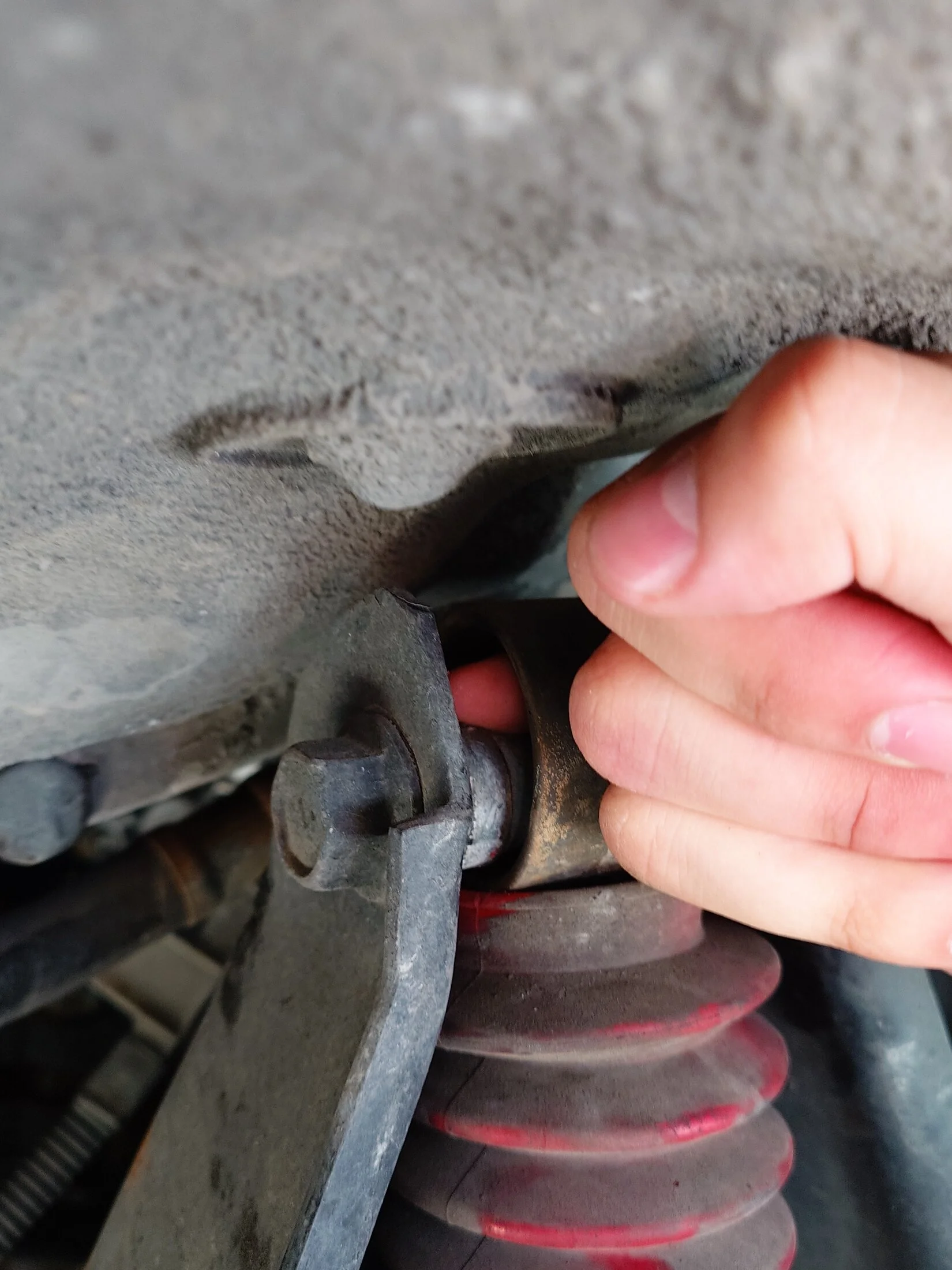

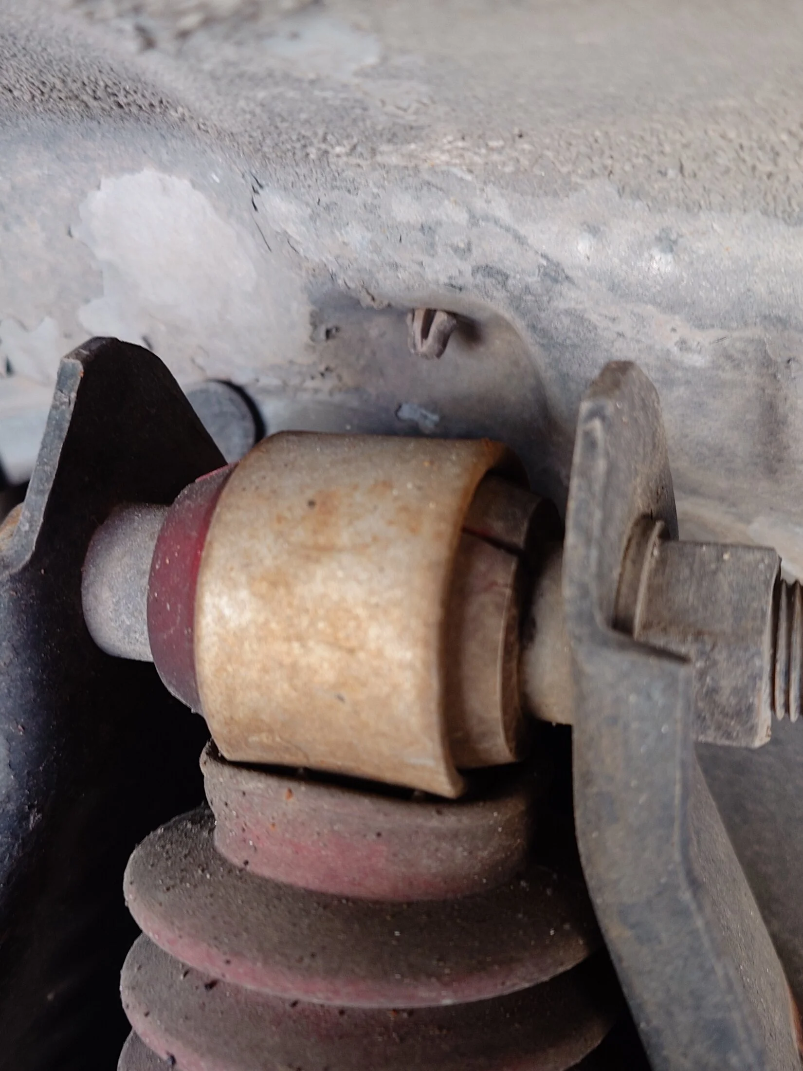

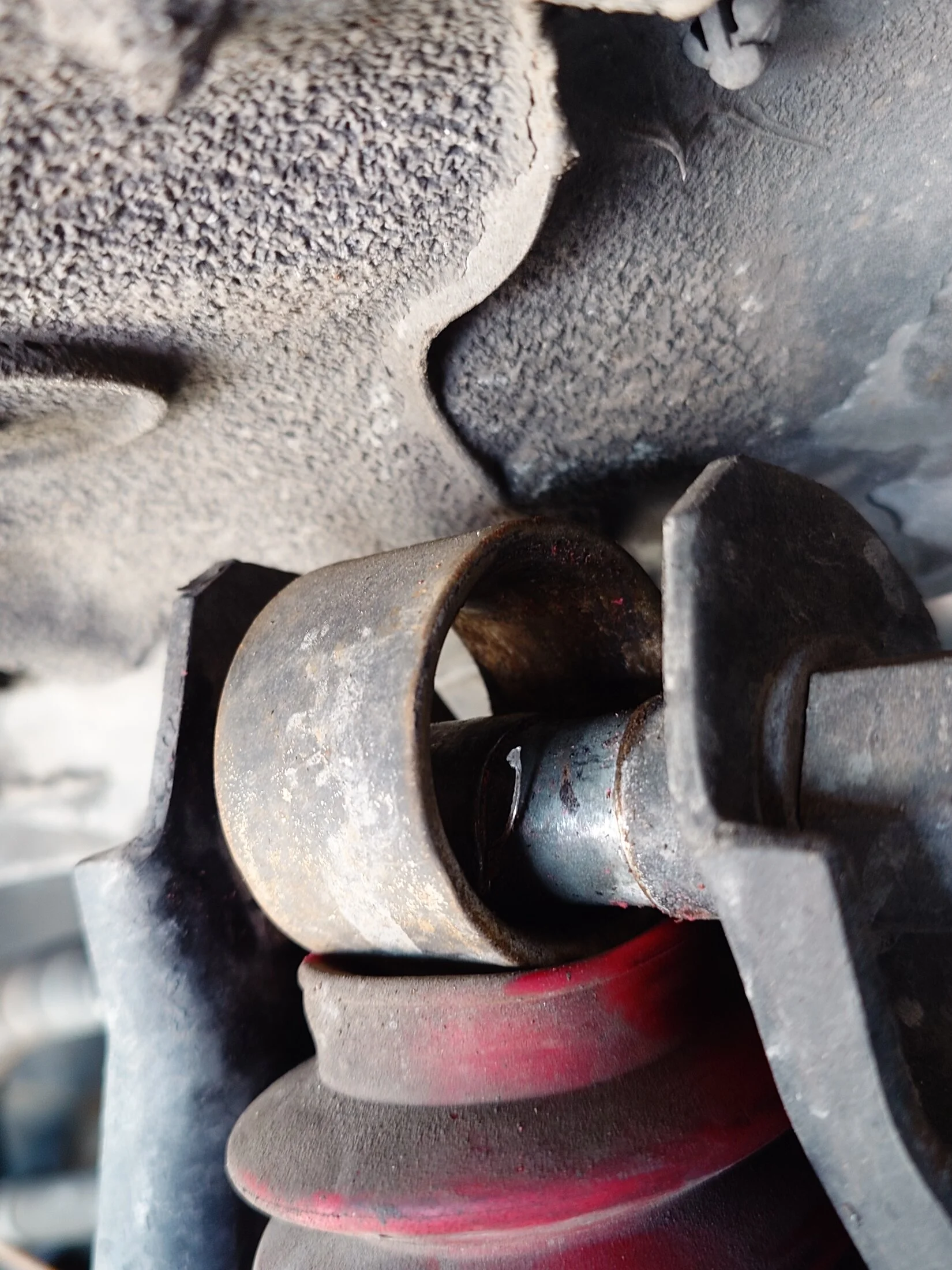

My suspension bushings are shot and I don't think my fingers is supposed to go through one of them. What suspension kits do most use here? I'm looking for a kit that's close to OEM. I don't think my finger is suppose to go through one

Not sure you want to wait too long sans shock bushes though.

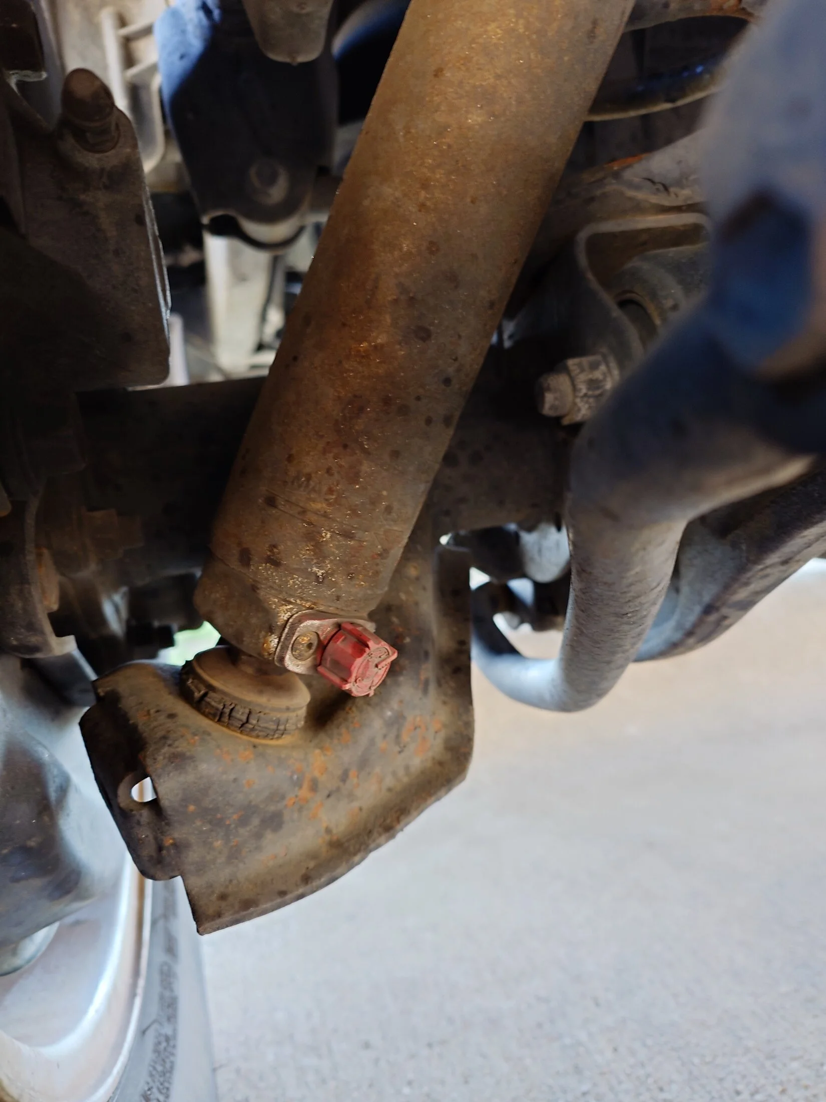

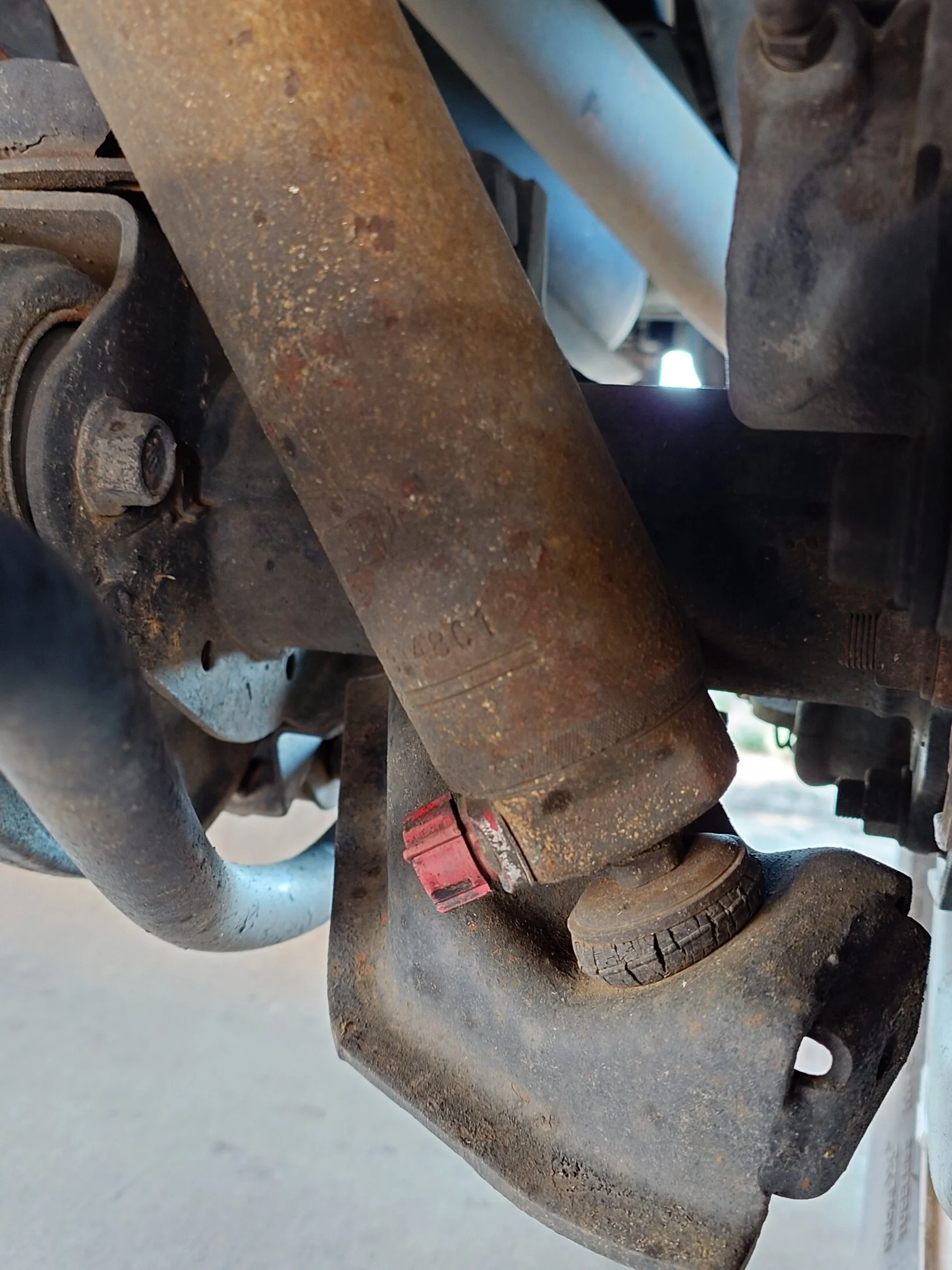

You're just looking for new shocks, not a full lift (suspension) kit, correct?

OEM shocks should be readily available for his vehicle (I will guess KZJ78, and probably based in Okinawa based on his Japan location). It just doesn’t really make sense for someone in Japan to buy OEM parts from an American. :)

I went dobinsons too bit cheaper than oem. Pretty happy. Your shocks at the very least need changing for sure. I shudder to think what the rest of your rubber is like!

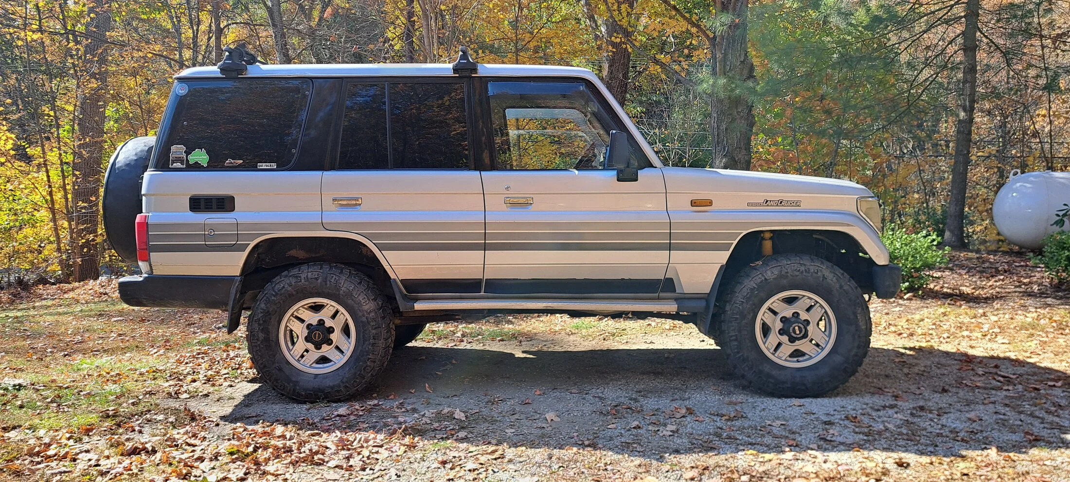

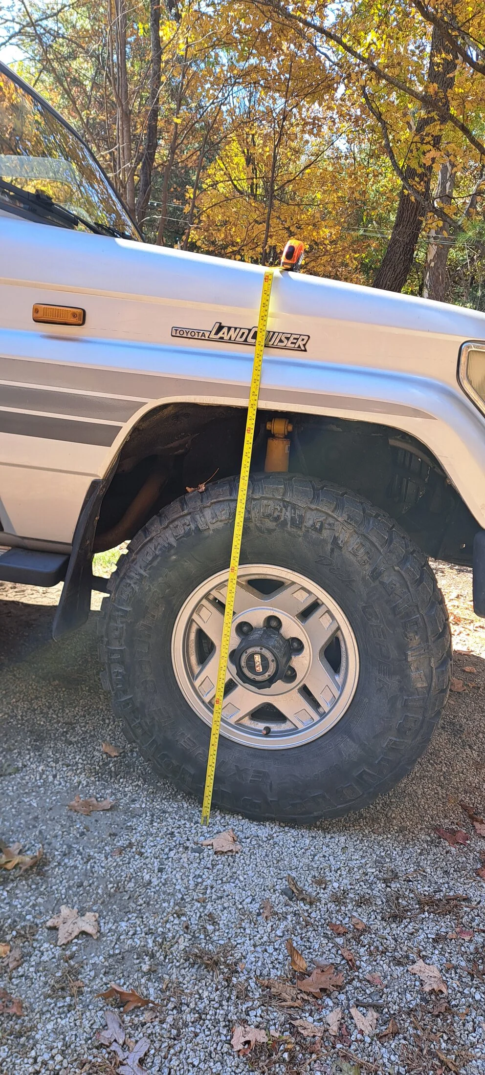

I have the 60 mm (2.5") on my LJ77 and I like the ride (as well as the lift).View attachment 3702425
If you don't mind, do you have a level ground profile pic? Curious to know what is the height from the ground to the bottom center of wheel well and what size tires? TIA.
Tires, Dick Cepek 255/85/16
