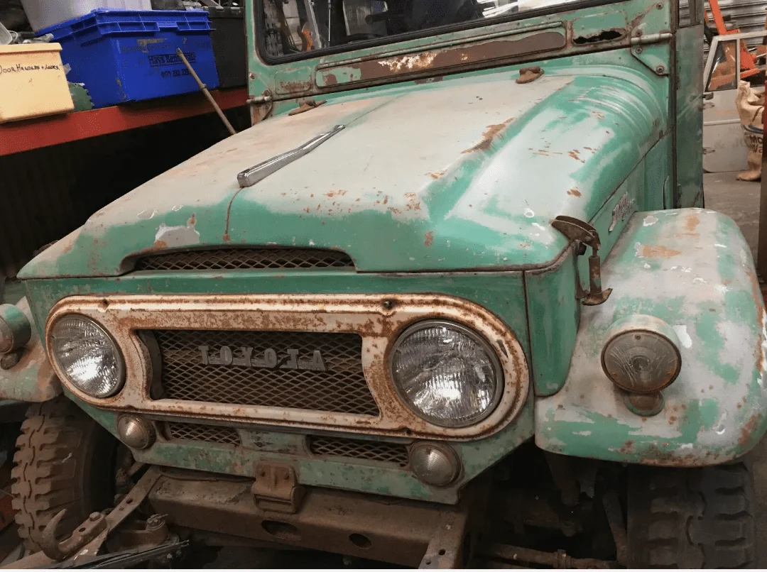

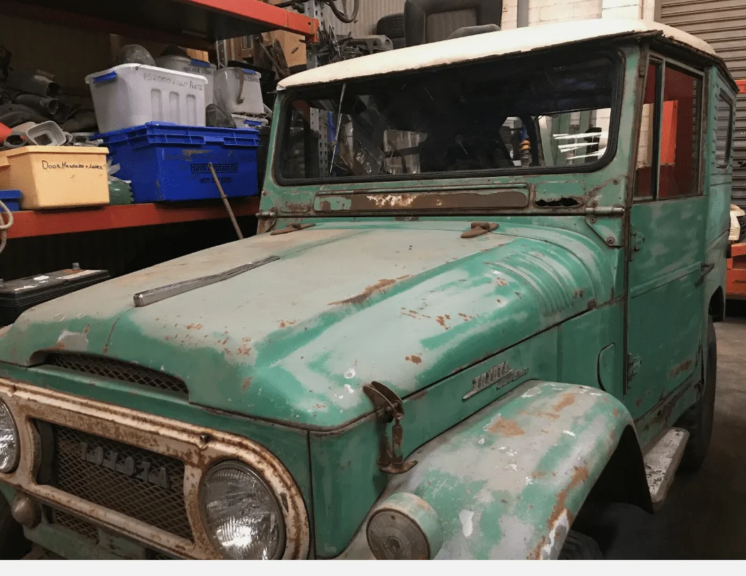

So, I am new to Mud as a poster but have been lurking on and off for a couple of years. Briefly, I have a few 45's, a 47, 43's and 40's, in addition to later Cruisers up to new and other vehicle brands.
I recently bought this seemingly unmolested numbers matching '64 Cruiser from a guy in Australia. I live in South Africa so I get to wait a few months to see the new addition to the family. Only crappy pictures I have to go by at the moment but at least something to gawk over.
There is some rust but not too terrible it seems.
While I know the later J4's quite well, I am not the greatest expert on the earlier ones so would value input on correctness, etc.
I have bought a bunch of NOS/original parts already but will likely keep this as is just make it fully functional.
Very nice looking old FJ40. The amber lights added to the back were a requirement in Australia. Sometime in 1964 Australian market frames were redesigned to include a rectangular tail light with amber lens on one side. Prior to that the amber lights were a add on. Seen a few style of these add on light which makes me think there were installed at port in Australia. Seen the same thing with reflectors on the FJ25/FJ40. Some time in 64 the reflectors were made by Koito and installed in Japan. Prior to that US made reflectors were added port. Who made the amber turn signals on the back will be a good clue were they were installed.

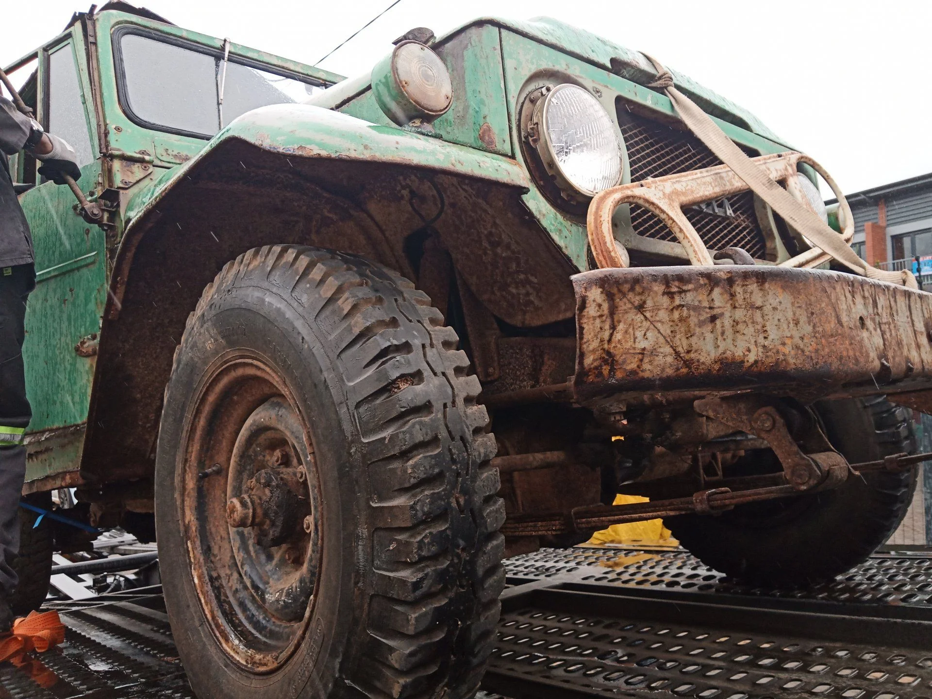

So my 64 and its 71/2 brother finally arrived. The shippers between Oz and South Africa were hard handed with it unfortunately, but nothing one cannot address. Some pics of it being offloaded from the transporter -

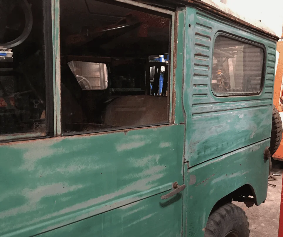

She's a bit crusty and seems to have been parked for a very long time due to the moss on the roof and rats' nests inside.
However, it is essentially untouched and complete save for a bi-fold rear door, the factory keys accompanied it and it shows 87k miles. While I know the odo clocks, judging by the OEM shocks still in their place and the fact that not a single wire has been loosened from its factory retainer makes me believe it may have low miles.

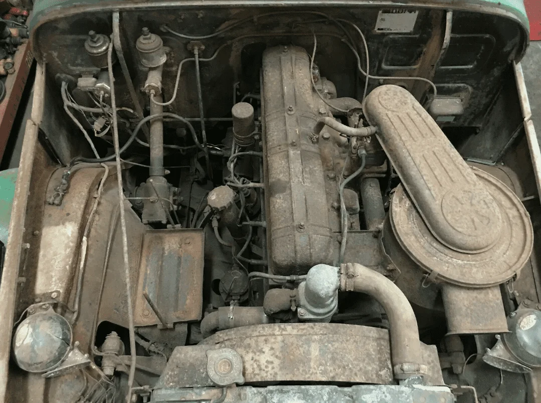

The motor is stuck but I have pulled the valve cover and head and everything is clean as it can be after all this time. It was full of old oil which did not have obvious shavings, debris or water in but I am in the process of pulling the oil pan to see why it is stuck (gasket is really welded on and I am taking time to avoid bending the pan sealing surface). Any suggestions on why it's stuck would be welcome.
