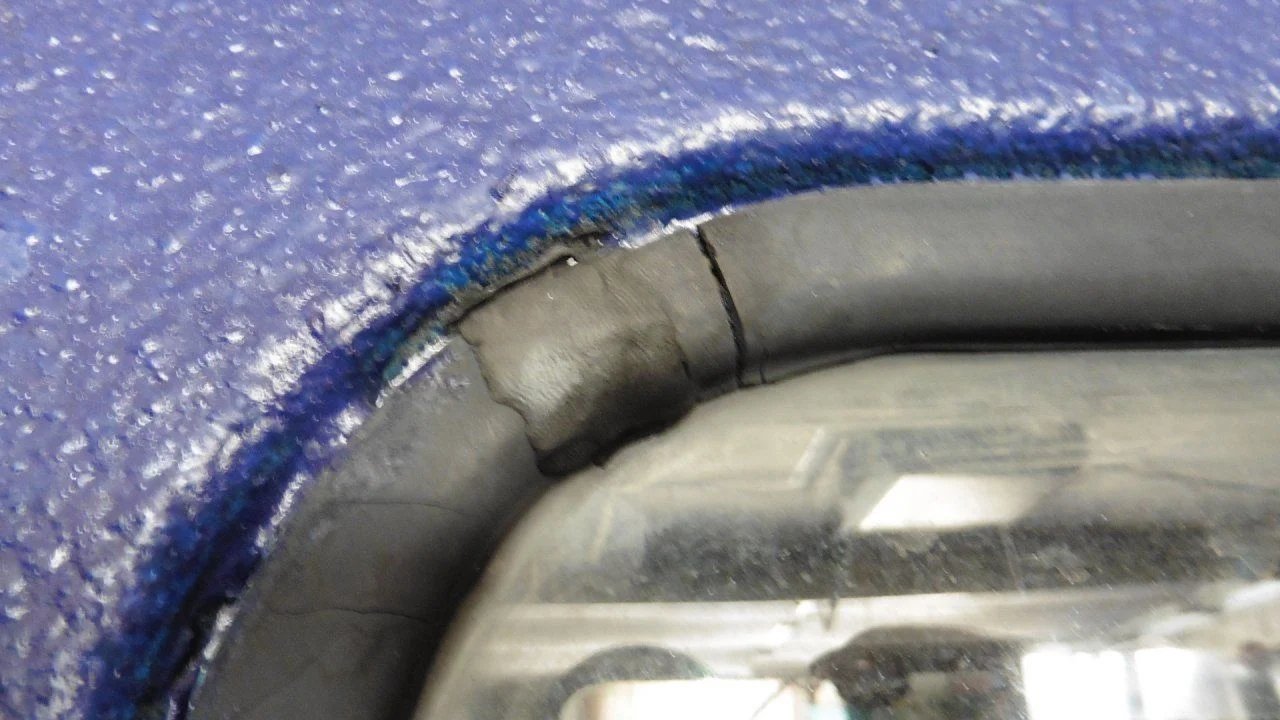

I repaired my unobtanium rear window weatherstrips on the sliders of my '63 non-removeable top.

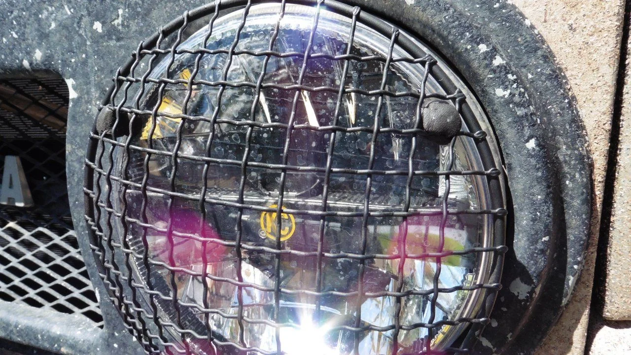

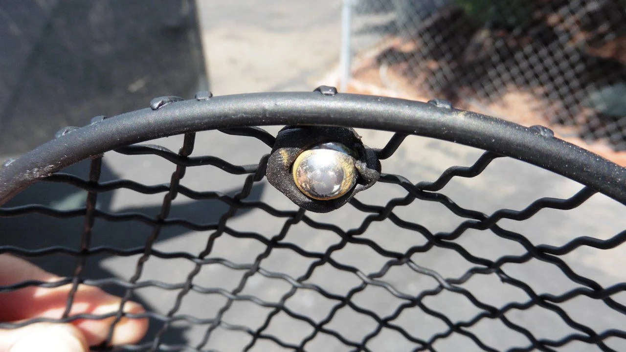

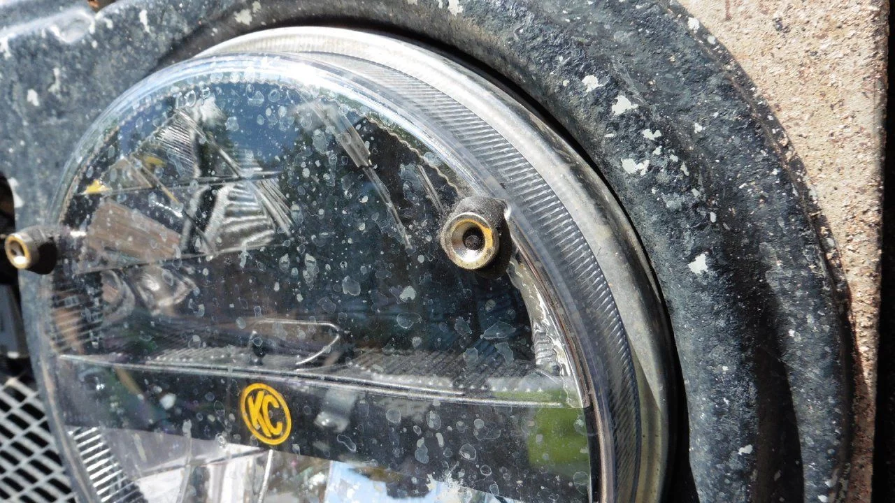

Also used it to attach the rock guards over my LED headlights, with magnets and ball bearings so that I can easily take them off to clean the headlights. Always hated those little clips that come with the rock guards. What the heck good would the clips be if a rock actually hit the guard (none!).
