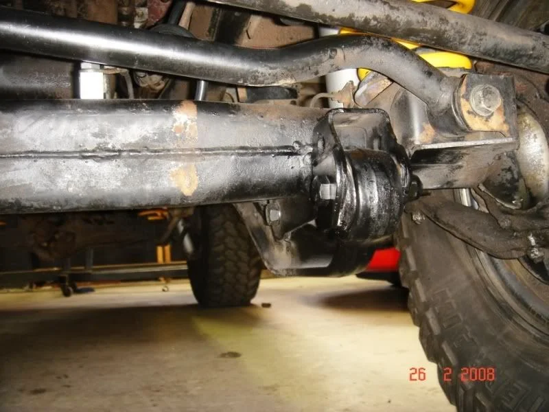

A serviceable, good driving, wheeling lift in that range can be done relatively inexpensively, if your willing and have some fab skills. IMHO stock springs are too soft for a lifted rig and the shocks are too short, so they will need to be purchased, new/used. J front and heavy rear OME springs will get you in that range, then shocks of your choice, I use OME L's for more travel.
For caster correction, do the washer mod, redrill the bolt holes in the axle brackets where you want/need them and tack weld on washers.
Brake lines, if your using std OME length or shorter nothing is needed. If L or longer, it's stupid simple to make brackets to lower the frame side mounts. No need for new lines.
Will need to extend the breather lines, it's simple, some 1/4" fuel line and disposable fuel filters. I always take this opportunity to extend them up higher.
Sway bar brackets are very simple to make.

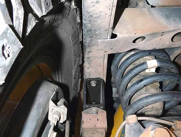

Bump stop spacers will be needed if using L or longer shocks and/or big tires (~315+), again stupid simple and cheap to make.
All of the local rigs that are running this setup are running stock panhards with zero issue.

Do you have pics of the washer mod for caster correction. I still would like to address my caster problem, thanks to the shop not installing the CC bushings right, (which Is what I am assuming happened) or care to evaluate some more?
And how stupid simple to make are the bump stop spacers? reference to a DIY thread would be helpful. I am running L shocks on front J springs and heavy rears and haven't noticed needing Bump stop spacers yet, but would be nice to know for future reference.
Thanks.
Thanks.
IMHO bump stop spacers are not needed with L shocks unless you're running a 33" or smaller tire. 315's should net you about 16" when fully compressed, and the L's are at 15.24" (IIRC) for maximum compression.
If you're running a smaller tire then you may need to space down the bump stops a bit.
I looked and guess I have never took or saved pix. I do have a saved from the net pic and LCool has page; http://www.lcool.org/technical/80_series/caster_mods.html
I move the rear bolt first, then if needed the front, this keeps the arms as close to the axle as possible, better clearance. For the washer, have always used large round fender washer type. I drill/grind the new hole, instead of the slot in the pic.
Thanks.
For shorter spacers I use aluminum strip the thickness needed and 2" wide. Cut or have it cut into two pieces slightly longer than the stop. Take off one of your stops, center it on the block, mark, then drill two holes in the block to match the stop, get longer bolts and bolt it on. For thicker ones do the same thing with steel square/rectangular tube. A pic of the 3" stops on mine.
