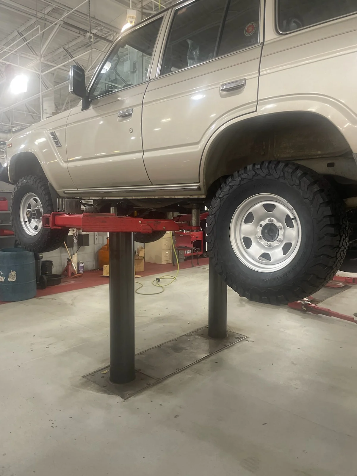

Thanks all. Ended up going with the BFG AT K02s. 265/75R16. They look good on my new Toyota OEM 16" wheels (# 42601-60262-03)! And yes, there is one more lug nut to go on the wheel. Toyota Parts shorted me one but it's coming tomorrow.
Those don't require a washer-ed lug nut?
I genuinely don't know anything about those wheels. They look good on the 60/62, for sure.
I think those are the OEM steel wheels for an 80 series. They take a standard cone shaped lug nut, not the shank type of the later 80 series aluminum wheel.

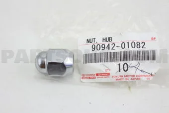

The picture is kinda fuzzy... can't really tell if there's a taper.
Here's a pic of the nut. It is acorn with a taper. The part number has changed to 90942-A1002 so don't look at the part number on the bag. Same part though. These rims were supposedly originally available on the HJ61 or HJ71 from my research but not in the US. Though I reserve the right to be wrong about that.
