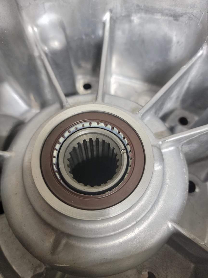

Found the issue. Transmission output to transfer case input coupler snapped in two places rendering the power transfer inoperable as the transmission output shaft was just spinning inside the broken coupler.

Parts finally came in. The coupler I needed is only available on the t case input shaft assembly $220. It's a pressed fit and not easy to slide off.
Didn't want to have to crack open the t case and deal with all the seals, gears, bearings etc. Fluid looked good/no metal. Managed to get the coupler separated using a $29 bearing splitter from Harbour Freight along with a Harbour Freight press.
Coupler slid right into the extension housing carrier bearing with no issues. We then pressed it onto the input shaft of the original t case and got it all back into place.
