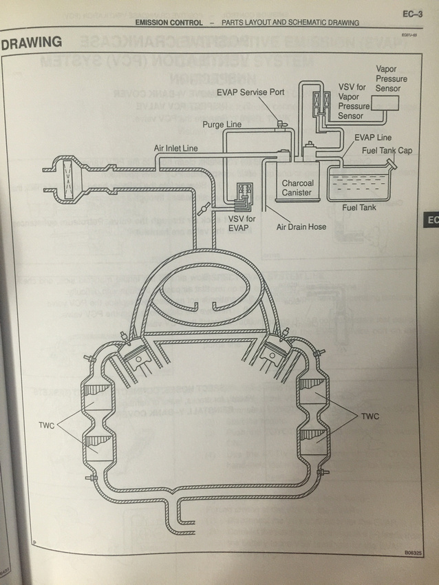

The charcoal canister part of the Fuel / Emission Control system. In simplest terms it "scrubs" the vapor that comes from the fuel tank when fuel heats up and evaporates. It's path is through the evap line to the charcoal canister. From there the vapor goes to the intake manifold. Charcoal absorbs the fuel which should prevent liquid fuel from entering the air intake. The system is not particularly complicated but more than I care to describe any further :) so here's a page from the service manual
