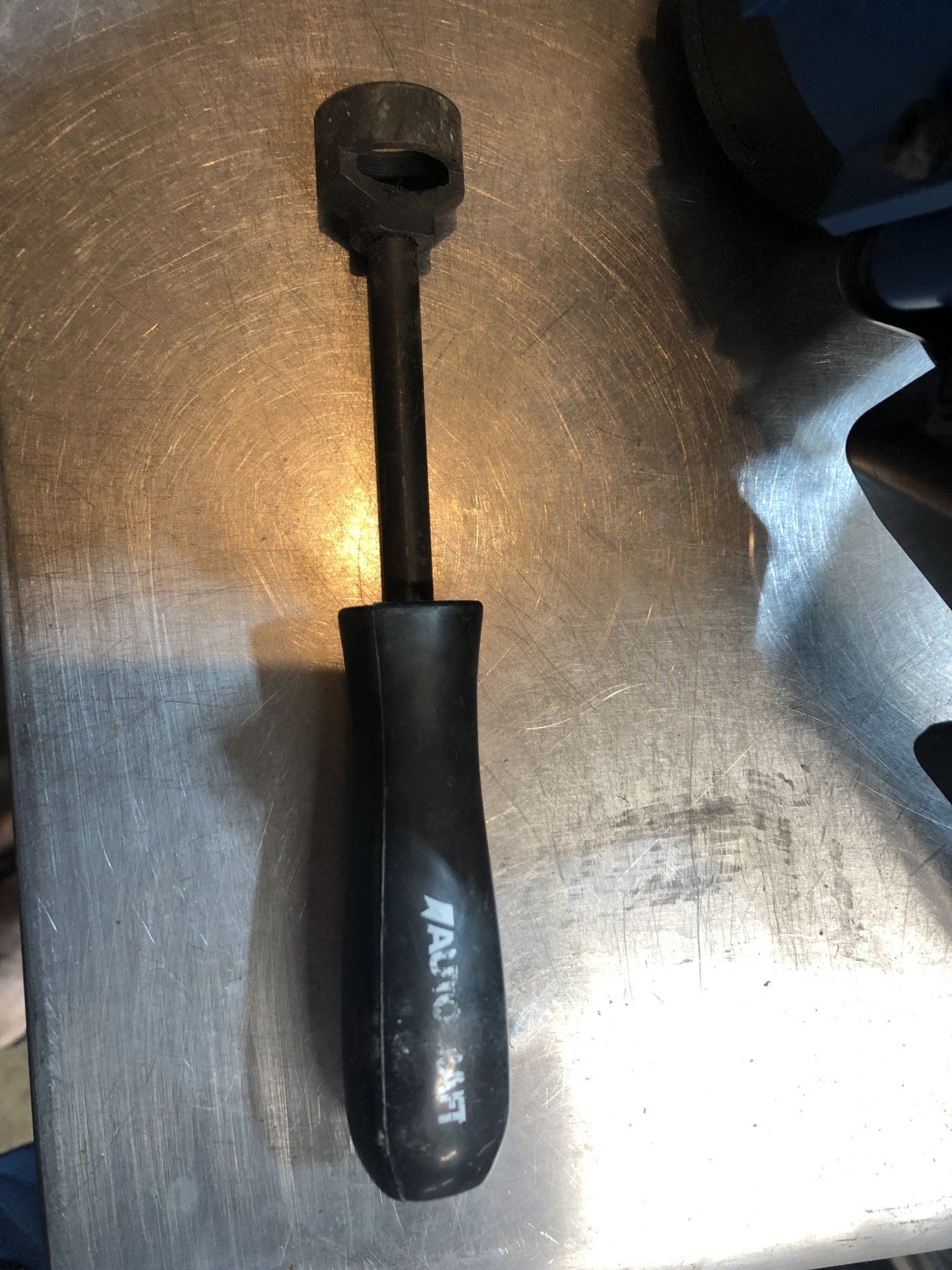

Good catch. I have a tool specifically for that, it has a screwdriver handle, but allows you to press in the hat and turn it 90 degrees between the install position and the latched position.
Looks like it is not installed all the way. Should be pushed in and rotated 90 degrees. That's probably the source of your noise.
Hey guys (especially @empty80 for hopefully catching that odd angle), thanks for sticking with me through this challenge. There is nothing I hate more than an inconsistent problem. Makes it really hard to track it down. I'm not sure if I'll get a chance to look at it tomorrow. I've ordered a "brake tool set" that should arrive Tuesday which has a tool that should do the trick for fixing that clip. I know I probably could use something around the garage but I'm planning on doing a full rotor/pad replacement plus parking brake pad replacement soon anyway so I need that set in the garage.
