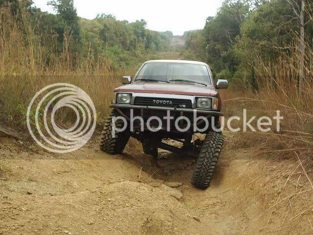

This is the best the ole 60 could muster
Looks about the same as my setup. I did a set of 2.5 shackles, a rear lunchbox, and now have a set of 33x12.5 Swampers. If I could get this think to flex I think it would be fairly entertaining.

on the new shackles did you use poly bushings or rubber bushings?m the picture I posted is bone stock with 31x10.50R15's
That front droop still beats a 100 series.

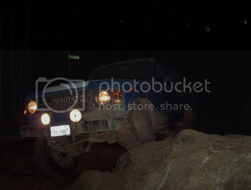

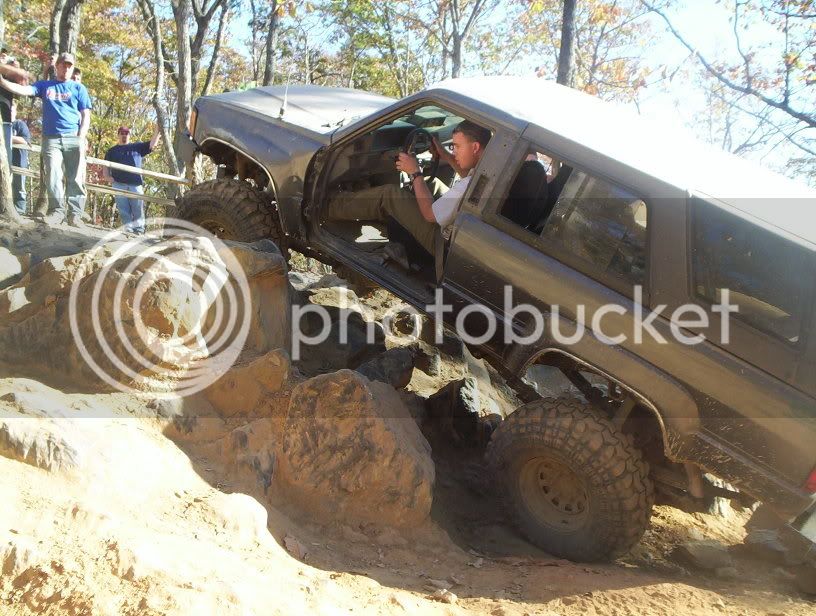

Mine made it the same distance up the RTI rock as a stock 80 series and this four runner.
add-a-leaf lift at this point... the DS tire is rubbing the fenderwell and the passenger side would lift off of the ground when someone stood on the DS rear... crappy picture though
Cool 4-runner... this picture is from Uwharrie right before kodiak rock. He's got dual cases one with 4.7's so his crawl ended up at 120:1 or something... he didn't even touch the gas through this part
Maybe it was... stock in the front case, 4.7's in the rear case and 4.88's in the axles... it's a cool rig. Just cause I can't do math doesn't mean someone can't enjoy the pictures :flipoff2:
