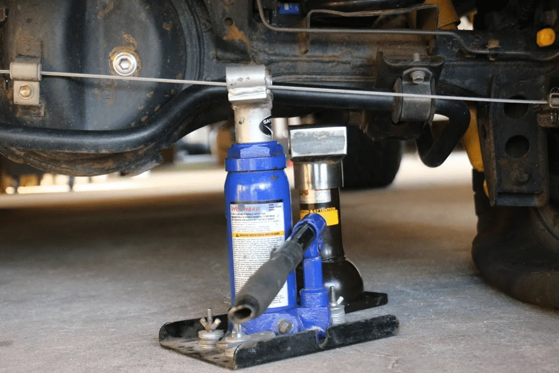

paging @LandCruiserPhil
LCP has some nifty products to address getting the bottle jack to work (safely) with slightly lifted rigs...
We now have 4 sizes to work with all Toyota jacks and aftermarket hydraulic jacks. PM me if you dont see what you need on our site or if you want input.
I'm a Safe Jack fan.
Safe Jack will not fit under the axle when the tire is flat.
I was forewarned and always carry 3 pieces of short 2x6 to drive up onto, said pieces serve many other uses as well. The stock jack can be used to raise vehicle to facilitate use of Safe Jack. In short there are many ways to skin the cat.
LOL Given all that▲▲ why not just use a factory jack?
