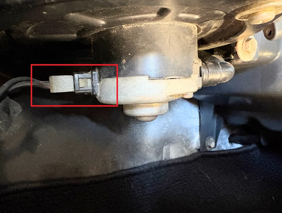

Compressor has cold air when you open it to ‘VENT’ but when you slide to recirculate the fan does not go on. It’s not the fuse, maybe the circuit breaker or the fan motor itself??
Any thoughts? Currently on the road to SAS9.
Step 1.. verify the fan motor is working.. Get eyes on your blower motor.. it'll have a single electrical connection.. it will have just two pins, unplug it and give the two pins on the fan side of the connection Earth and Batt +.. The fan should roar into life.
If it roars into life - you have a problem that is not the blower motor.
If it doesnt roar into life the blower motor is faulty.

Thanks @OSS did that to the circuit breaker & no luck. @duncanrm dropped the motor & the brushes are done for. Going in to town tomorrow & try to find some brushes that will work
Oops, try to find some brushes that work and a soldering iron. And then we’ll see if that solves our problem. Will let you guys know tomorrow if we get it fixed. I think we are on the right track.
6:30 am, heading in to Ridgeway (population around 750) to see if we can find some brushes that we can sand down to a proper fit for the blower motor. If so, this should get it working again. Will report back.👍🤞👍
Ok, all fixed. Fortunately SAS9 is about 1 hour from Proffits Cruisers & they fixed me up with a good used fan motor. Was not a direct fit but took the ‘new’ motor out & put it in the old housing. All good now. The brushes AND the armature both were shot on the old motor.
