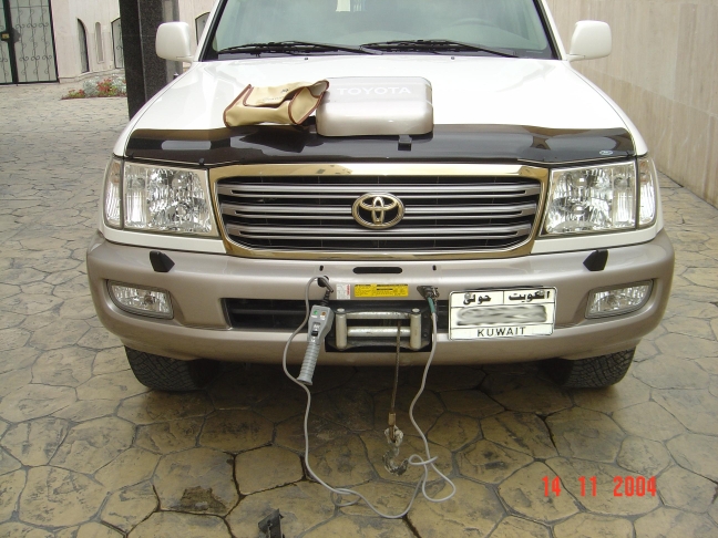

stock bumper with winch? any been running???
R3, have you looked at the OEM winch setup? It's in the FSM, and in parts lists. Looks like parts are not cheap, but setup could be copied.

I dont think I've even seen a picture of the factory winch on a 100. Once again I'm jealous of factory items we cant get in the US. i have to wonder if any made their way to Canada, it would be a lot cheaper shipping wise
