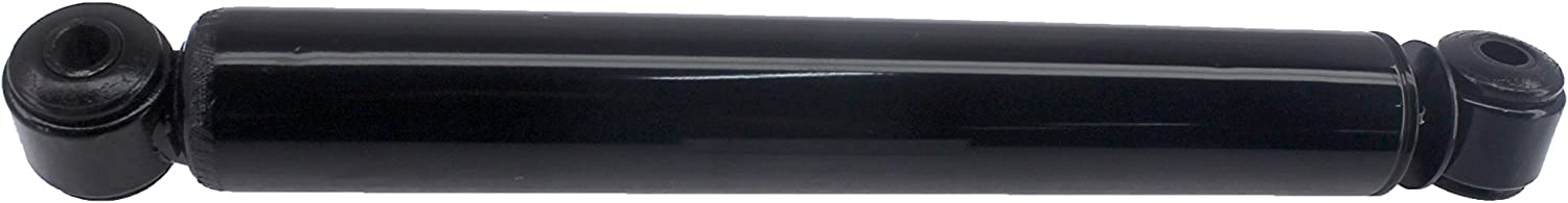

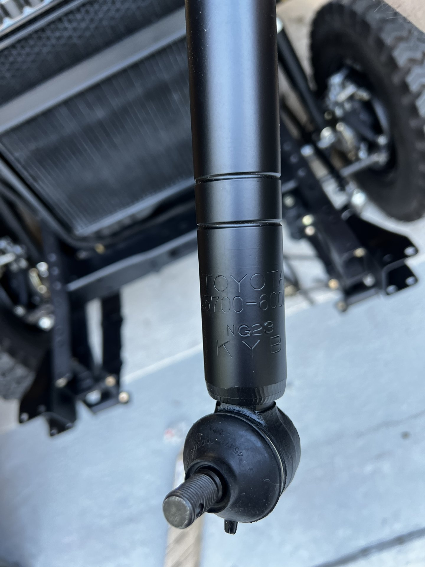

I saw that the OEM piece that @dmaddox had was from KYB, so I contacted them.
Their support was funny, they said "Sorry, but we do not have a steering stabilizer even close to the required specifications."
I asked if they had anything close, and they sent me P/N ss10333.
They just sent the p/n, no dims. when I looked it up, it looks like compressed = 13.18", and extended length = 21".
Hmm... 🤔
The OEM piece:
The KYB SS10333:
They DO have the OEM unit, as they manufacturer it for Toyota. It's available aftermarket in AU, but not USA, and through the dealer it is OUTRAGEOUSLY priced. I called KYB and asked for a sample and they would not provide. KYB is very difficult to deal with. The good news is that aside from corrosion, these units seem to last a good long time, and the rubber boots and retaining rings are available new from Toyota (Same boot as is on OEM tie rods). If you have a good unit, clean it up, add new boots, and put it into service. If you opt to go with what KYB provided, you will need a stud with a taper on one end, for affixing to the stock mount.
My original was long gone when I got the 40.
If KYB is not helpful, they can suck it. I like their product, but I have already gone out of my way to try to buy from them.
I think I will try to get this tomorrow:
