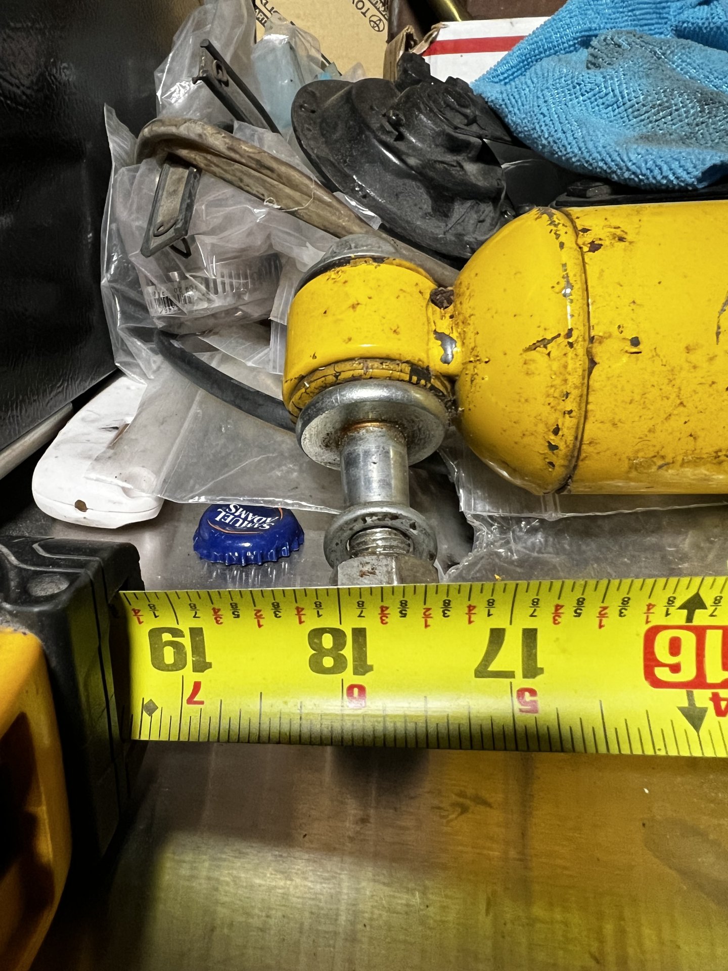

I saw that the OEM piece that @dmaddox had was from KYB, so I contacted them.
Their support was funny, they said "Sorry, but we do not have a steering stabilizer even close to the required specifications."
I asked if they had anything close, and they sent me P/N ss10333.
They just sent the p/n, no dims. when I looked it up, it looks like compressed = 13.18", and extended length = 21".
Hmm... 🤔
The OEM piece:
The KYB SS10333:
Note the cool ends on the OEM piece (I think it even has grease fittings!), and the open eyes on the SS10333.
I asked KYB if they have studs for mounting, they said they do not.

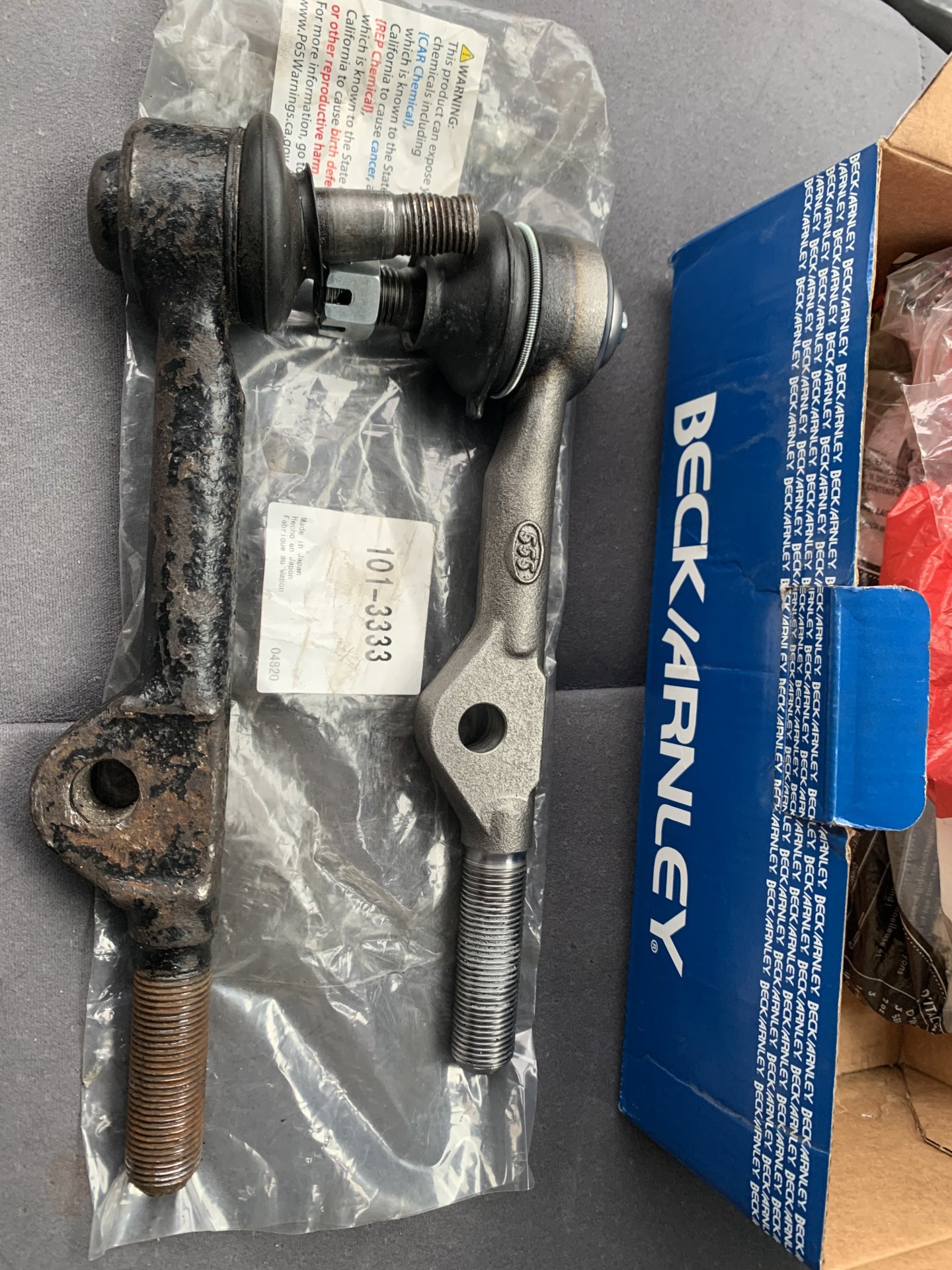

60 series stabilizer and pickup TRE.
Found it. Stock 40 Tie Rod, 80-81 Toyota Pickup 4x4 TRE. The Pickup TRE gives me the extra 5” of length in the Tie Rod assembly, and the extra hole gives me a mount for a stock steering stabilizer if I decide to run one. If the 40 stabilizer doesn’t have enough travel I’ll switch to a 60 series which does have more travel.

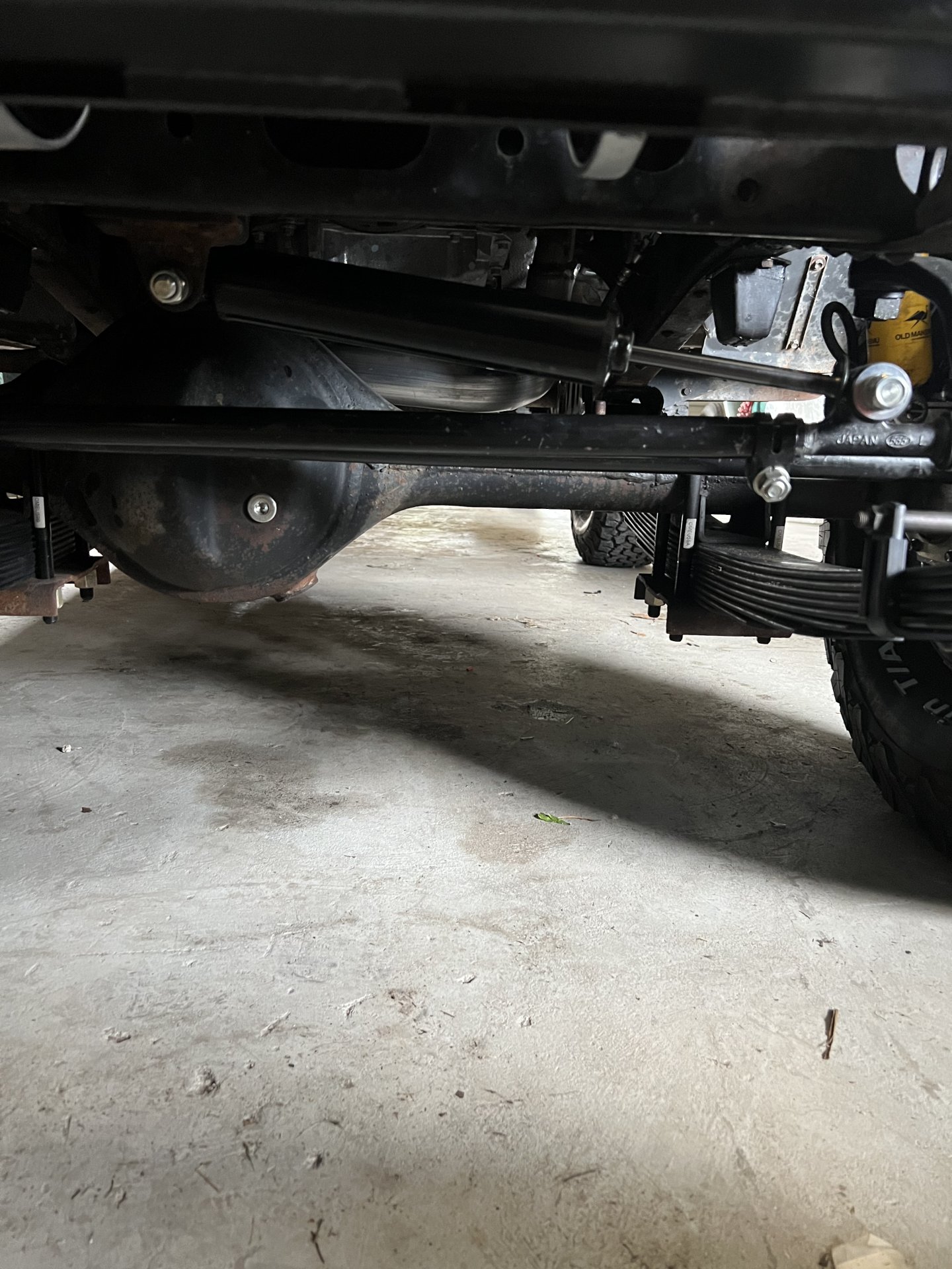

Have been down this road on my 73’. Called a few cruiser shops to get stabilizer dimensions and couldn’t find an OEM fit that had the right specs. Found out a Monroe SC2915 unit fits the bill with no mods.
This looks good - It looks like you mounted the stabilizer behind both mounts.
Do you have a side view to show how the two mounts align?
Well I honestly don't know why I never checked on a 60 series mount to begin with, but it looks like they would work!
