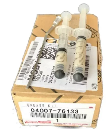

@Kernal, there's a Toyota grease kit especially for that. Let me look for it and I'll post up a picture and part number.
