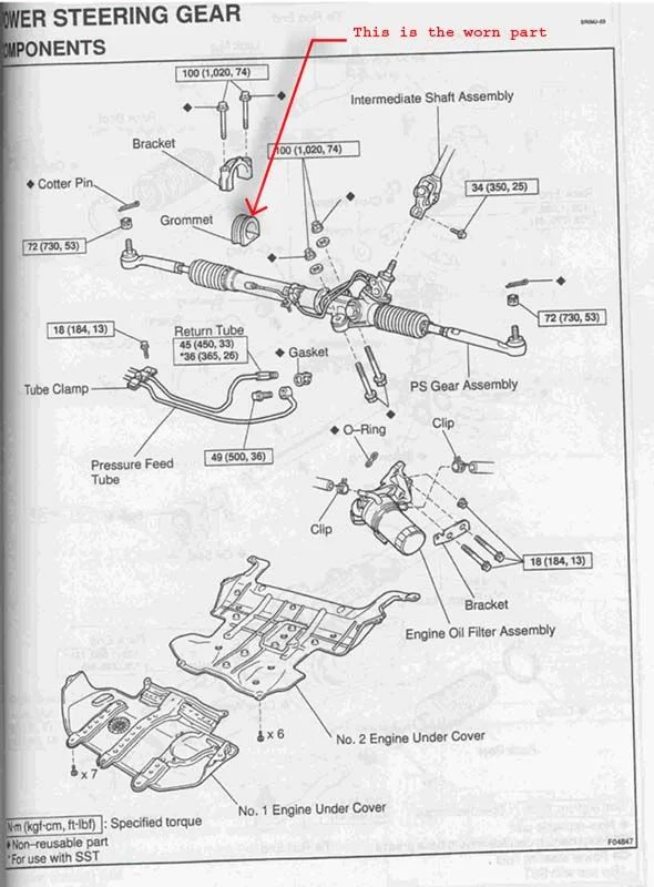

siglo: Is this the bushing you refer to in your original post? This "grommet" as named in the FSM is where I now have 'slop'. I am wondering if this is the same part you had replaced or?
Anyone know if this "grommet" can be replaced without pulling the rack?
Thanks,
Dan

i had replace mine also with aluminum cause it is rubber and it is fixed from the manufacture and their is no spare parts !! every years spressomon the part u marked it many times i seen mine changed placed !!! i noticed only with 315s and i can feel it while reversing or turning i replaced it and now it is ok.

Where did you source the aluminum "grommet"/bushing? Or did you just have one machined?

This appears to be the mounts for up to 08/2002 models and then I guess there is a change in the design and a different mounting style?
Wonder where the two smaller bushings and then the two metal bushings go?
This "grommet" seems like a strange thing to wear out. It doesn't move...I wonder what causes the wear???
I'm thinking for the two other frame mounting points (driver's side and center).
Basic difference should be the dampening effect. So much other dampening occuring throughout the chasis, you shouldn't really notice it. I agree, not sure why it wore out in the first place
A great deal of force is being placed on these bushings - side to side. I've replaced the mounting bushings on a Tacoma and a 4runner too with polyurethane. I think this is a common problem with IFS Toyota 4x4's and more likely to happen when you are pushing large tires around.
