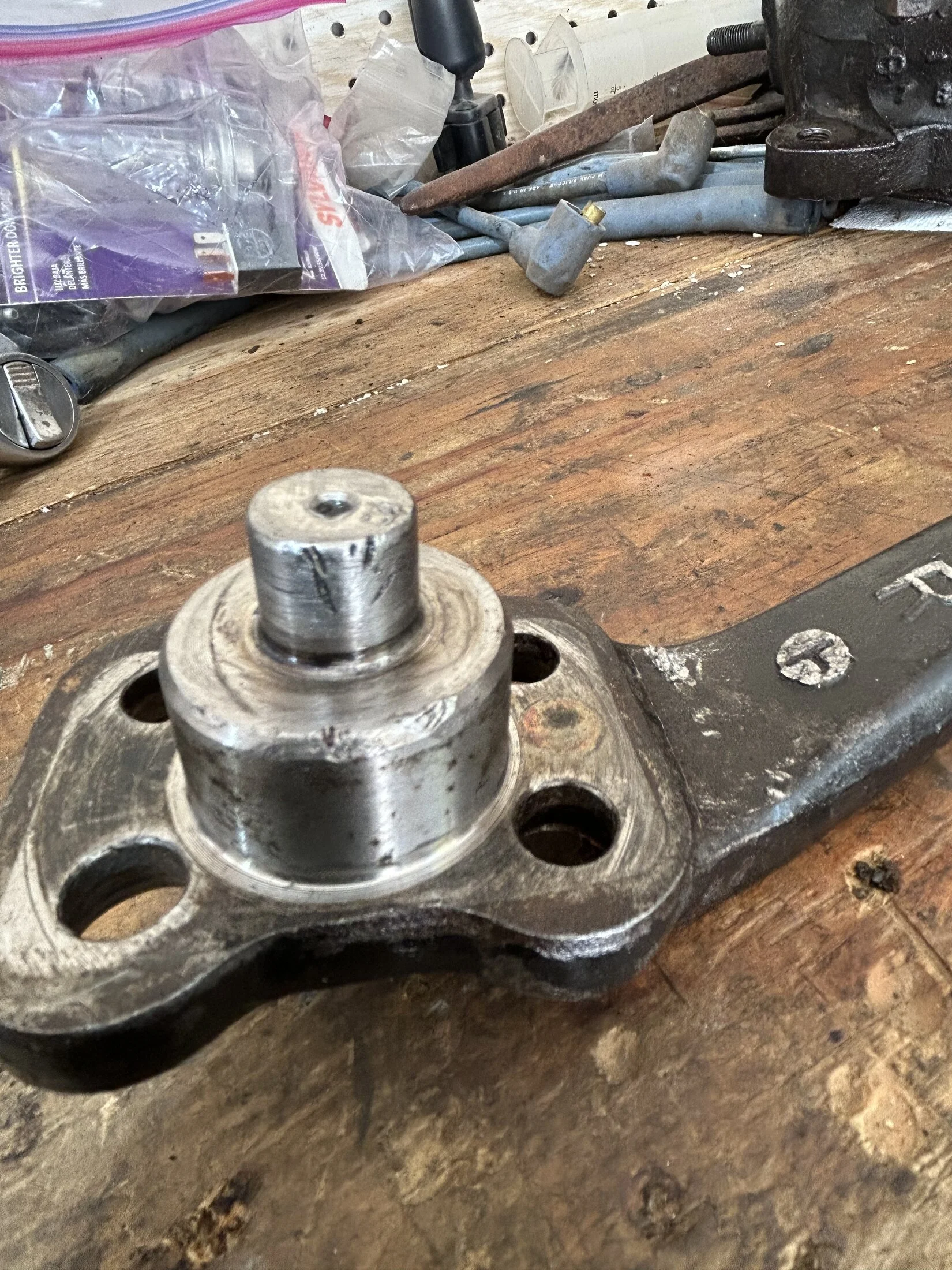

I nicked the arm body trying to remove a stuck race. Diameter is the same as the bottom one. I filed down the gouge but can still catch my fingernail on it.
Any advice on if I should use it. Thanks
Looks like a well used part, lots of minor damage. If you don't have big oversized wheels/tires powdered by supercharged V12 with nitro and you enjoy jumping berms at high speed, you are likely ok to drive a normal tractor until you can find a replacement. I always go by the theory IF I can feel it, then its five thousands. Got any friends that can do a dye penetrant or magna flux test looking for cracks.
Thanks for the advice. I’ll go ahead and try it.
