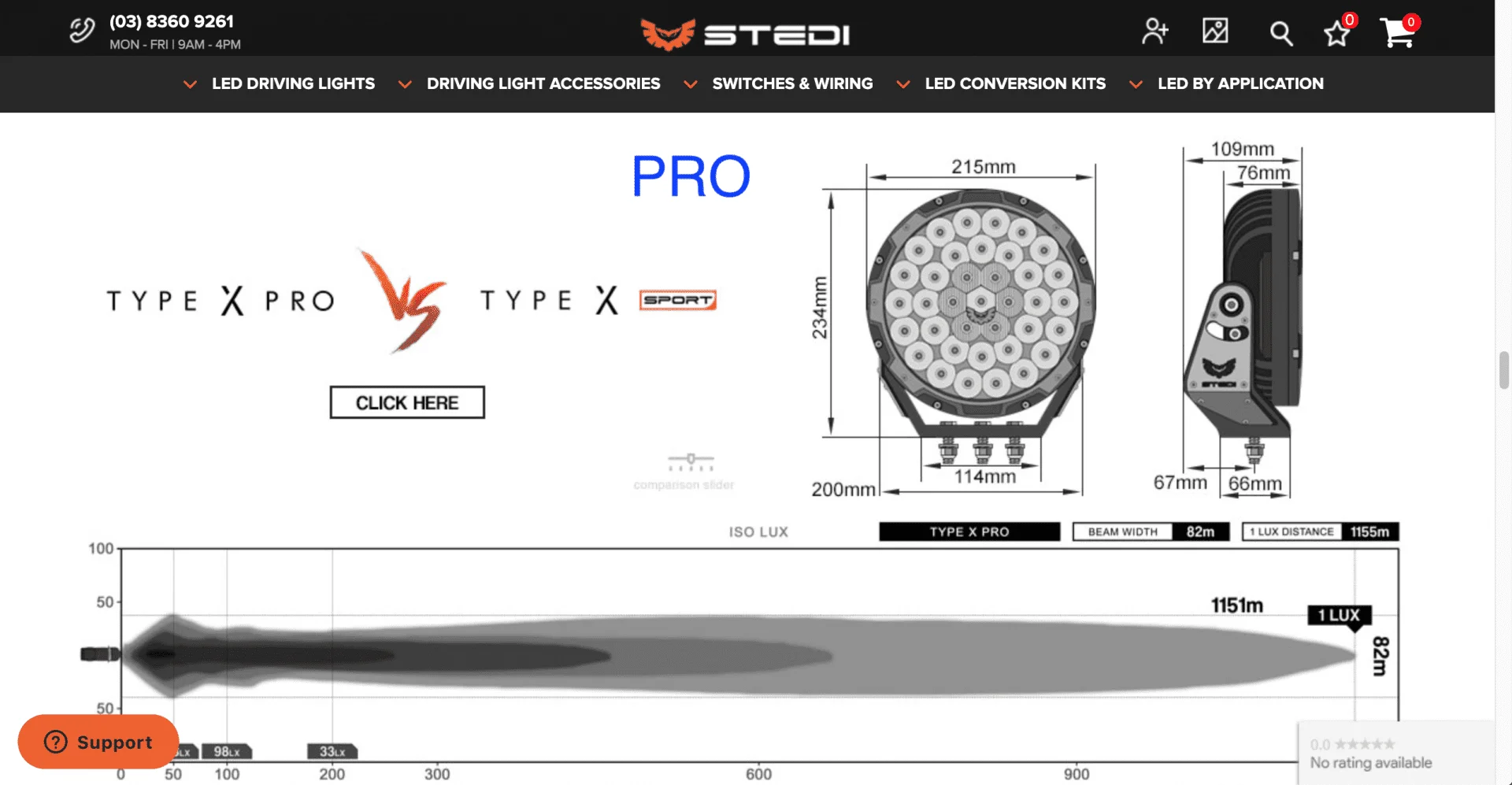

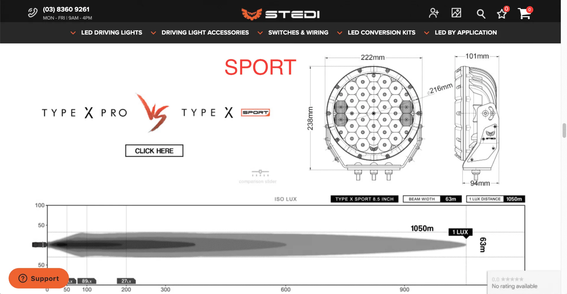

From what i saw everybody had ordered the Type-X Pro. Over on Stedi's website, I see they now have a Type-X Sport model for about $200 USD less. Has anybody else gone this route, or considered it? Would love to save the $200 if the end results are not a huge difference. I did see 1 classified post where @brasskey said he bought them to fit his 200 TJM bumper and they wouldn't fit? That concerns me:
Spec-wise I don't offhand see any dimensions on why everybody would fit the Pro fine, but not the sport. What am I missing?

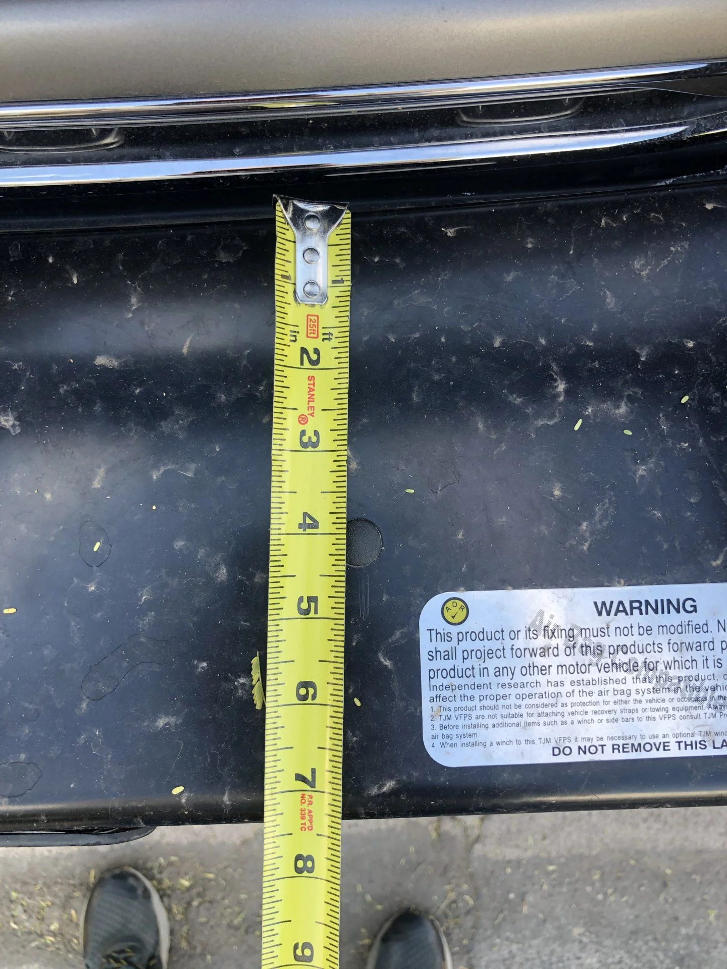

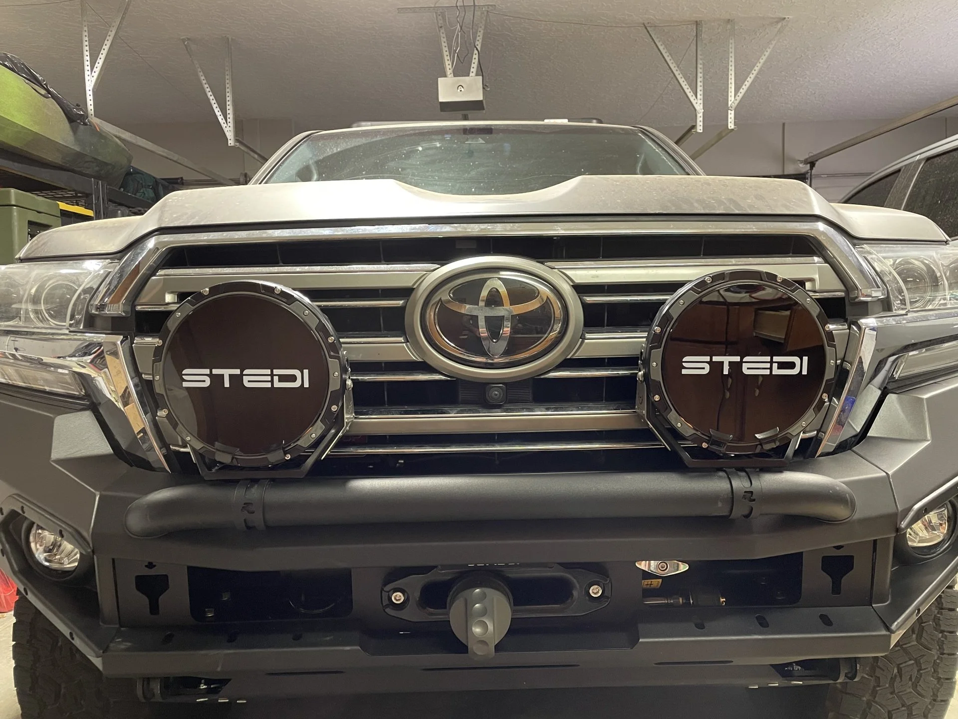

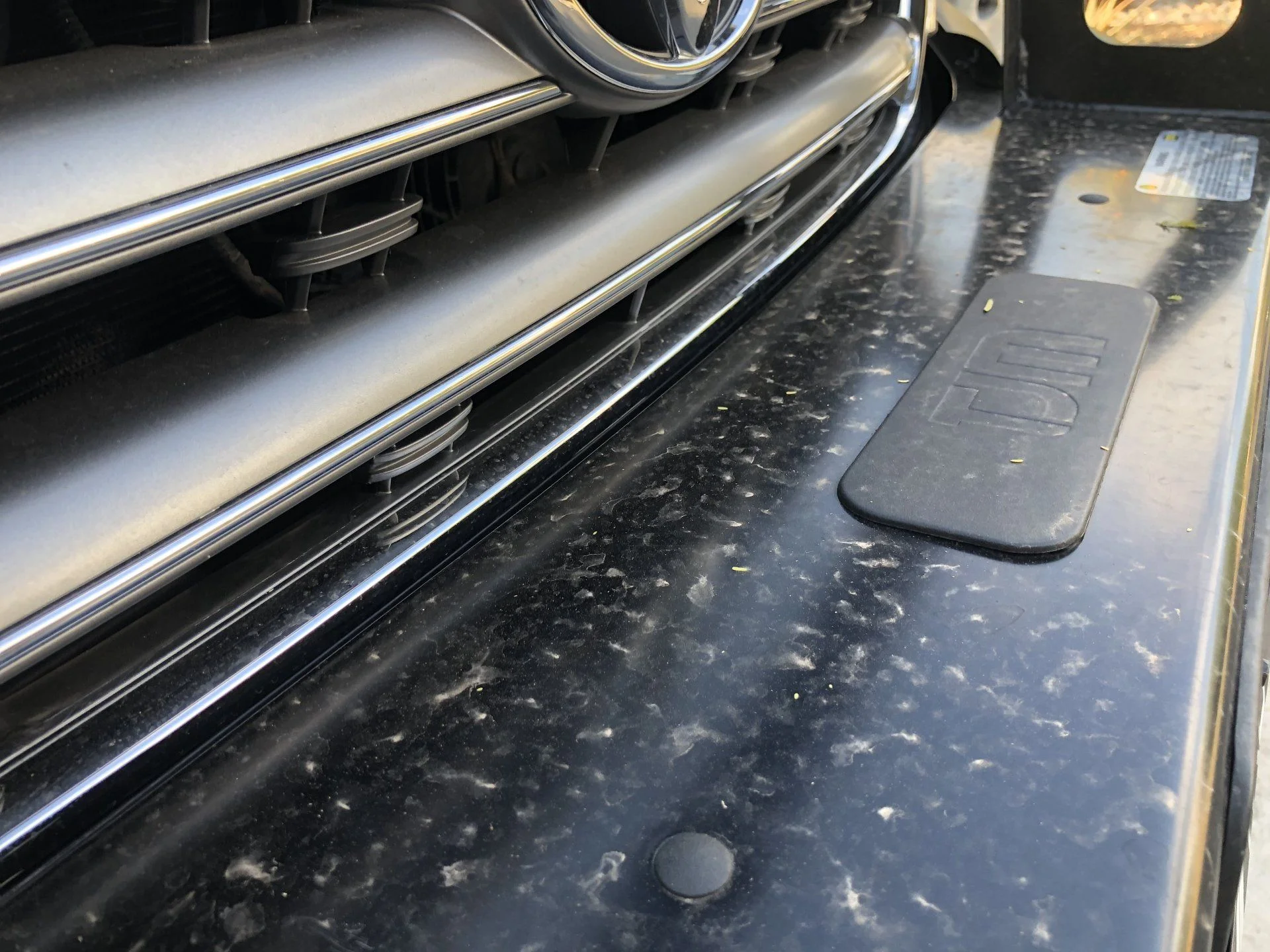

I have the Sport. The bumper on the 16+ is lower profile than the previous 08-15 versions (only 4.5" from end of bumper to grill as shown in first picture and 3.5" from the grill to the bend down in bumper). So, there's not as much room for large, deep lights like on the the older TJMs or the ARBs as those bumpers stick out farther. From the post you made with photos of your bumper on my previous For Sale thread (see second picture), that bumper definitely looks like it's deeper than 4.5", but you don't have a bend at the front like mine does. Your post above shows that the Sport are 101mm deep and the Pro are 109mm. So, you can use those measurements and the measurement from the back of the bracket to the center of the mounting hole to see if you like where they'll end up sitting. I made them work by modifying the mounting bracket so that it sat more forward on the bumper (had to drill additional holes in bracket). If you look on the third and fourth pictures, you'll see how the bracket would fit in the existing bumper holes as is. It's right up against grill and still not inline with the holes. So, I moved the bracket off the grill a decent amount to allow for good clearance and then drilled new holes in bracket. The last picture shows them mounted and they hang a bit over that bend on the bumper at 3.5".
Also, looking at the pictures you posted of your bumper, it doesn't look like you have mounting holes in your bumper. Is that correct? Mine were already there. If you don't, then it's probably easier to mount as you can drill those holes wherever you want.
I have the Sport. The bumper on the 16+ is lower profile than the previous 08-15 versions (only 4.5" from end of bumper to grill as shown in first picture and 3.5" from the grill to the bend down in bumper). So, there's not as much room for large, deep lights like on the the older TJMs or the ARBs as those bumpers stick out farther. From the post you made with photos of your bumper on my previous For Sale thread (see second picture), that bumper definitely looks like it's deeper than 4.5", but you don't have a bend at the front like mine does. Your post above shows that the Sport are 101mm deep and the Pro are 109mm. So, you can use those measurements and the measurement from the back of the bracket to the center of the mounting hole to see if you like where they'll end up sitting. I made them work by modifying the mounting bracket so that it sat more forward on the bumper (had to drill additional holes in bracket). If you look on the third and fourth pictures, you'll see how the bracket would fit in the existing bumper holes as is. It's right up against grill and still not inline with the holes. So, I moved the bracket off the bumper a decent amount to allow for good clearance and then drilled new holes in bracket. The last picture shows them mounted and they hang a bit over that bend on the bumper at 3.5".

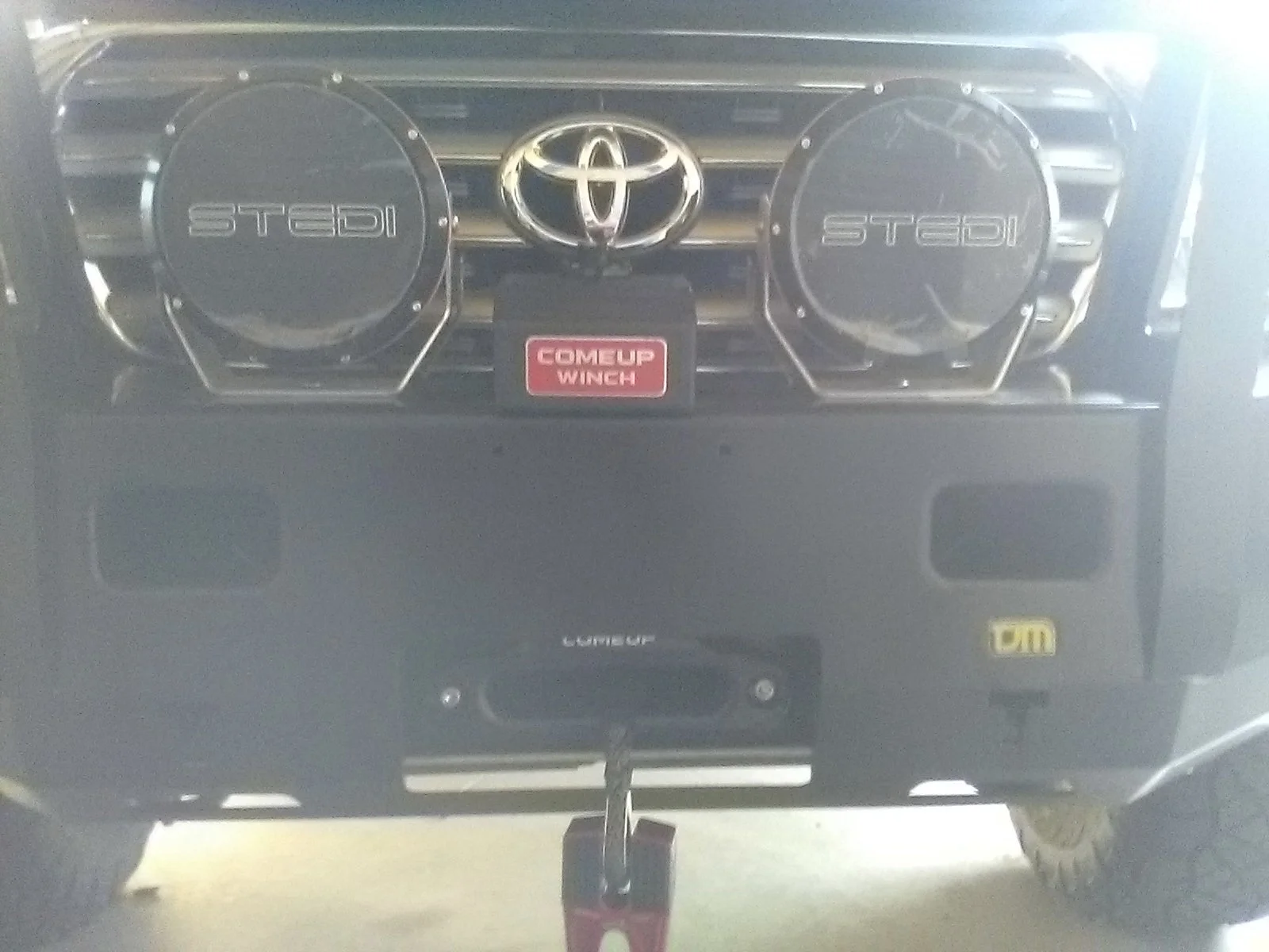

I got mine installed, but haven’t seen in person yet. Install shop still has my truck but they sent me this pic yesterday
Type-X Pro. These are mostly well built. The nut retainer could have been a little better designed with tighter tolerances. Good quality for the money, and still cheaper than Baja Designs or Rigid after shipping
