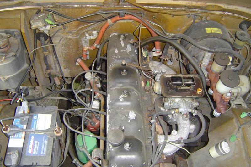

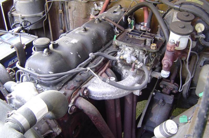

I will see the rig this weekend - till then I only have a few photos. Here are a couple of the engine. The engine is probably not seized as owner says he can turn over by pulling the fan belt.
Squirt a little Marvel Mystery Oil in each cylinder with spark plug removed. This should loosen any stuck rings. Let it sit overnight. With a fully charged battery and fresh gas....give her a go. ASSuMing you have checked other fluids, crankcase, transmission/Transfercase and differentials. Zerk every zerk. You know.....;)
Thanks - is the top of the carb missing? It looks like something needs to be on top of those two squares......
Thank you. I could not tell if there was a housing between the filter and the carb. I am not familiar with the '76, having worked only on a '66 with a humble single barrel carb :)

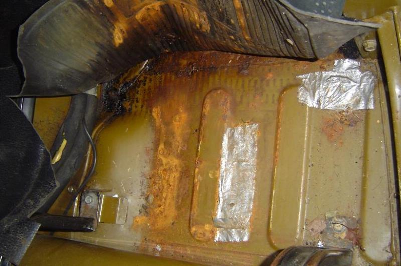

Can anyone tell if this rust is surface or more serious? I'm guessing the black goop is the rubber mat that is decomposing......
That rust is not real bad but probably has already eaten some of the metal. take a screw driver and pick around in it and you can tell from that....
Assuming worst case, would appreciate a swag on what it would cost to replace those floor boards. That seems to be where most of the rust is. Do you get these panels and just wel them on, or do they have to be fabricated?
Thanks Maui Cruiser - I noticed the brake lines :)
