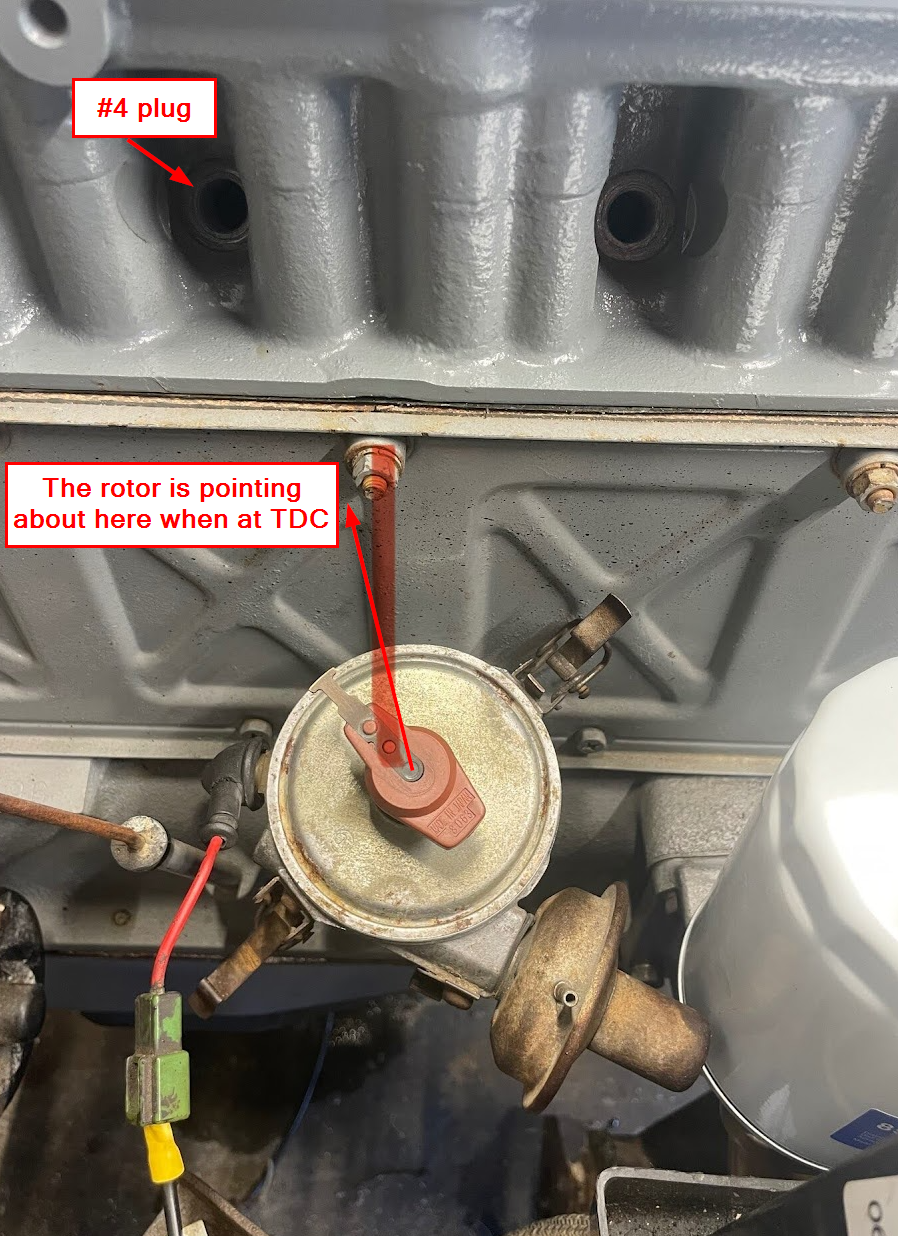

just to confirm--when the timing is at ~7 deg tdc,(vlv springs loose on #1 and6) where is the dizzy rotor pointing?(rotor should be pointing sorta at #4 plug)

The image below shows how it was set up.

You can't experiment with advancing the timing with the diaphragm jammed up against the oil filter. Clock the whole dizzy over a tooth clockwise and try again.
