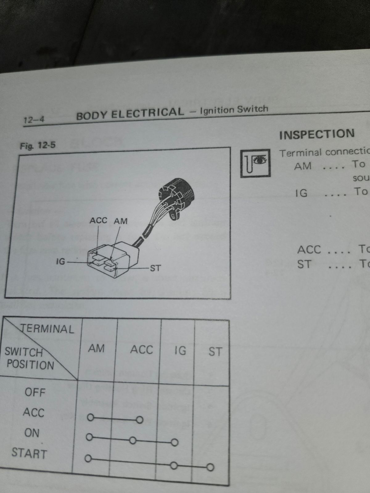

Hi Looking for a starter switch. Visited local Toyota dealership and was informed has been discontinued. Was wondering if the switch is used on other Toyota products. I can visit Pick and Pull to see if I can find one. Vehicle is 1974 FJ40 Thanks in advance

Maybe this is what you need?
