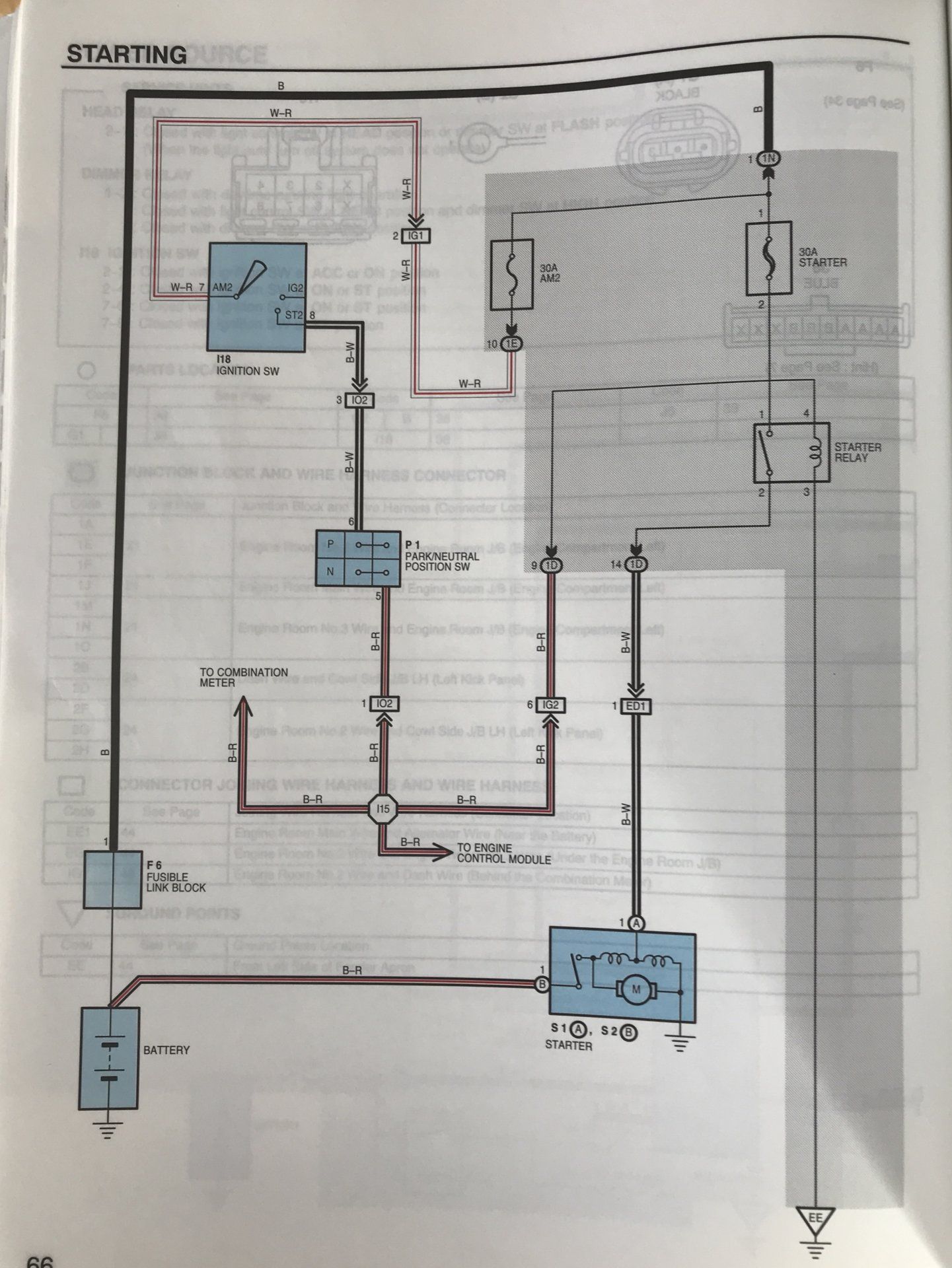

The ignition switch controls the starter relay, which in turn controls the starter itself.
To determine if the switch is sticking I’d remove the starter relay and probe the contacts in the relay base that come from the switch. If they follow the action of the key exactly then the switch is ok. If there’s some delay in relation to key movement, the switch is funny.
Here is the starter electrical diagram for a ‘98 LC. I would guess yours is similar.
