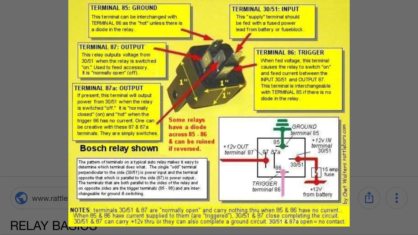

Trigger (86) the relay from the ignition start wire, ground (85) to a good ground, run battery voltage to (30/51) and run (87) To the starter.

The starter has a relay built in, or a soilnoid, same concept, an electric / magnetic switch. That's why there's a large #2 sized wire coming straight off the battery to it (what would be the "input" terminal 30/51 in the picture above) and a smaller ~14 gauge wire from the ignition switch ("trigger", terminal 86 from the picture).

30/51 is fed from the battery+ and 87 goes to the starter solenoid. 85 is ground and 86 is triggered from the IGN.

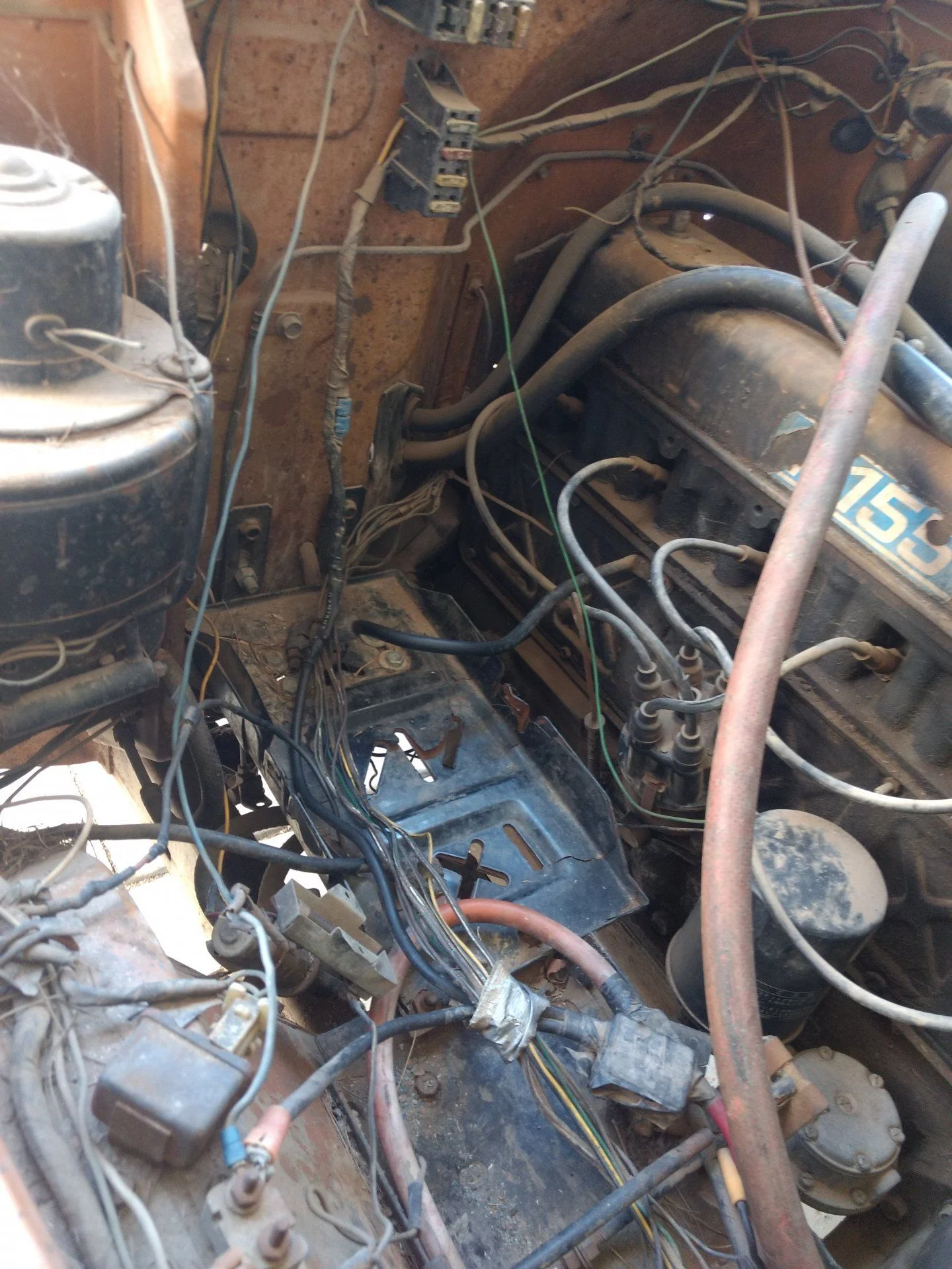

I personally keep the factory wiring if at all possible. Something like added that would draw more amperage would go the pilot relay as the term was used in the HVAC field. After more than a quarter century sitting on a project vehicle I have finally started to look at it. Most would say need to install a aftermarket wiring harness but I plan to repair the stock harness. From the day I bought that was always the plan. Actually looking forward to the challenge of removing all the wiring hacks and going back to stock.View attachment 2445826View attachment 2445828
