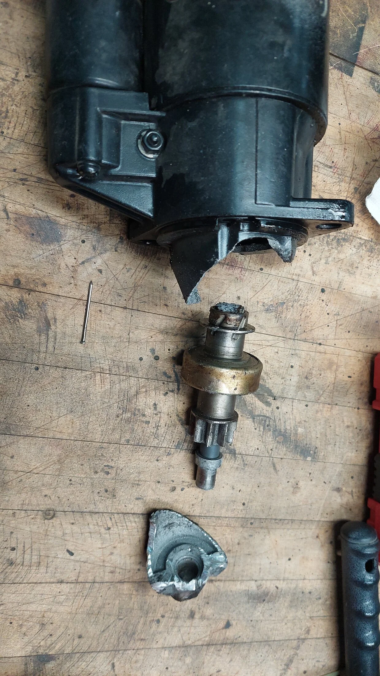

We have gone through 3 of these starters for various reasons. We had one starter explode, see attached.

This is the one that blew up
That pinon gear looks like it was chewed-up somehow. Does the flywheel ring gear look like it has fresh wear?

The gear-reduction starter is actually a downgrade. The pinon gear on the newer (rebuilt or new) is on a smaller diameter shaft. Thus, given the same type and service-use of metal, the gear reduction starter is more vulnerable to breaking at the Bendix, like the carnage seen above.

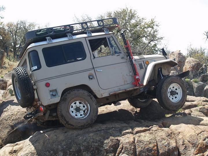

You can even wheel a GR starter!
I had the Karma Cruiser at the Lone Star Roundup in 2009. Rock crawling a 3 on the tree is challenging on a good day. Eventually I found myself up against a rock without adequate gearing.
When this pic was taken, I had shut the engine off, put the truck in 1st Lo, and cranked the GR starter. It walked the truck right up the rock.😉
