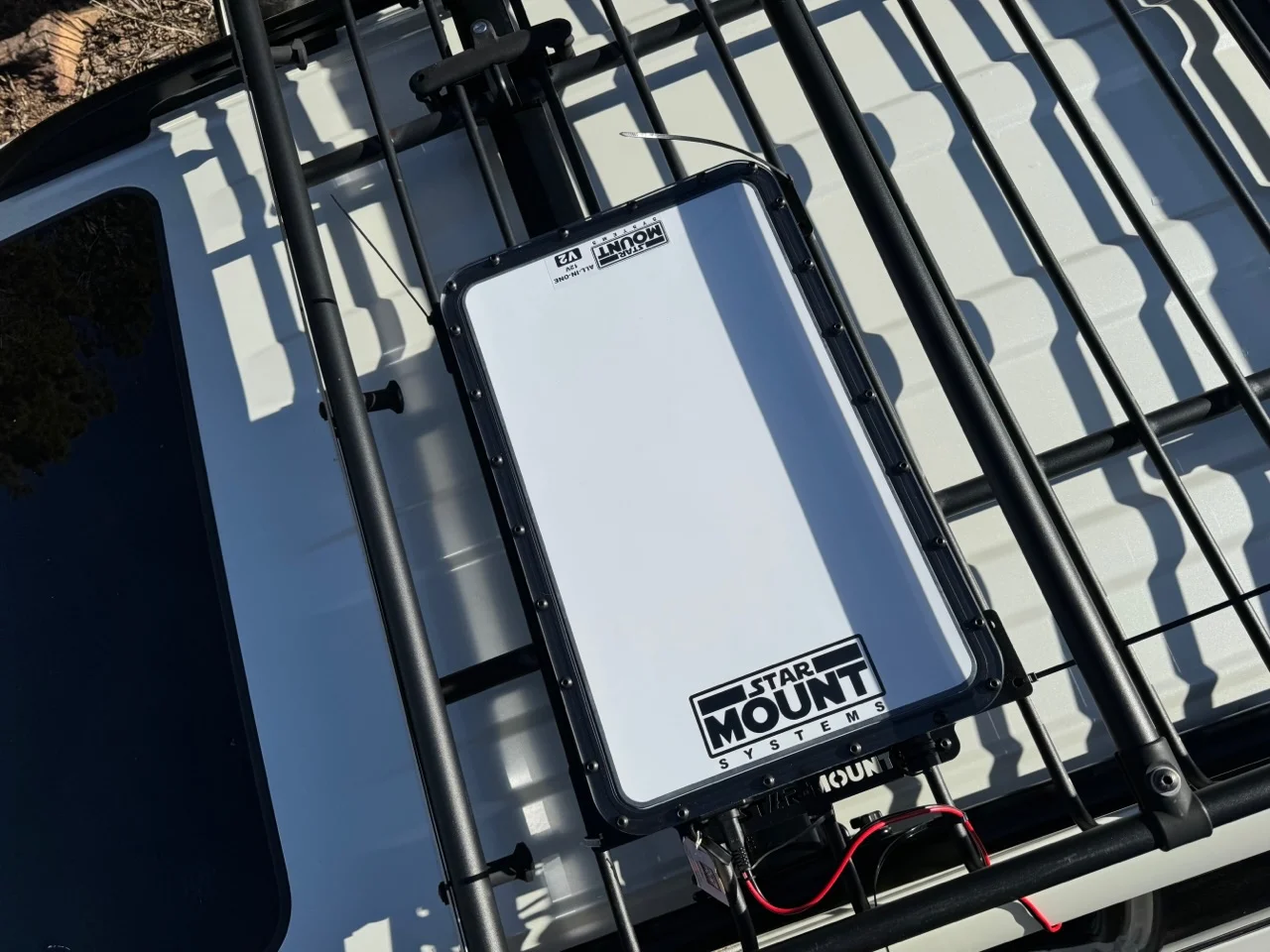

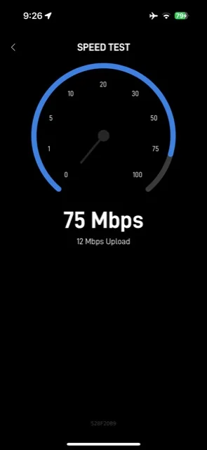

I got my dishy back from Star-Mount Systems yesterday, and threw it up temporarily on my roof basket to test it out before I hard mount it. So far, so good. Getting between 50 and 125mbps while driving at 50mph. Planning to keep it on for some more testing over the next few weeks, then it’ll get permanently mounted to my gamiviti rack when it goes on in January.
It takes about 5 minutes to connect once it gets powered up. Once it’s hard-mounted, it’ll be wired into my aux battery with a switch in the cargo area, so I’ll keep it on all the time unless I’m leaving my truck for multiple days.

any issues with it just being flat mounted?

No issues with the flat mount. Even when I camped in a deep canyon in Moab, I only had a short drop out once every 12 minutes (FaceTime calls would disconnect, but I could call back 30 seconds later)

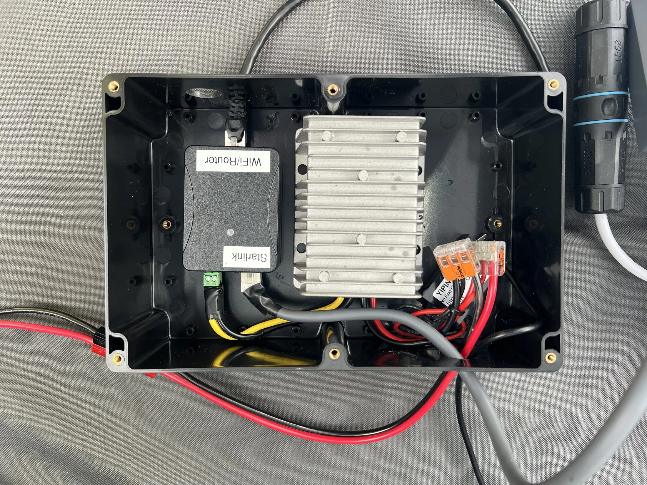

I modified my existing 12v kit. Removed components from plywood and bought an inexpensive plastic case to relocate the components.
Ran the dish to get some updates and heat did not seem to be an issue inside the closed case.

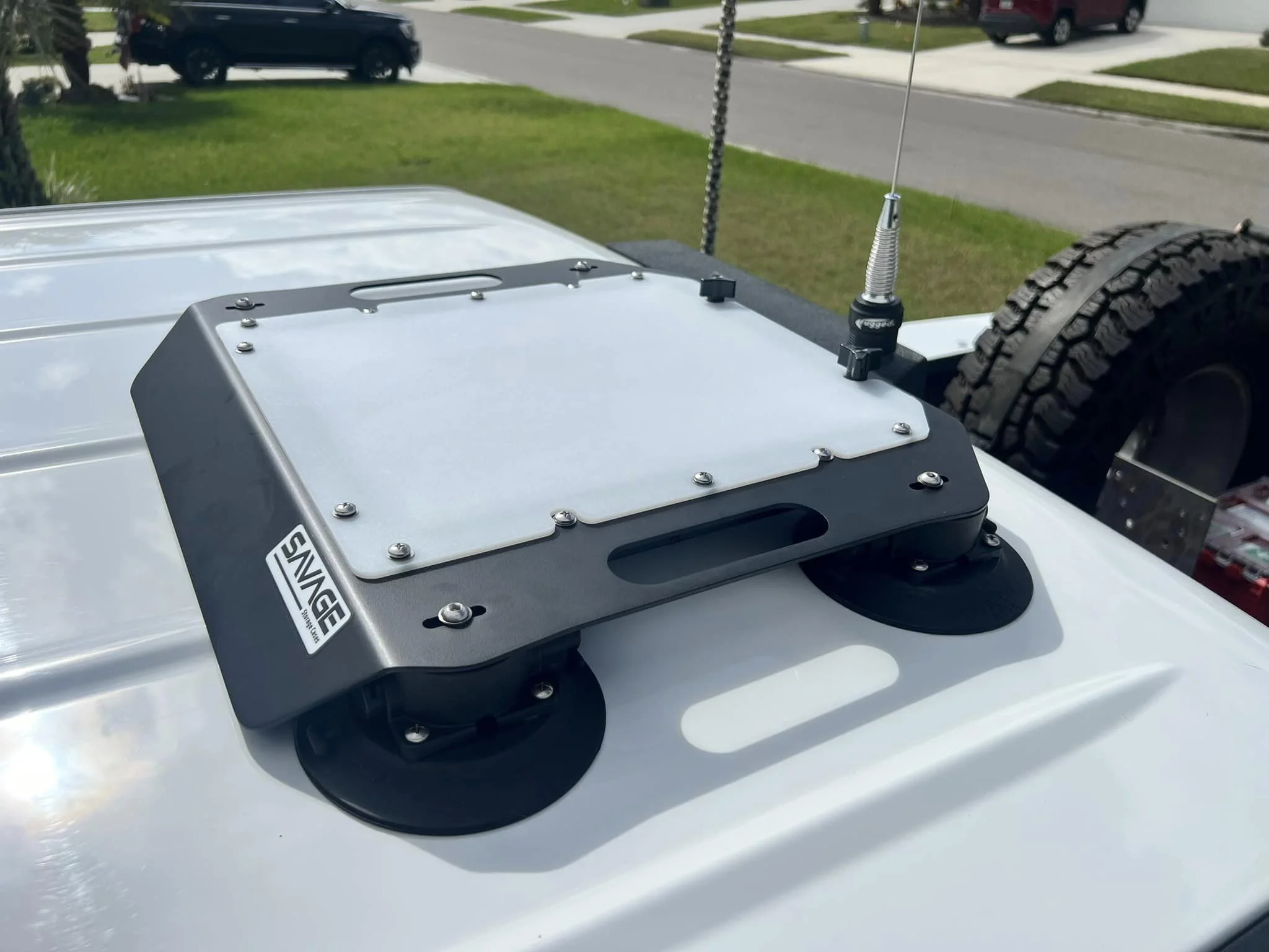

Installing my Mini in a Savage roof mount [Starlink Mini Rooftop Mount, Permanent Mounting Options - https://www.savageutv.com/collections/starlink-mini-products/products/mini-rooftop-mount?variant=41146716291115] as soon as the mount arrives.

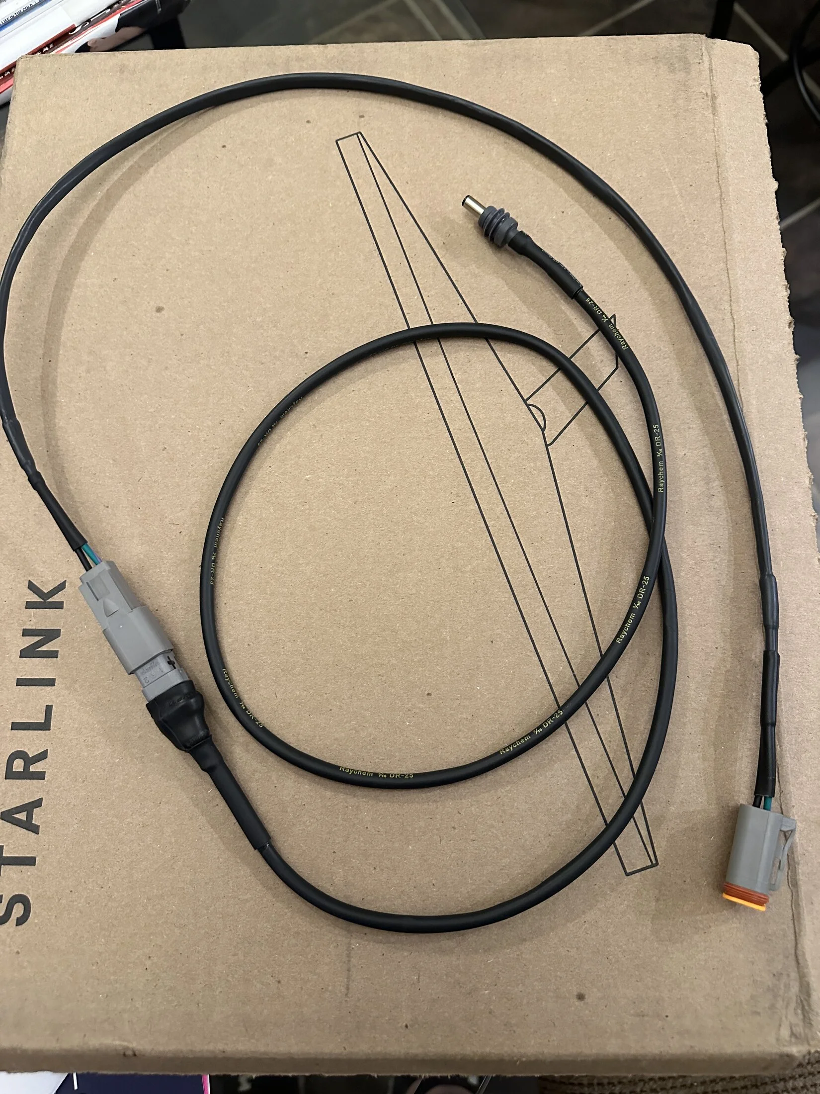

Made custom StarLink power extension feeding to a DT-2 connector, to minimize the run of voltage dropping 18 g wire used in the OEM cable and temporary bootlegged mount. Averaging 22 watts with 40 watt peak on a 12 VDC vehicle system supply, running about 12.6 volts off battery and 13.8 with engine running. I read that the only reason for tilt setup is for snow and rain runoff, however in the Savage mount a piece of HDPE will be protecting the antenna surface.
