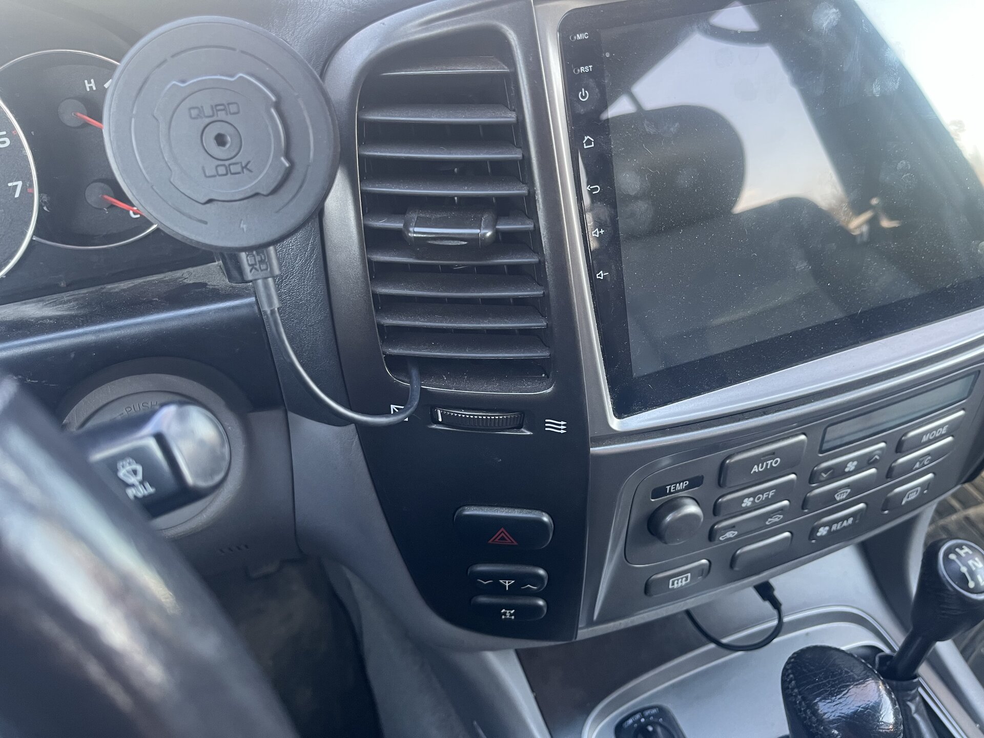

I got sick of having my phone in a cupholder or the phone slot for the 3D printed cupholder replacement...more sick of it being upside down when charging. I bought two of these based on your posts, they work great. My car has horizontal vent slats and the LX, obviously vertical, this Vicseed works great for both.

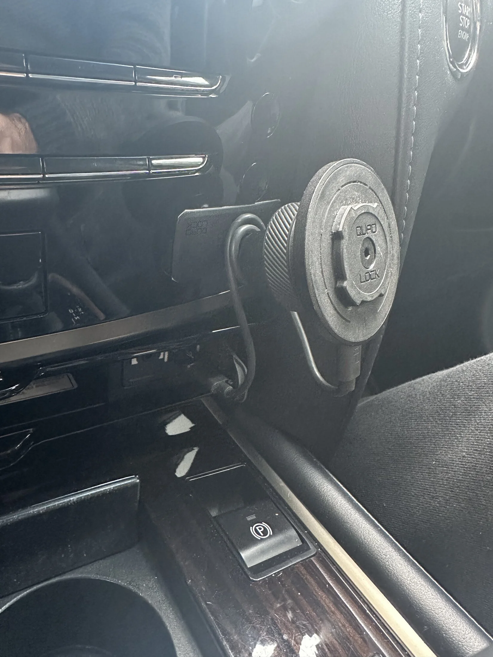

Another vote for the Quad Lock, I have mine down near my knee, out of the way. Wireless charge / magnetic attachment, and the USB connection is right there for the 2016 LX570! Neat and super functional.

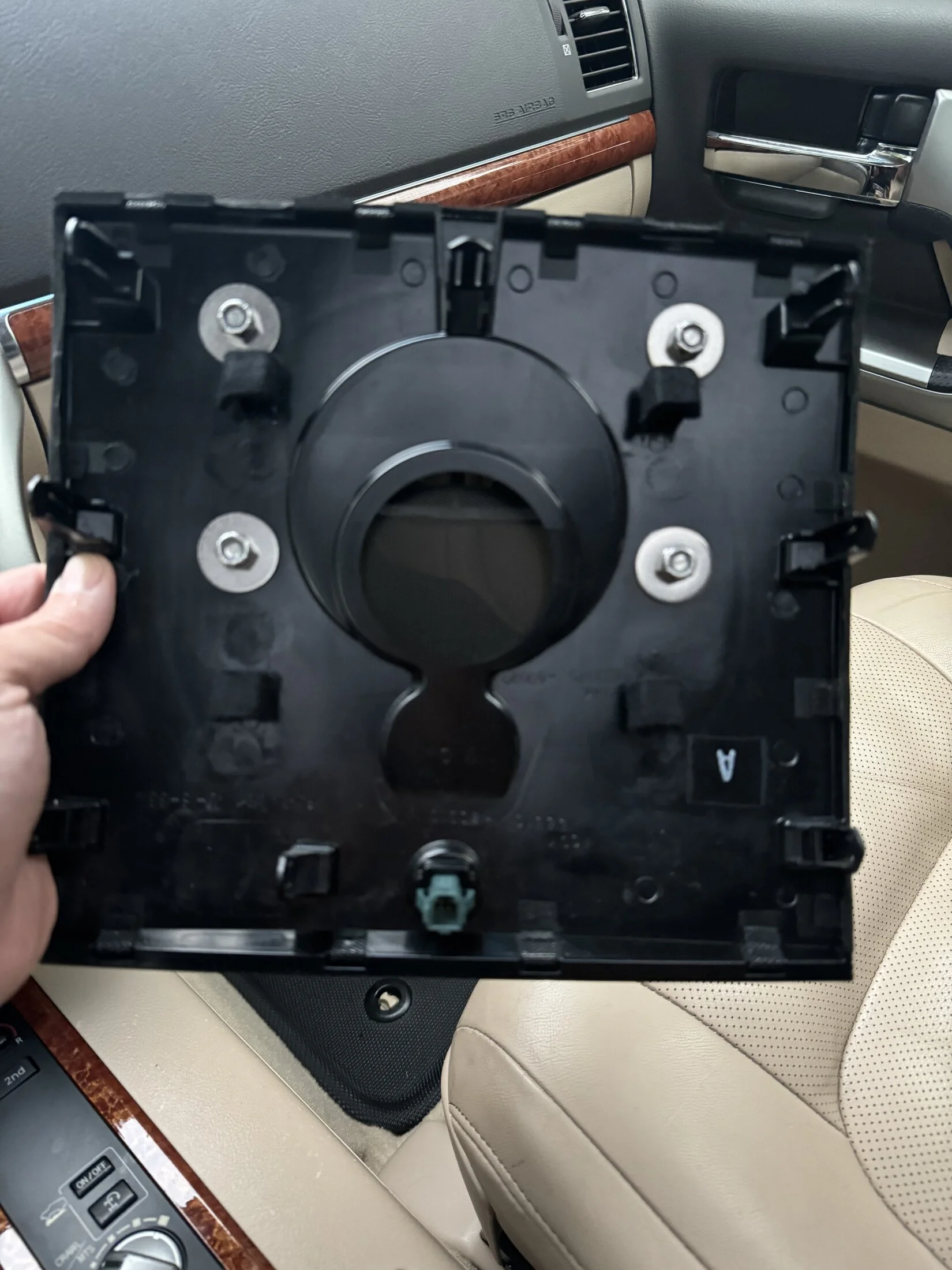

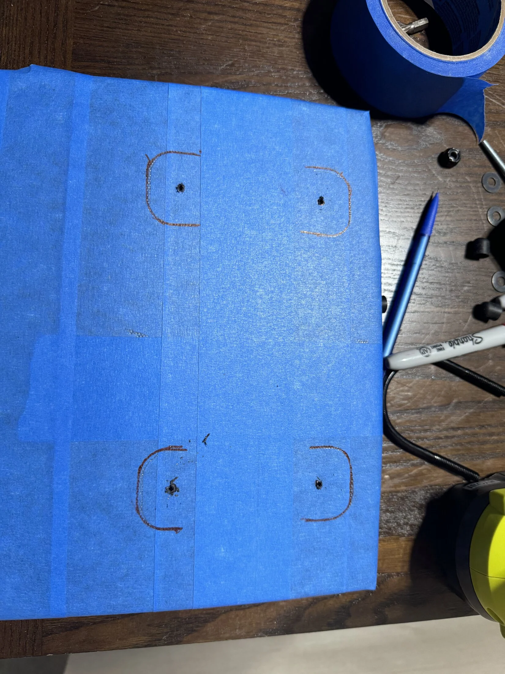

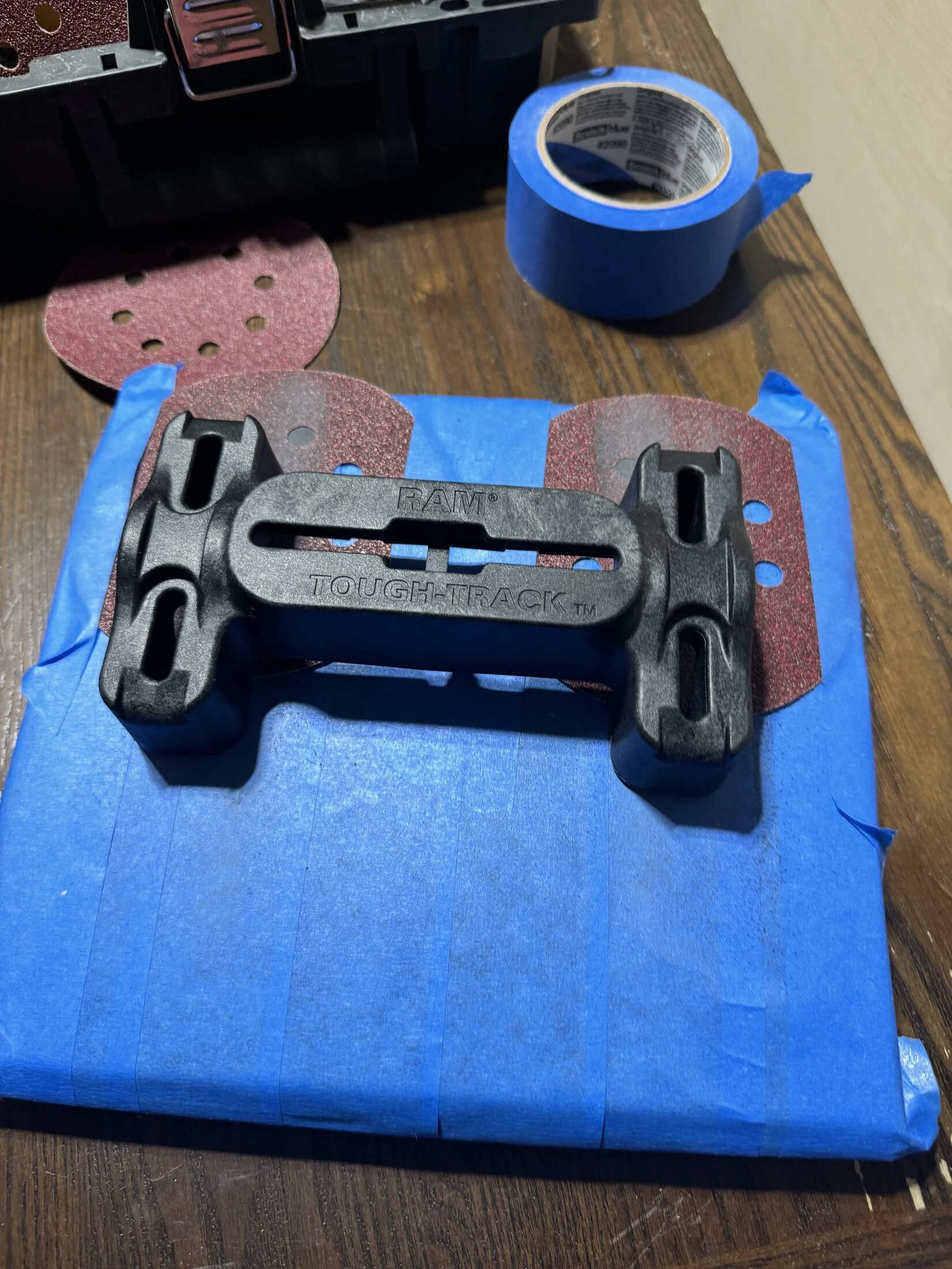

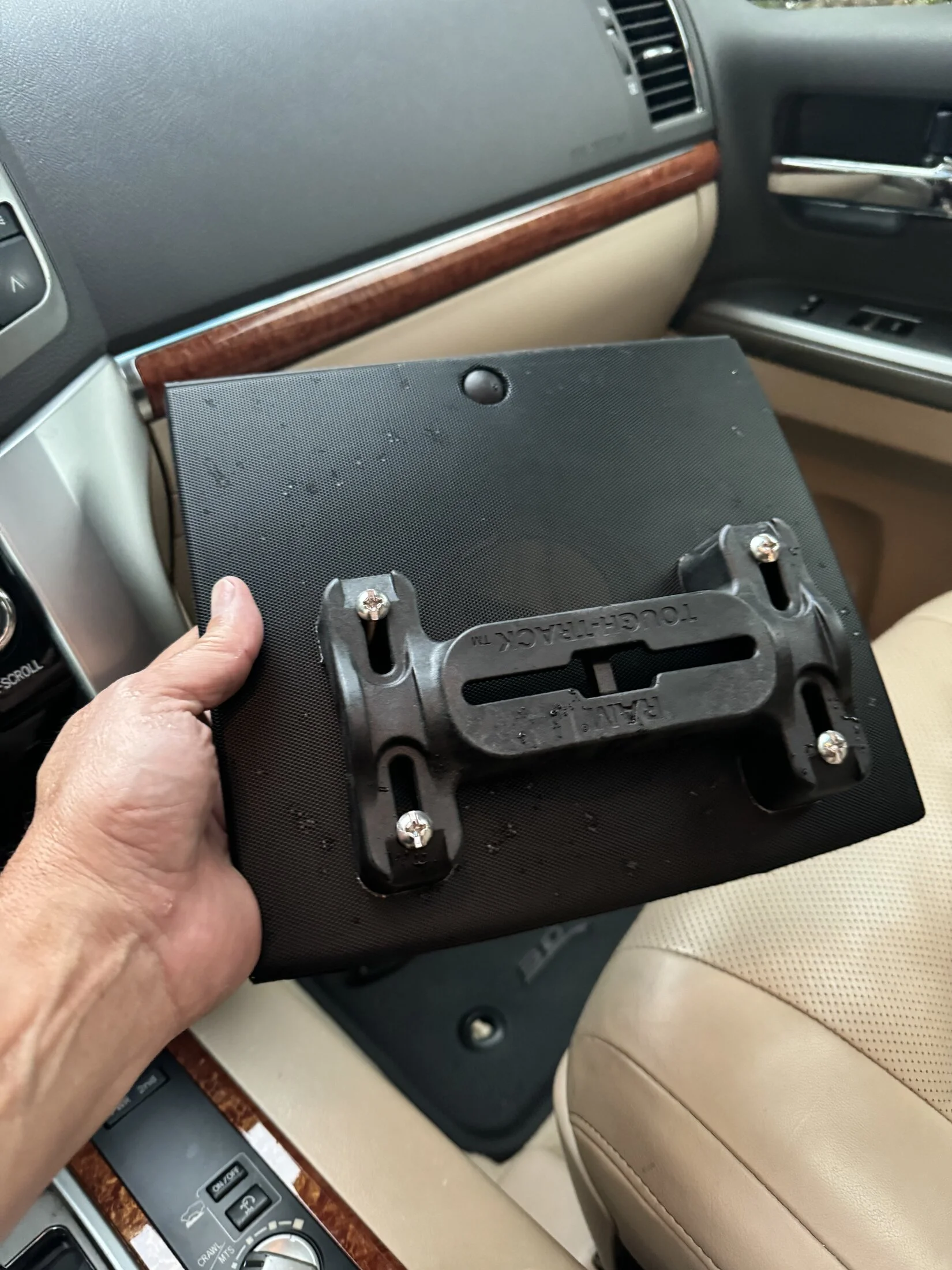

My first contribution! Took some suggestions from the forum. I wanted something that looked like it belonged to the vehicle. Something that fit but looked robust. I purchased a RAM® TOUGH-TRACK™ - 7" TRACK FOR 1 3/4" - 2" RAILS - RAP-TRACK-B7HU. The base is made out a hard plastic. I removed the dash speaker grill, covered it in tape and taped 60 grit sand disc in it. Then ground the base down until it followed the contour of the grill. Centered the mount and measured 3/4” from the edge of the grill. Drilled 1/4” holes, but first drilled small pilot holes and slow drill speed. Bought 1/4” diameter bolts 1 3/4” long, and 1” diameter washers and locking nuts, chose stainless steel just because. The holes were drilled as near to each edge of the stain the base. Then righted them. Fits perfectly and seems solid.
One thing I noticed w the magnetic phone holder, is it latched on pretty decent to the speaker grill. Seriously thought about using it as the mount but by the time I added some padding to it, think it would have weakened its connection to the grill. But, could be a good option for someone to consider.
One thing I noticed w the magnetic phone holder, is it latched on pretty decent to the speaker grill. Seriously thought about using it as the mount but by the time I added some padding to it, think it would have weakened its connection to the grill. But, could be a good option for someone to consider. View attachment 3713939View attachment 3713944View attachment 3713947View attachment 3713948View attachment 3713950
