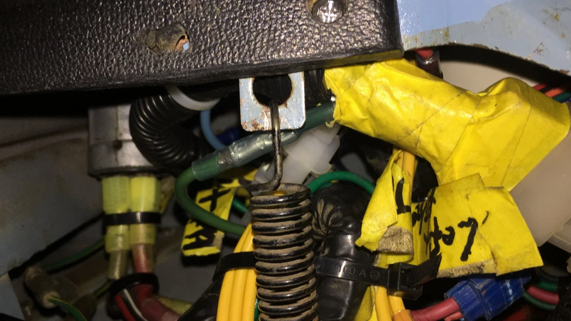

I ended up playing with the wires at the ignition switch behind the dash...
At first, a little jiggling and the stall (reproduced the symptom). I pushed the connectors on the back the switch and jiggling the wires stopped reproducing the stall.
Now I need to drive it around to see if this solves the problem.
Btw. Taking pictures under there is now easy- dark and blurry.
That spring is for the clutch. Seems to jiggle the wires a bit. That area is full of spaghetti. Sometime I just want to totally start over with wiring.
